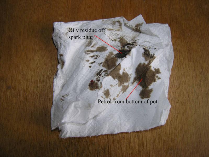

Hello John,
Thought I'd post these images to help with diagnostics, in case I'm not explaining properly.
The 1st image is of the pot. Although the liquid isn't visible it gives a hint of what I mean.
I drew fuel with a straw from the well and this is the colour, also there was an oily residue on the new spark plug.

CAR GOING :D and it takes some believing how it come about.
Mate of mine called to give me a tow. But before he got the rope out of his car he said, "I been told to try something that is supposed to reset the sensors, give me the key". He got in the car and turned the key FIVE TIMES on and off and on the SIXTH he turned the engine. It coughed and spluttered but started, soon settled down and started running smoothly. It's like one of those; Stranger than fiction tales.

So - after all that it seems to be a case of extreme flooding after all.
I've no idea about your friends trick...this is the sort of thing we do to initialize a new key to the cars ECU, but no matter, its going now.
Post back in the morning with any news...when (not if) the car starts, its obviously wise to keep it going for a minute or so.
Another known issue with the K11 is the throttle body...a firm called BBA reman know all about these - it may be worth a look at their website to see if this is a recognised problem.
