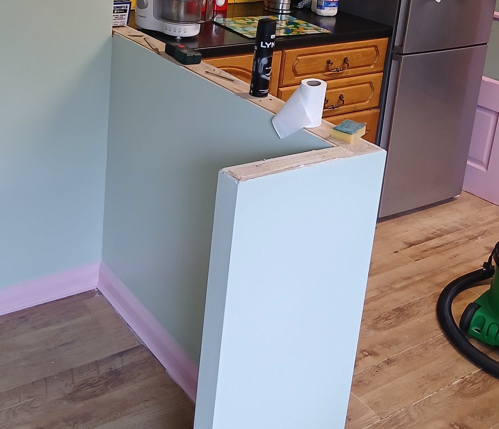

Hello all. I'm new here and need some advice please.
I am installing a breakfast bar counter.. made from scaffold boards.. varnished etc.
I can get to one end only to fix down with actual fixings.. the other end I cannot get to the underside and don't really want to drill and plug it if possible.
Can I use a grab / bonding adhesive product of some kind to do the job of fixings?
It's there a grab adhesive anybody can recommend please?
Or am I asking to much of it ?
Daniel
There will be an added support on the wall.. top left of pic... and i can get access to the underside around the corner out of sight in the pic to let
I'm fitting a wooden breakfast bar counter on to the framed wall in the pic.. and I'm asking for advice on fixing it with a adhesive as I can't get access from below for actual fixings and don't want to drill screw and plug it if possible.
Just wanted to know if a bonding adhesive would do the job.

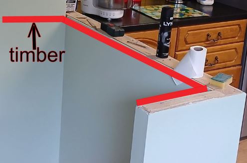

Run a timber around the inside of the wall and screw through into the worktop from underneath.Pre drill the timber to make it easier to fix worktop.
Not obvious why you can’t access from below?
Ok.. didn't even cross my mind to do that.. just had my mind on the frame inside the wall.
I guess you wouldn't be able to see the timber either.
Just out of interest.. do you think the grab adhesive would work though?
Is that stuff strong enough for the job?
Thank you.
If the batten on the left is well screwed to the wall then construction adhesive would hold it down to the wall top. I wouldn't want to rely on adhesive alone for the batten
If you wanted the support to be less visible then a length of steel angle would do you.

Not by the time your scaff boards have finished drying out and warped some, no. You'll only find out at some party where your sizeable cousin leans on the counter, on the same side as 50 poured glasses of wine, and 4 pans of chili, and then there will be a cleanup job and a half
