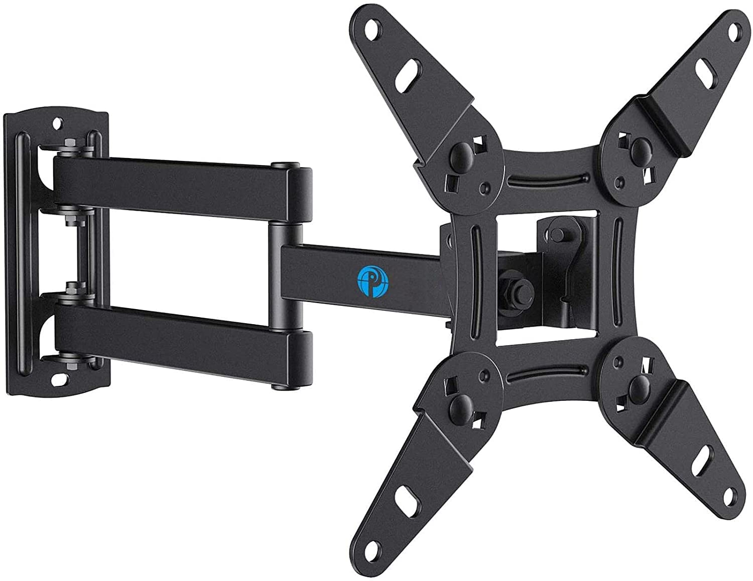

RE: Multiple screws in the same brick, that is a valid concern, which makes me wonder why commercial bars i'm seeing have the screws all close together. Wouldn't it be better, in that case, to have some kind of mounting plate, like is used for TVs, to spread the load over a larger area of wall?
The wall bracket in your image probably only has two wall fixings.
The part that connects to the TV seems to be one of the VESA standards- of the 8 holes, it is expected that 4 will be the correct VESA standard.

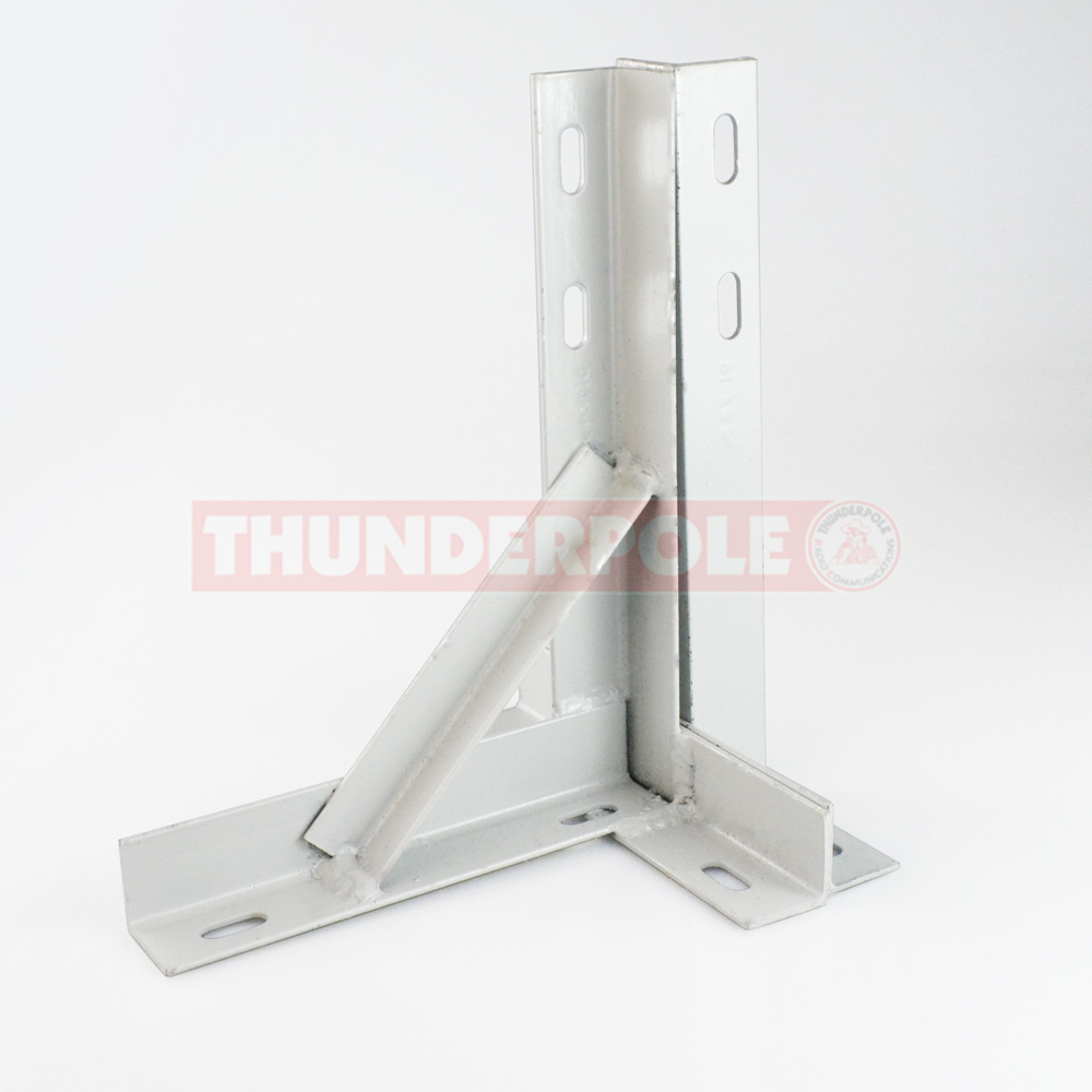

I think i'd ideally like to find, or make, a grab bar that connects to the wall like this, with arms that spread out from the contact point to put screws in that spread load over a wide area
i cant seem to find anything like this, they all concentrate them in little circles
I get your point about screws being concentrated in a small area.
