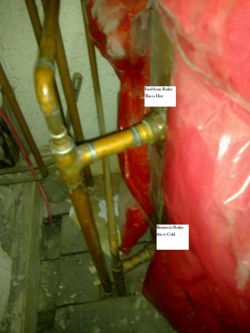

Boiler works fine Central Heating and Rads working as they should.
Pipe up to the coil in the hot water tank is hot but cold on the return out.
I have worked out there is probably air in the coil stopping the flow but how do I bleed it.
Boiler is in the basement Hot water tank is on the second floor below its cold fill tank. Above that in the loft space is a small header tank I assume for the CH.

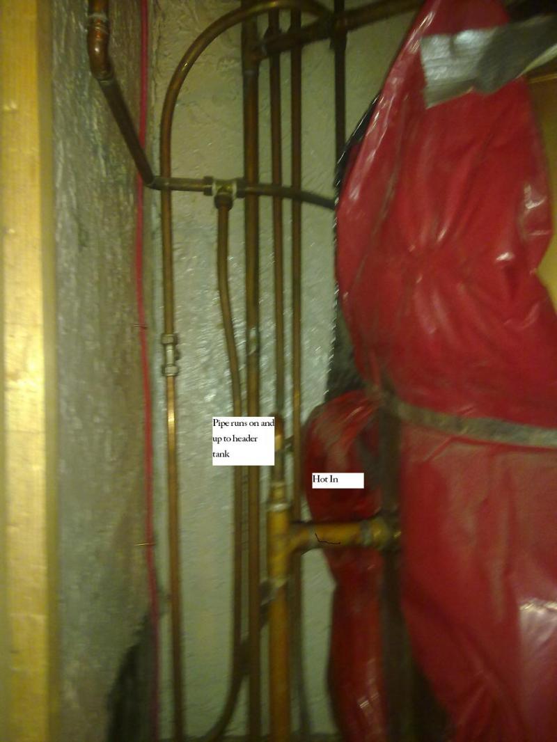

Should add I have followed the pipes on from the boiler above the hot tank and cold fill tank to where they meet the header tank expecting to find a bleed valve but there is nothing.
I am missing something obvious here and clearly it is a very simple job to bleed to air lock if only I can find out where.

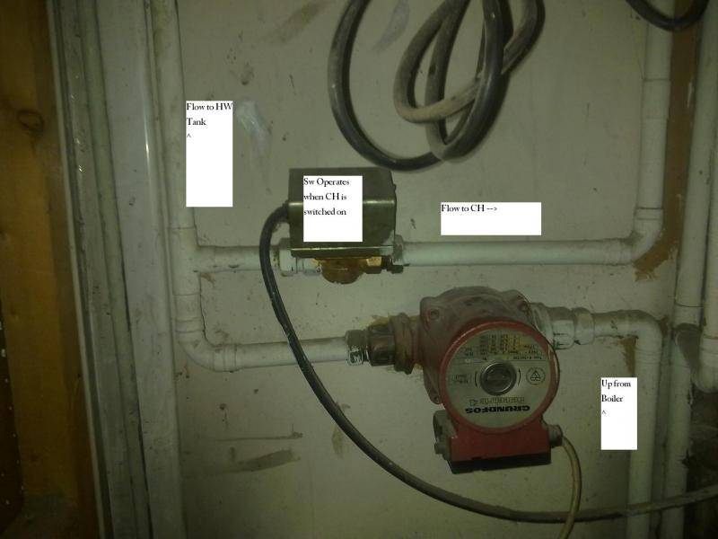

The pump is in the same cupboard as the boiler which is in the basement, there are no others. Whole system is circa 1980 and the boiler is a Glowworm 85-100.
I would say Gravity HW Down and pumped CH although of course the same pump pushes the hot water up to the tank to heat the coil.
Not quite sure what you mean there... Its likely to be either 'fully pumped' where the flow splits after the pump either by way of a 3 port valve or 2x2 port valves to feed CH and HW circuits, or gravity HW, where the HW circuit relies on gravity circulation from the boiler, using 28mm pipes, (no pump), and the CH alone is pumped.
Do you have anything like shown in the pic Kev posted?
There is a boxed switch of some description just after the pump. When I switch on the CH the switch operates and the pipe run after it gets hot.
Ok, sounds like the motorised valve on the CH circuit, which I believe is working ok from your original post. Is there another of these 'boxes' you can see, or does the pipework Tee off after the pump but before the Motorised valve?? If you could post a pic of your setup it would help us understand the layout of your system a bit better.
Thanks. When the pipe reaches the cylinder does it go straight in, or is there any other pipes coming off it? If you could do a pic of the cylinder showing pipework arrangement on primary side that would be great.
Superb, thankyou. The pipe rising from the cylinder primary flow to above the tank is a vent, this should allow the air to escape as the system is refilled, therefore no need for a bleed valve. I would think there may be a blockage in the return at the bottom of the cylinder, stopping the circulation through the coil. The pipe gets hot as far as the cylinder, could you switch the heating off and see if water is emerging from the vent over the feed and expansion (smaller) cistern in the loft.
I was up there earlier this afternoon and there was no water flowing into it. I did trace one of the upwards pipes which acted as a vent hung over the tank like an overflow.
