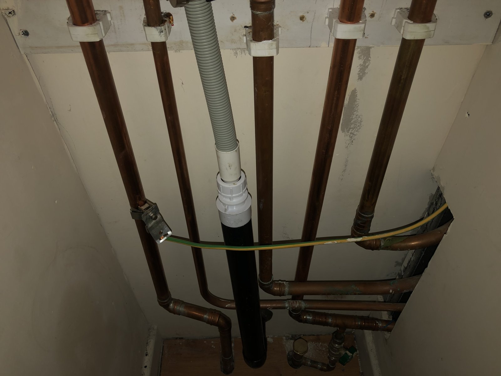

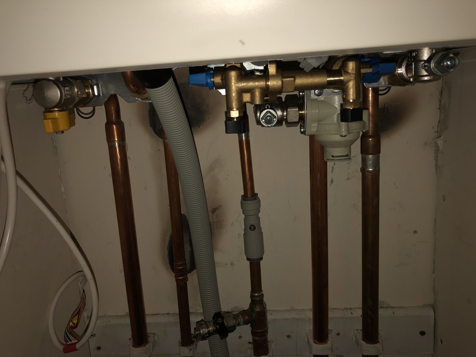

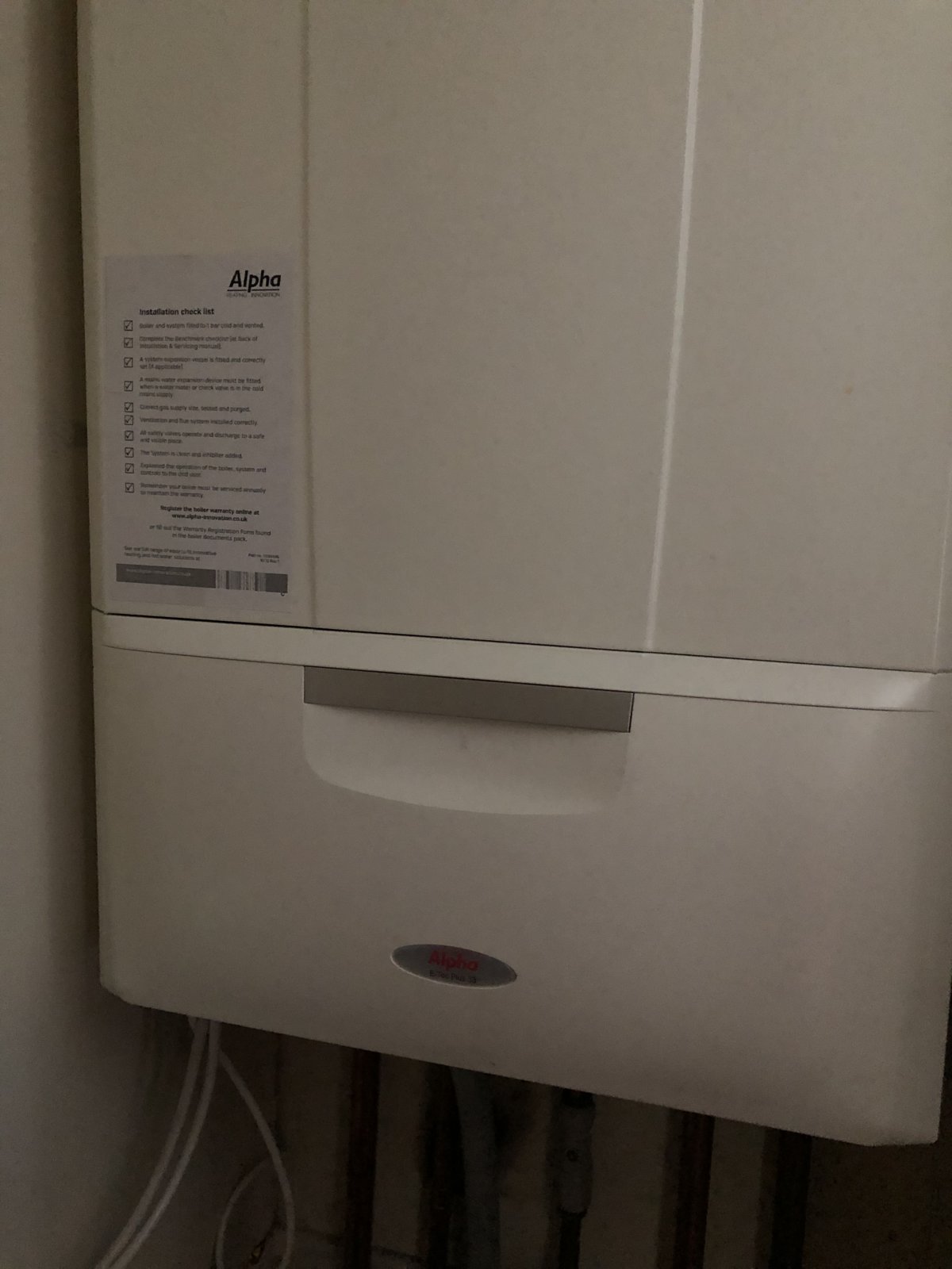

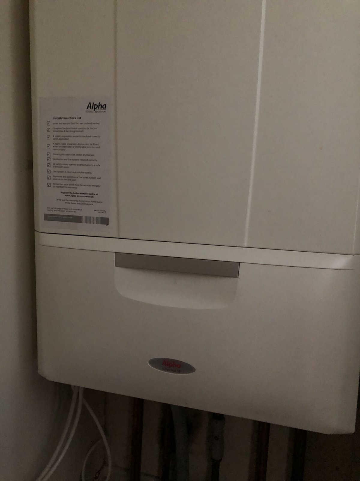

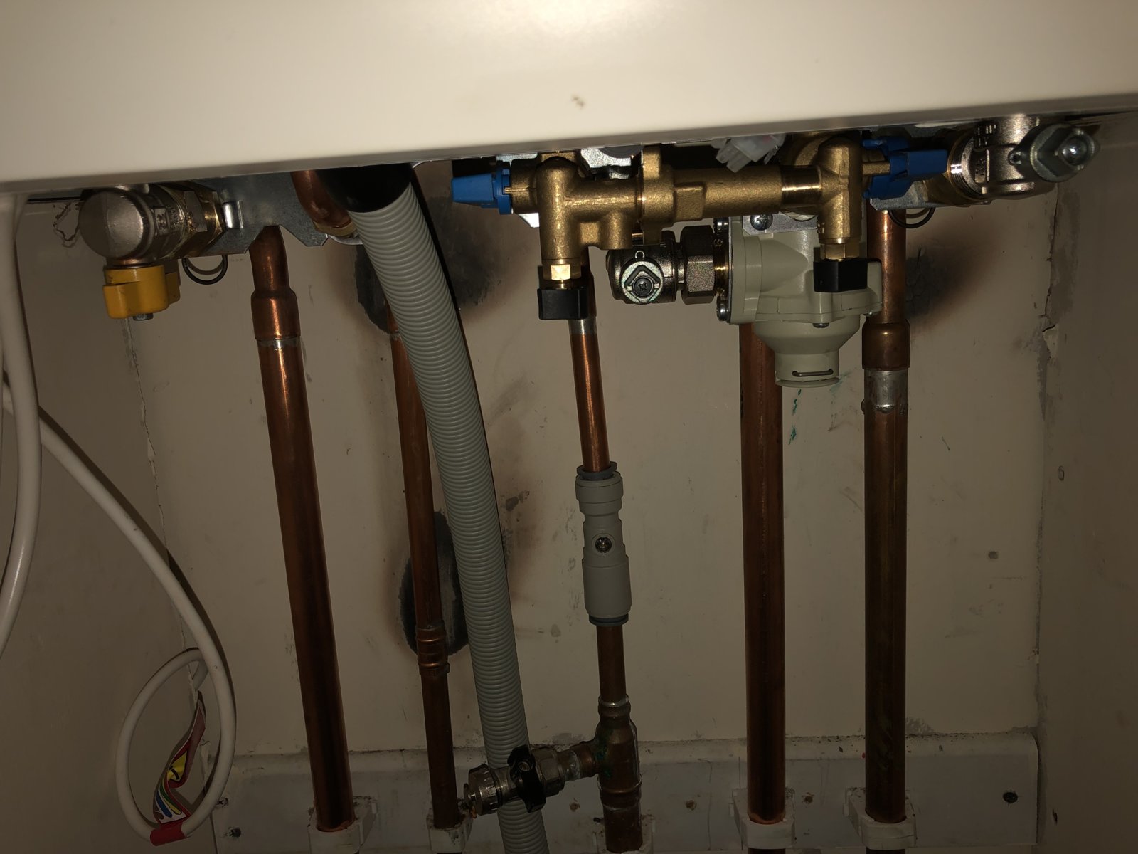

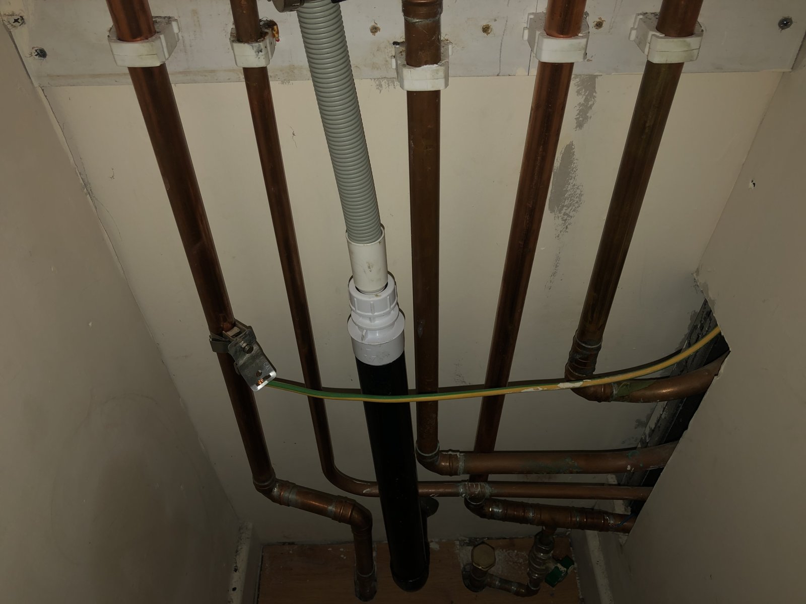

Post a few pics of the boiler and pipework underneath.
The previous was a Combi Boiler too.
Here’s some photos of the boiler and pipework underneath.
One of my colleague had mentioned that it might be an issue with the diverter valve so I’ve mentioned to the installer, and he said it can’t be that and “it MUST be the pipework size!”

I very much doubt that it has anything to do with the size of the Gas pipe, as already said if it was the Alpha engineer would have issued you with a notice and would have told you about it, the boiler uses exactly the same amount of gas when lighting for CH or HW
