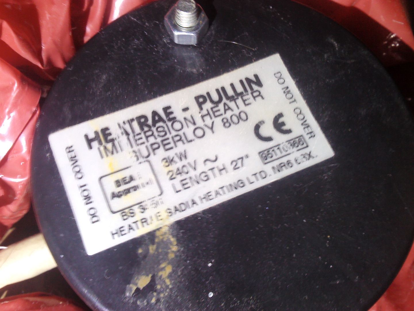

This is the immersion heater.

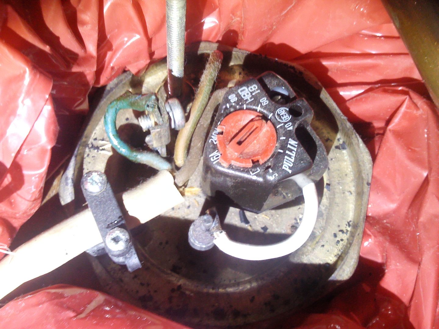

Definitely think the RDT mounted on the cylinder element needs replacing because when switched on and set to 50° you can hear it boiling if left on. Thought it should automatically switch off.

If the immersion is boiling the water in the cylinder it needs replacing ASAP! The thermostat should switch it off when set temperature is reached. Under fault conditions it has been known for an immersion to boil the contents of the cylinder, which in turn has boiled the contents of the cold storage cistern above which feeds the cylinder. These cistern's are often plastic, which can deform with the heat, dumping gallons of boiling water through the ceiling. There has been at least one fatality as a result of this, a young baby in a cot.

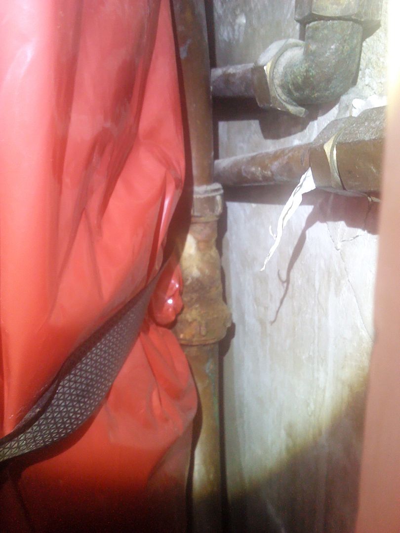

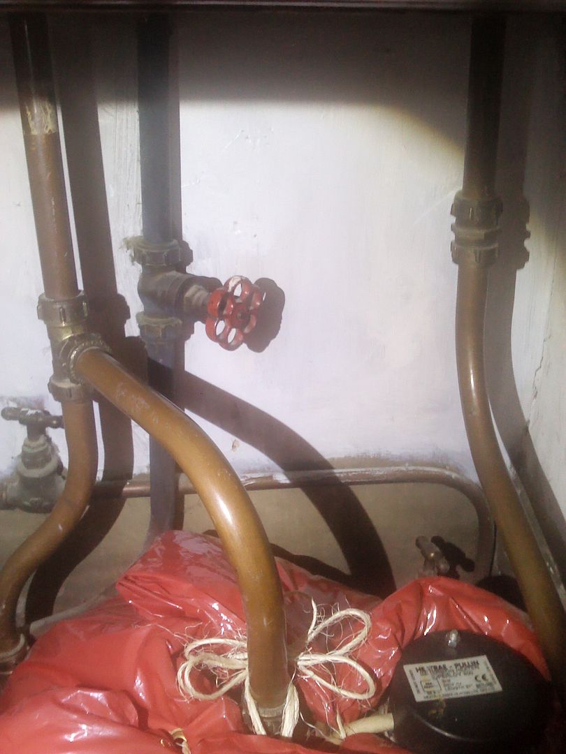

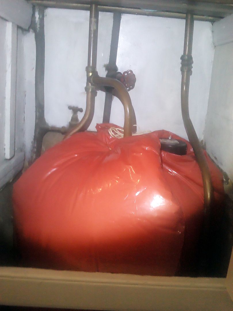

Can you put up some pictures of the primary connections to the side of the cylinder, will be two pipes, one at the bottom and another above it, preferably showing where they go and any other pipes connected. May be clearer if the lagging is removed first. If you have a gravity circuit on the HW the vent should rise from the flow connection to the cylinder, therefore no air should be trapped in the coil. :?

Thanks, didn't even think that could happen. Gonna change the RDT thermostat tomorrow.
The only photos I have are these. I can take more tomorrow. I'll take the new jacket off first though.
Primary connection halfway up cylinder.
