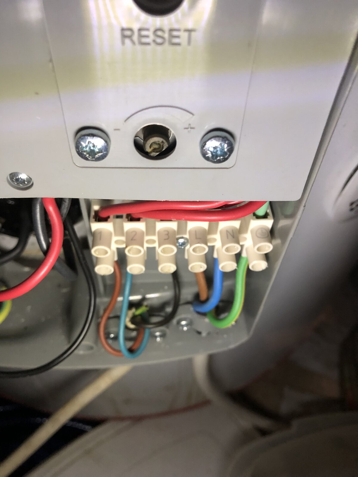

Check voltages at the hot water cylinders thermostat.

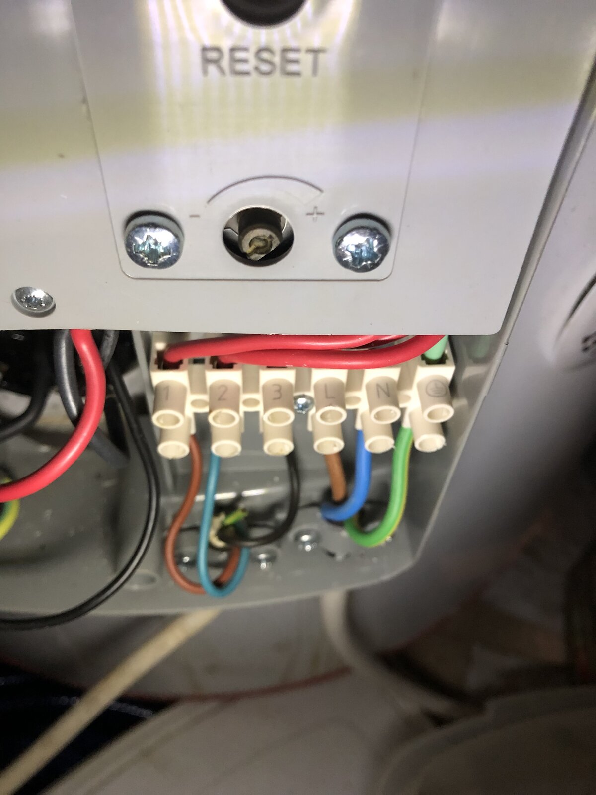

I’m reading between earth and
1 = 240v
2 = 0v
3 = 0v
The L and N go to the immersion switch.

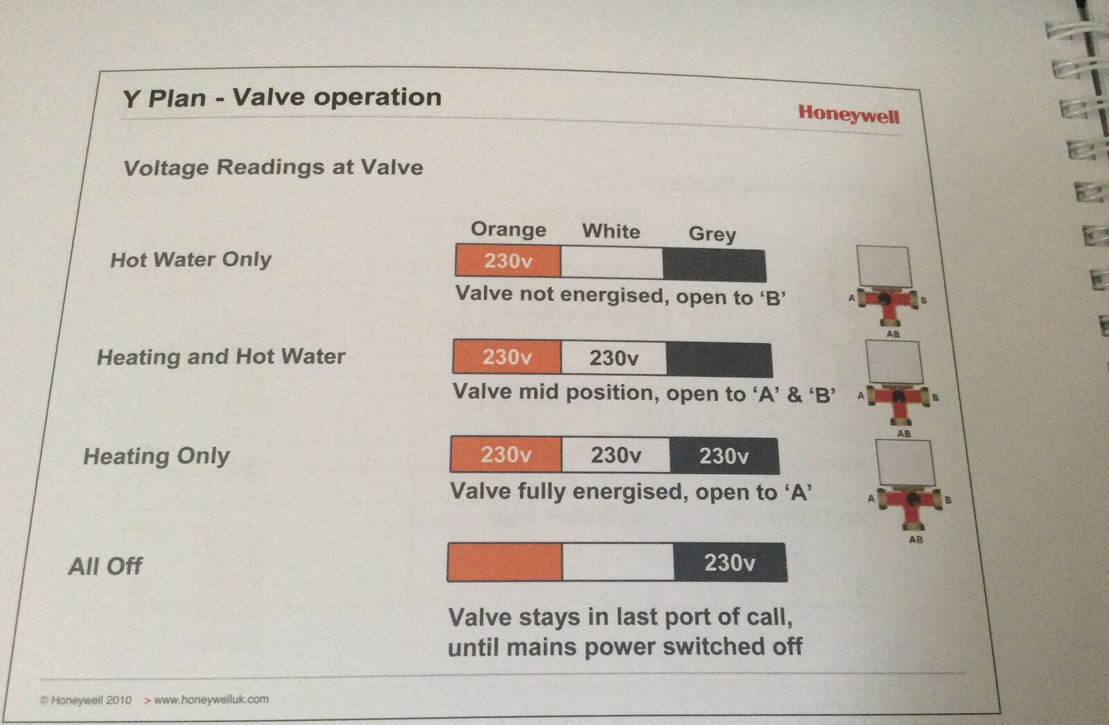

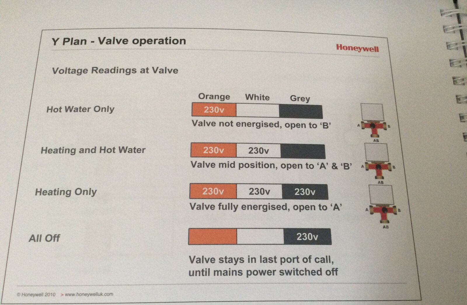

Those voltages in the 1st post don’t seem correct imo, have a look at this:

Is the cylinder full of hot water ( have you used the immersion heater to do so)?
If the cylinder stat is satisfied you should get 240v at the terminal that contains the grey wire that goes to the 3 port valve

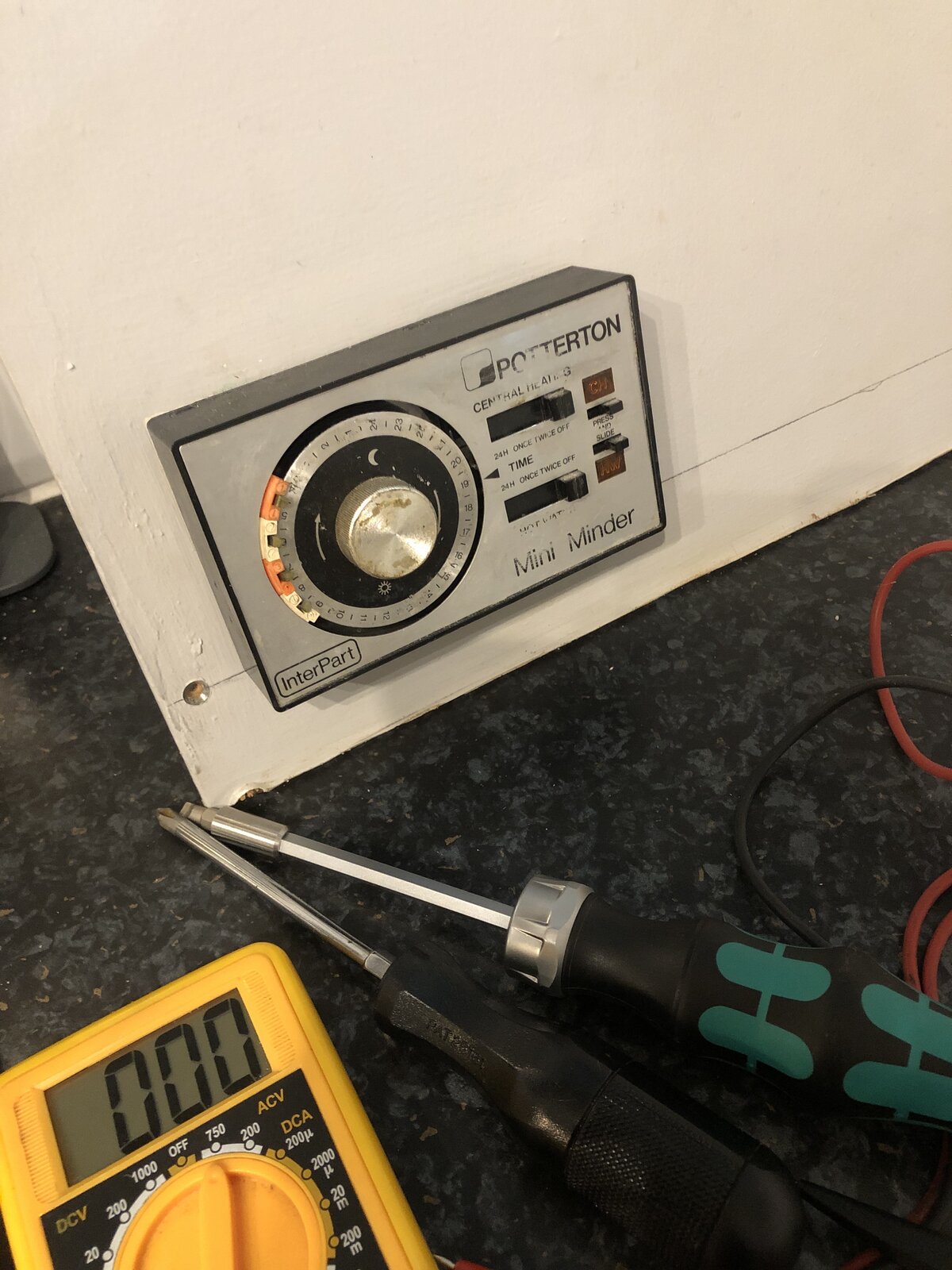

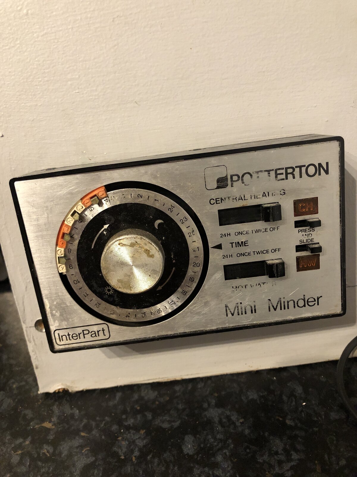

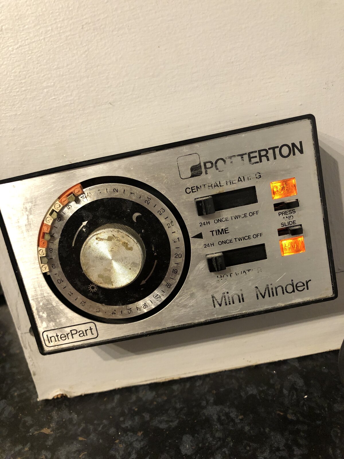

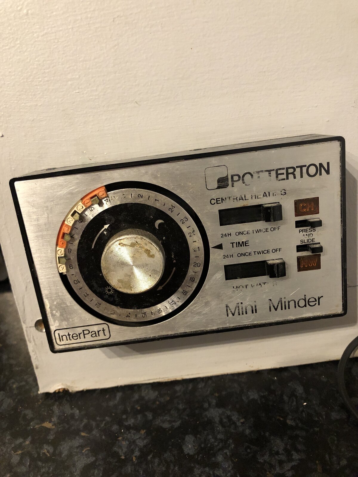

What do you mean ,you can't select central heating
only on your programmer ??
It will only allow me to slide the CH to the left if the HW is already over to the left. If the HW is off it will not allow me to turn on the heating.

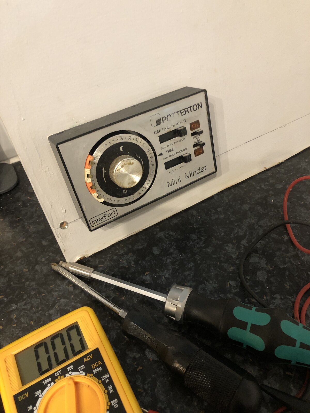

You say you have a mid position 3 port valve , so you have a fully pumped system, but your old programmer is set to Gravity, you need to remove the programmer and set it to pumped on the back then put it back on
