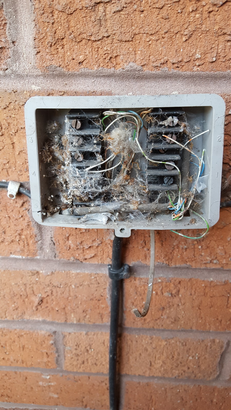

i have done some more investigation and thefe is a grey box outside the door with one black wire going into it and three coming out.
i think two go to the upler floor and one to a junction box downstairs which then spluts via white wire into two slave sockets.
now my question is, can i rewire the black wire into a more modern junction box or is connecting the black wire into something bt ' s remit?

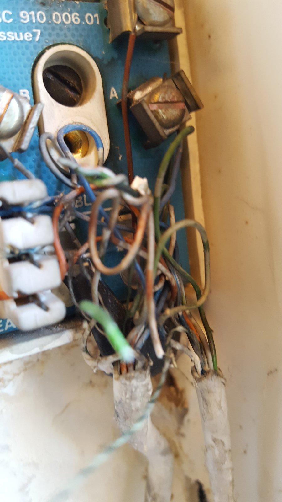

hi here are some pics of the box outside with the black wire going in and the two blacks going out to junction boxes which then connect to slave sockets.
It's still not very clear what is going on from those photos. (You could have brushed out the spider eggs!!)
The second photo is a Block Terminal 80A, not a socket like we were expecting. Although those cables under the block terminal have been painted over, you can see from the stripped end that they both have a white jacket, so these would normally be for your extensions internally.
The black cables outside could be a red herring, especially as the incoming line(up from below) looks a thicker cable which can carry 4 or 5 phone lines(AKA 4 or 5 pairs). Have you traced them to see where they actually go? One could be your neighbours, or maybe a previous tenant had a second line for a fax.
You'll probably have to get BT to swap the indoor Block Terminal over for a modern master socket. Don't worry if that isn't where you want your router, that can still go into any socket. The outside grey box will almost definitely have to stay, without spending a small fortune on starting from scratch.
