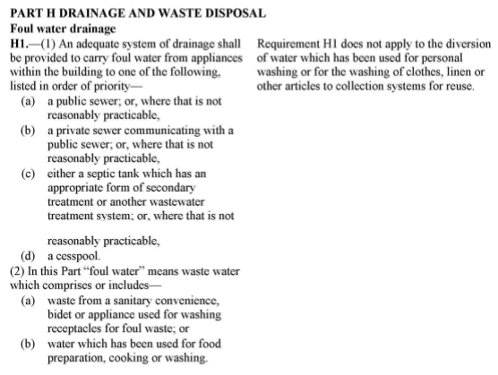

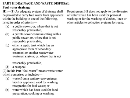

"Its isn't the building regulations", I don't quite understand that comment as it has Buiding Regulations printed on the front of it, although I do realise that they are for guidance and following them is a "deemed to comply" way of satisfying building regs requirements without have to provide an in depth explanation/calculations of why things have been done in a certain way. Having said that it appears from Diallos experience that the lack of BCOs/architects nous leads them to sanctioning/detailing drainage details that do not comply with the buildings regs, Doc H in particular?
This is Part H of the Building Regulations pertaining to foul water drainage, nothing more,
I'm not sure what parts of what has been discussed would not comply with the above.
It would seem as per post nr 2 relating to "adequate system of drainage shall be provided" not being provided
Not sure what you mean. Post #2 refers to always having provision for venting out as well as in. There is nothing wrong with that.
Which was the reply to post 1 which was saying it didn't have provision for venting out and requesting clarification on if this was required, post 2 informed the OP that it did not comply with regs re "adequate system of drainage shall be provided".
