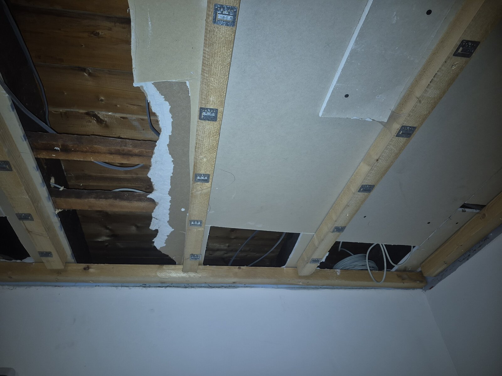

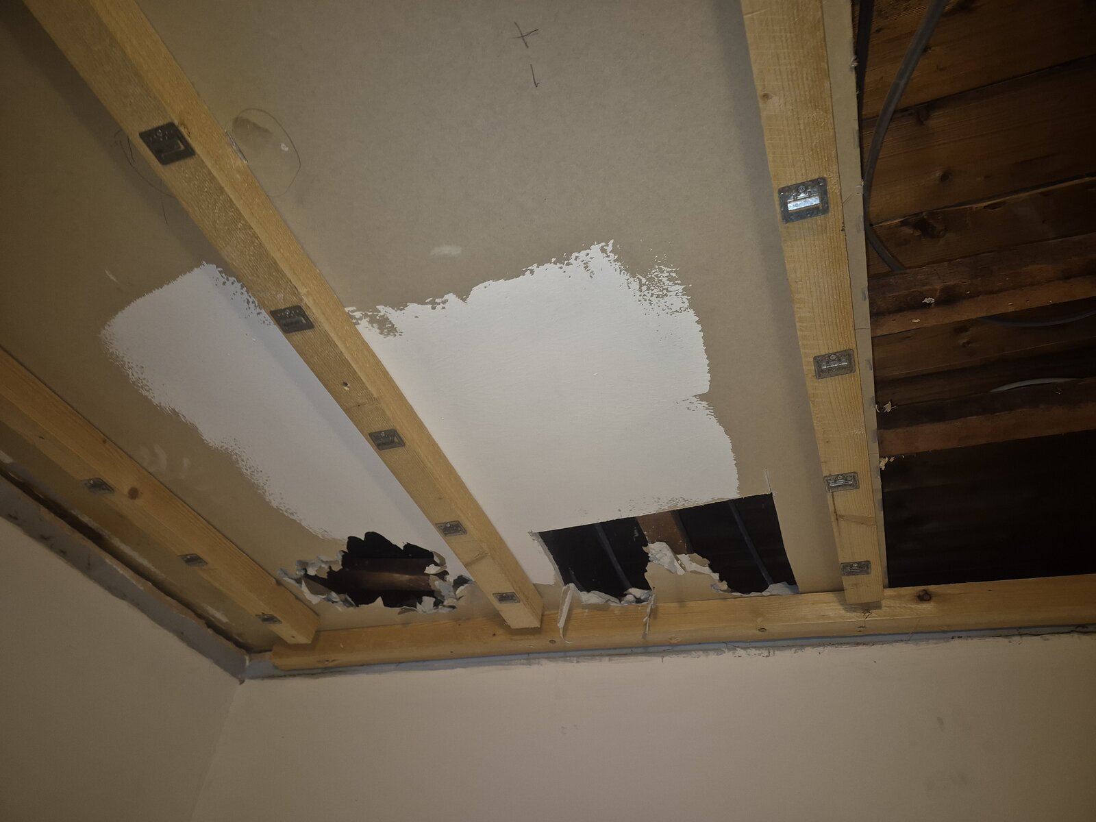

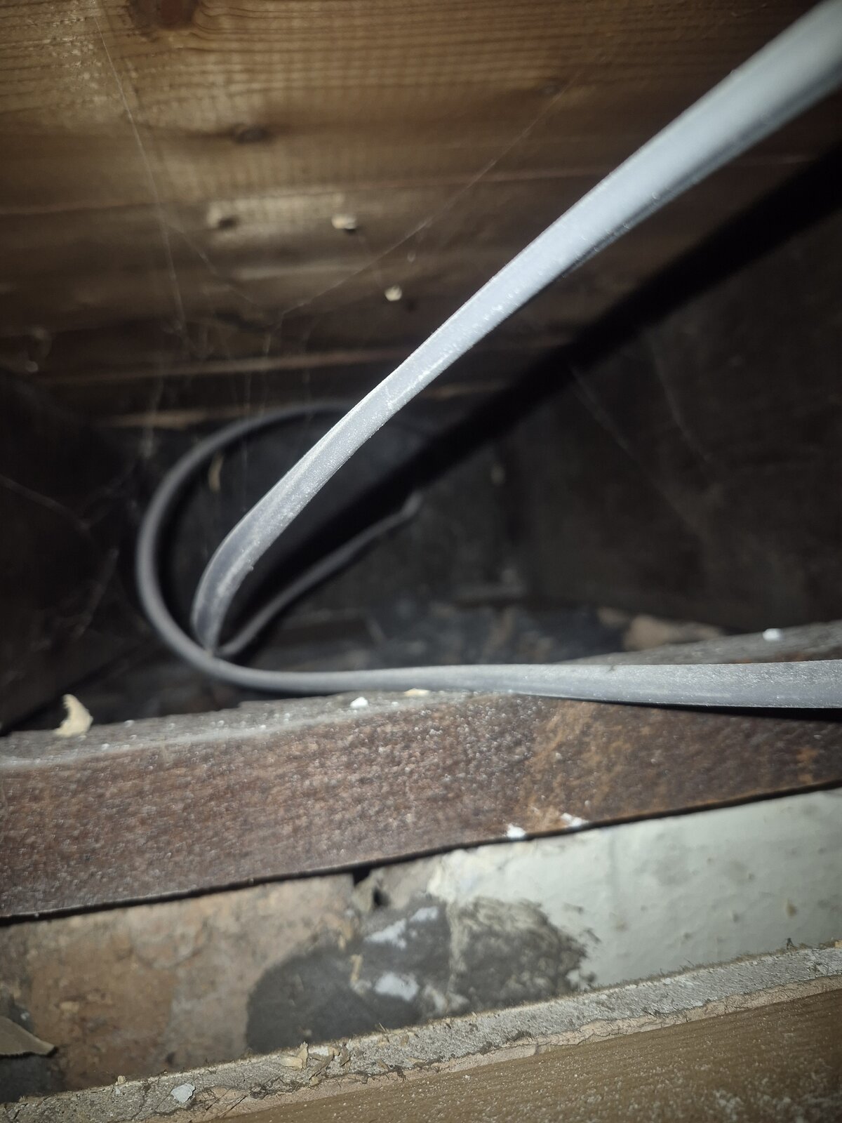

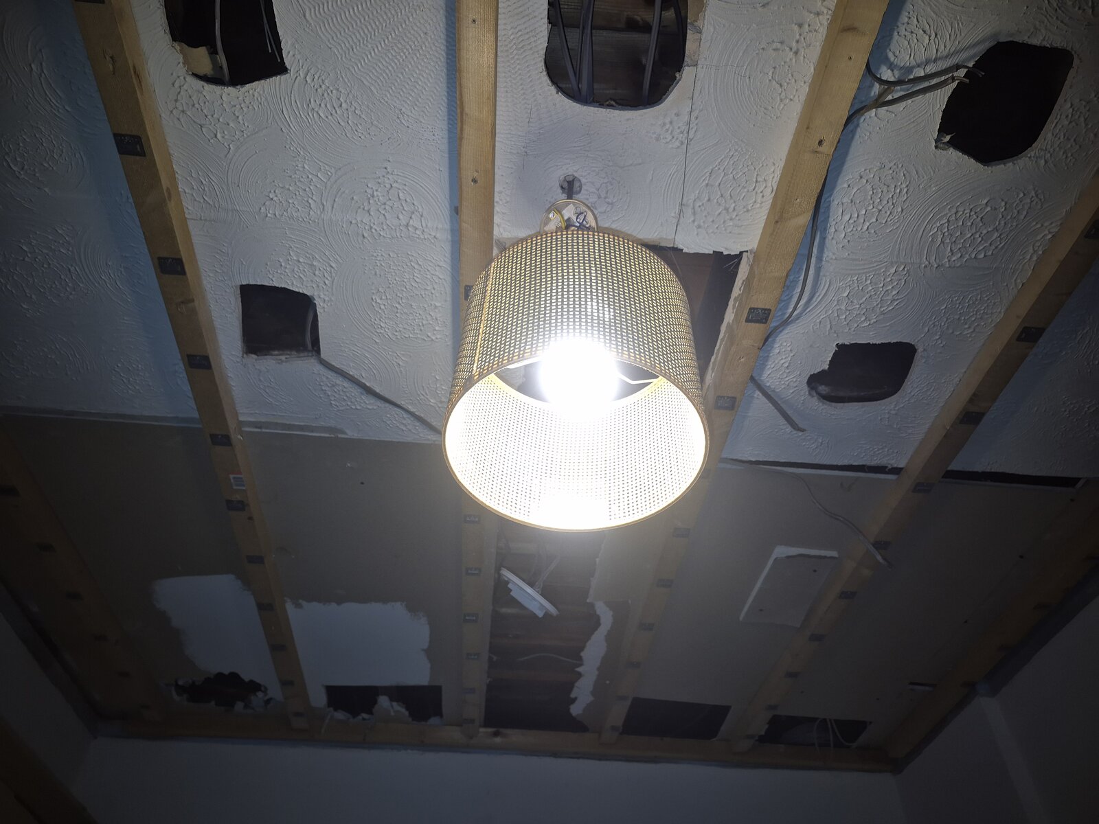

We have now removed the false ceiling and can now see the real damaged ceiling.

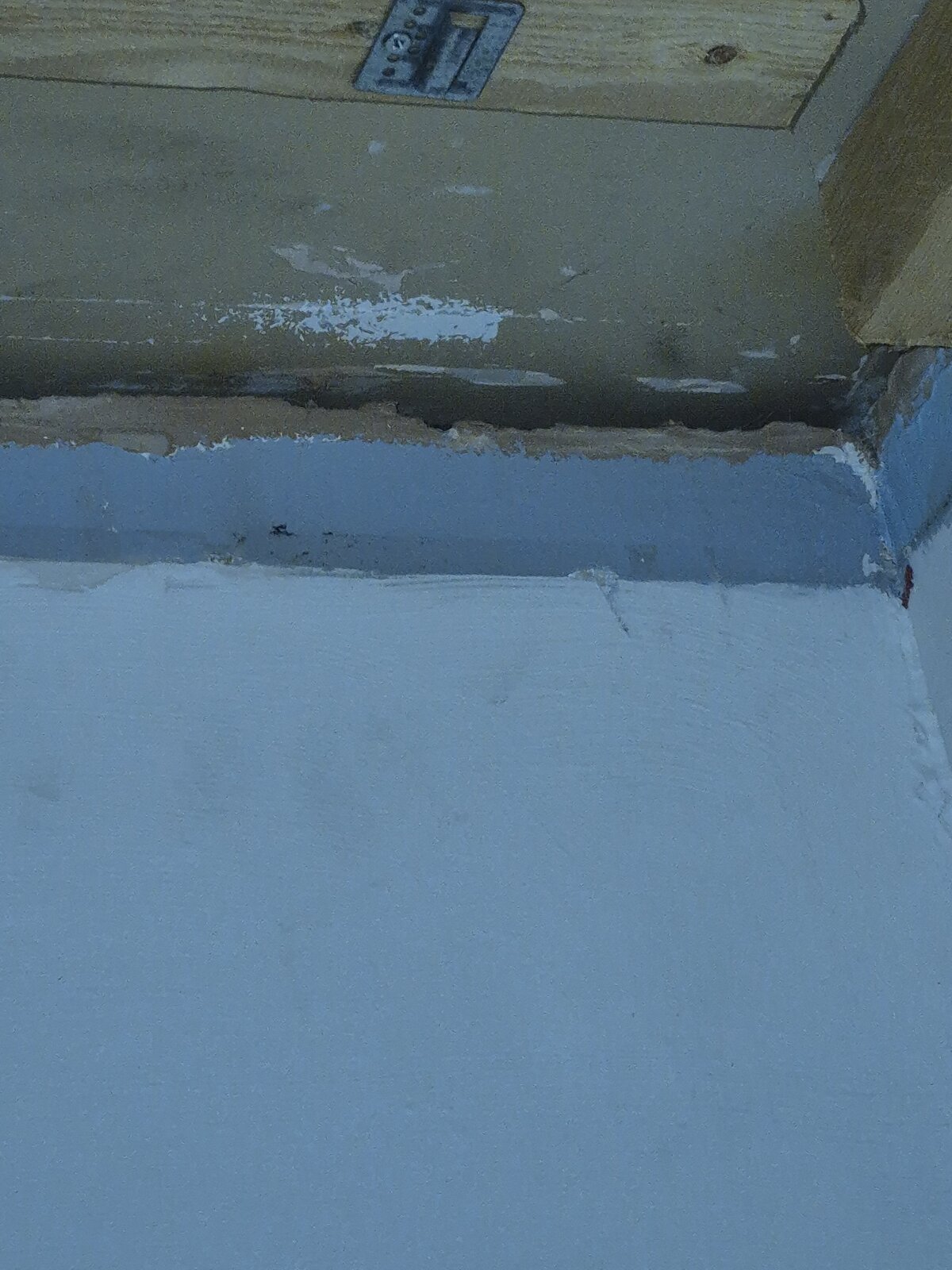

My neighbour has offered to fill the gaps in in the corner area where the ceiling meets the wall where he thinks the cooking odors are escaping into his bedroom.
he has offered to fill those areas today (Wednesday) with insulation, plaster boards and expanding foam to hold plaster board in place.

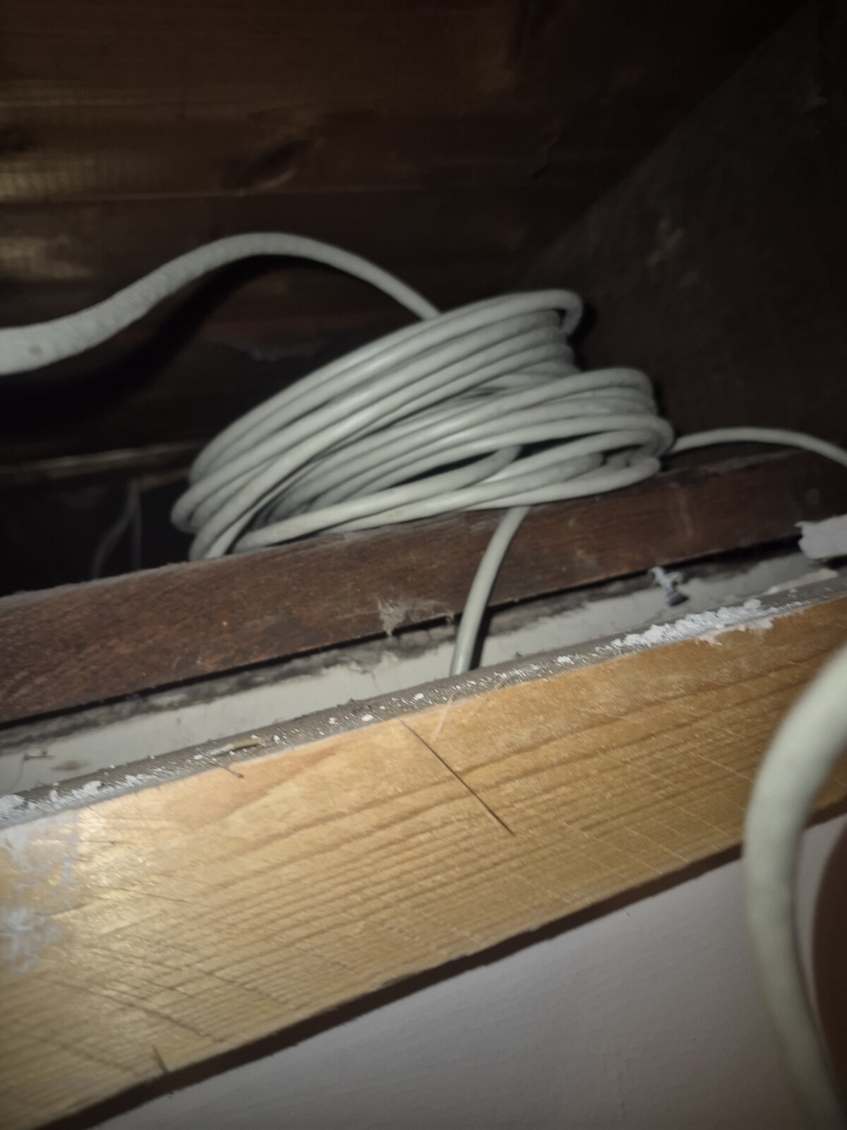

however I am worried about the electrical cables running through and directly touching the expanding foam and the insulation as I have read the below.
"While expanding foam can be useful for insulation and sealing, it's generally not recommended to use it directly around electrical cables or wires, as it can trap heat and potentially lead to overheating and damage."
And
"Electrical cables generate heat during operation, and insulation can hinder their ability to dissipate this heat, potentially leading to overheating."
Also what material is best to use to fill this gap between ceiling and wall? Expanding foam or just a regular filler? Ie last photo
Any advice appreciated thanks.

Some of that wiring is probably redundant, from old down-lighters. Remove that and see what’s left. You don’t really want wires embedded in expanding foam. The basic idea of patching the holes with plasterboard seems reasonable to me. I’d probably use a “sticks like” adhesive rather than sticky foam. Plus a couple of screws.
The gap in the last picture could probably be foamed if it doesn’t have wires in it.
I don’t understand the horizontal route to his house yet, i.e. the lack of party wall. Can we see that in the pictures?

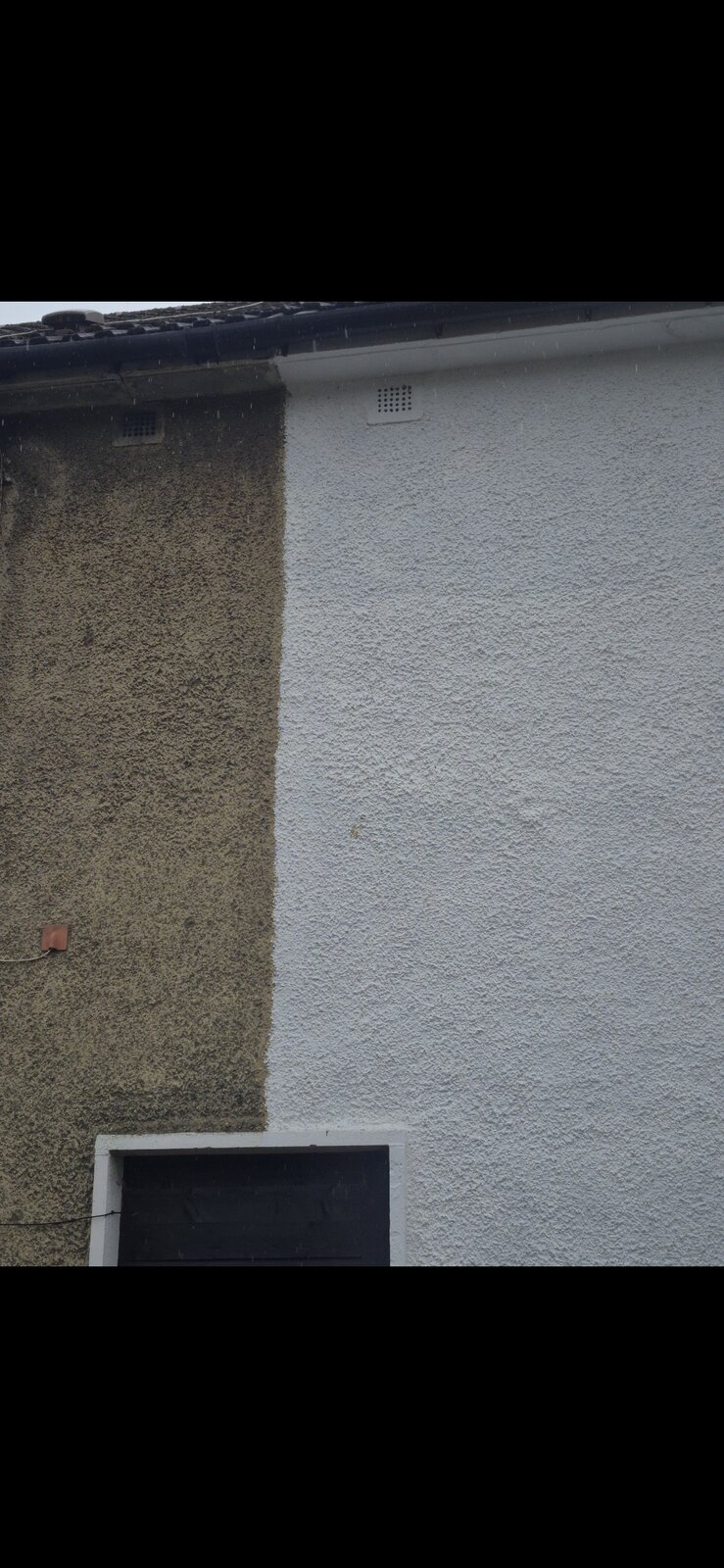

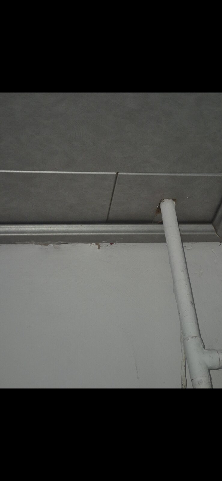

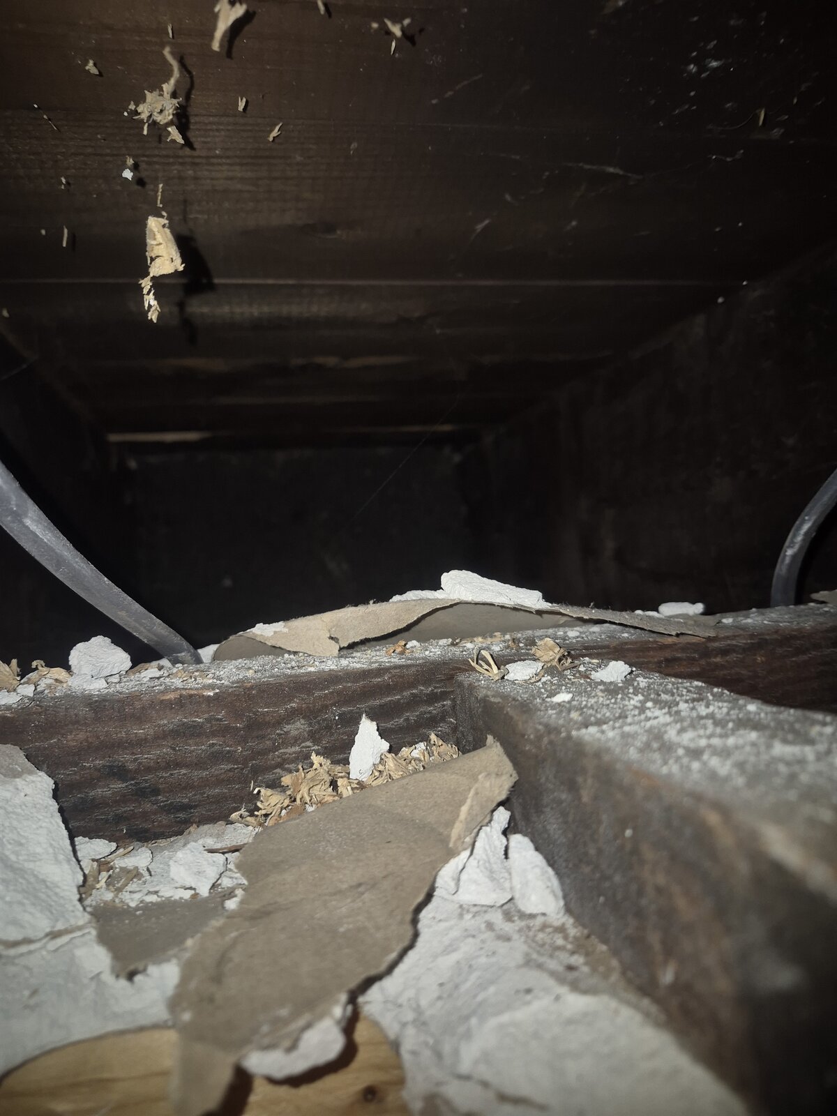

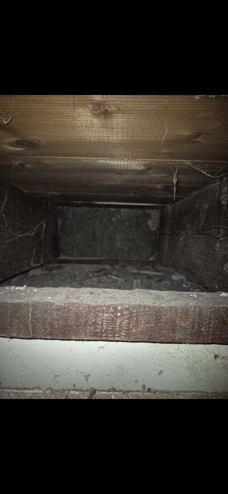

Here is a photo of where my house meets his house above a shared tunnel that leads from front to back garden. The white is ours and brown his. Where the white meets the brown paint is a wall ontop of the cemtre of the tunnel that goes all the way to the roof.

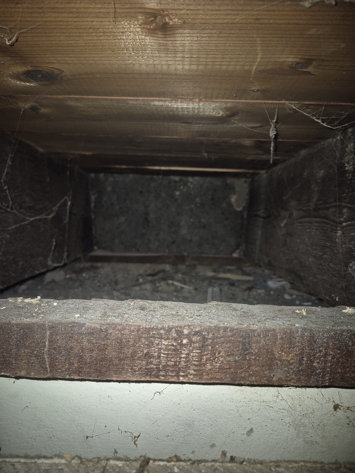

In the 3nd picture you can see this wall at the very back of the gap between the upstairs floorboards and ceiling.
The bedroom above extends over the tunnel to where the white meets the brown. However the kitchen and living room. End where tunnel starts.
So how is our cooking smells getting into his upstairs bedroom.
I am getting the cooker hood external vented and also a brand new plaster board ceiling fitted rather than the false ceiling that was allowing odors to pass straihht throuhh it please see photo. Also going to fill those gaps with insulation you can see but not the gaps where there is electric wiring as don't want it covered by insulation.
Then do you think this should solve the issue? Then that's all I can do.

Right, it’s not at all clear how the smells get through the party wall, yet. Maybe there is some other issue still to be found.
Repairing the kitchen ceiling is a good plan.
Putting insulation in that gap between the top of the tunnel and the floor of your upstairs room would be good for heat and noise, and can’t do any harm for smells. Take advantage of the kitchen ceiling being down to do something there. But there may be some requirement for some ventilation in that space - hopefully others will comment?
