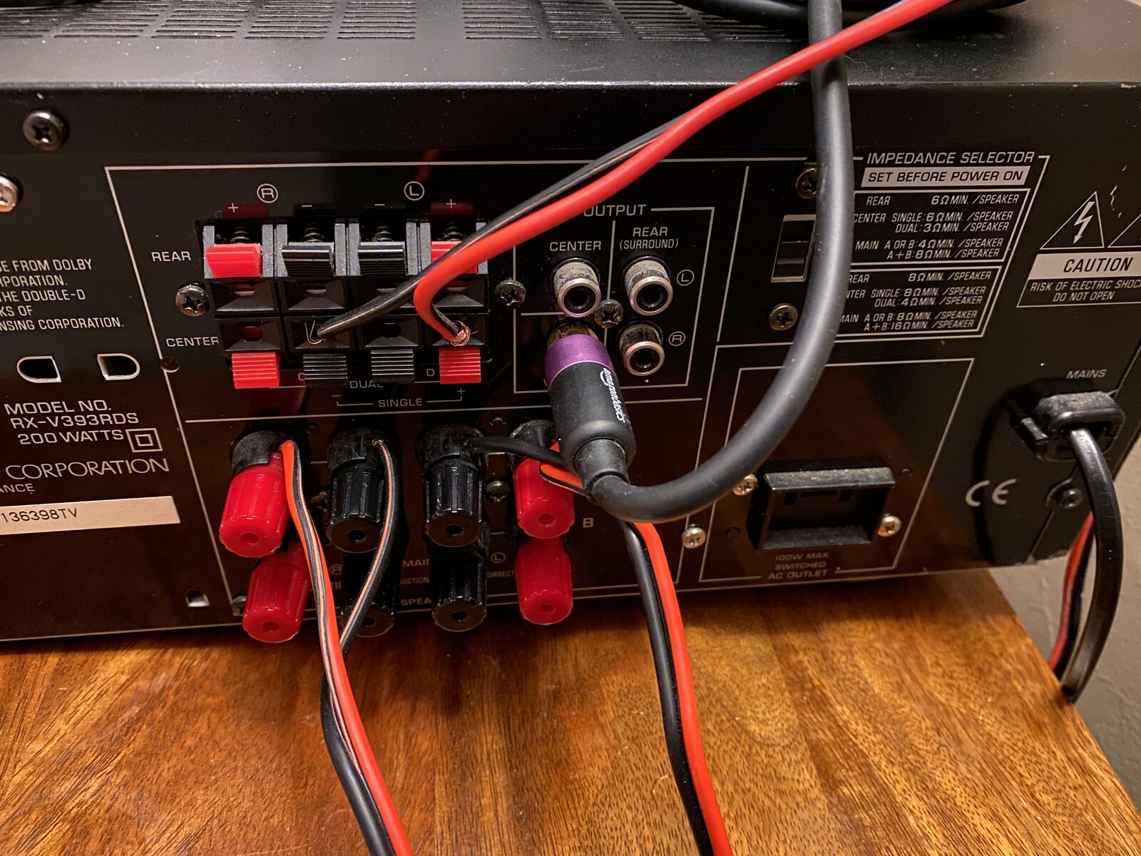

This is the current state of play at the rear (pics attached). The single male plug goes to the powered sub woofer. Input is via the ‘CD’ terminals as the phono input needs to be grounded (never had to do this apart from for turntables).
It’s frustrating as it’s so nearly there. The clarity offered by my centre and main speakers is excellent but the set up lacks the depth in bass.

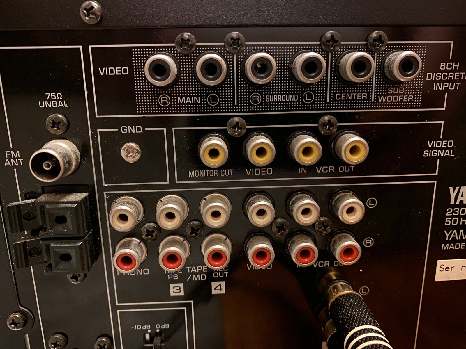

I’m just looking at that top bank of input terminals (6 in total).
Would I need a 5.1 decoder? I’ve never used one, but I’m guessing my input would be into that, with six wires then going into the “6CH discrete” terminals on the Yamaha?
The phono input on your 393 is for a turntable. It's set up for a moving magnet cartridge (MM) hence the grounding terminal. Don't put any line level sources through this. They'll be far too powerful for the MM input, plus there's an equalisation curve applied which boosts bass and cuts treble to compensate for the way vinyl is cut with low bass and higher treble. (It's called RIAA Equalisation and it helps prevent the needle mistracking.)
CD, TV/DBS, VCR, DVD/LD and TAPE are all line level inputs and available for your to use.
Your sub isn't going to get a signal unless there's something attached to the subwoofer socket of the 6CH DISCRETE INPUT section. Any cone movement you're feeling is background noise which can come from the receiver, the sub lead, and the powered subwoofer amp when everything is turned up to max.
The only ways you're going to get a signal into the sub is either to use an external 6CH decoder (or a source with 6CH out), or have a sub with Hi-Level inputs which takes its signal from the front left and right channels. There are pros and cons for each.
