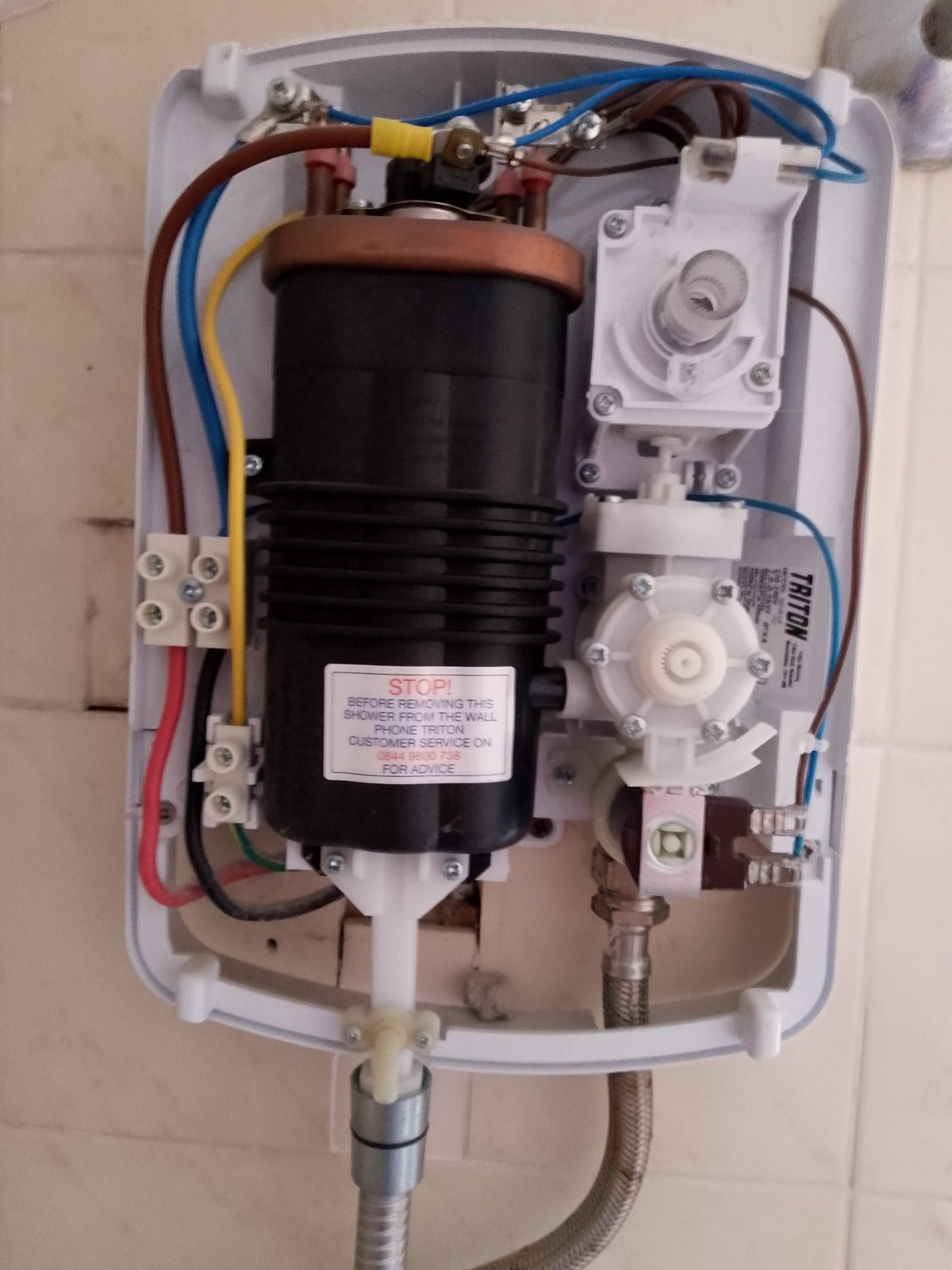

Hello all - newbie here - I turned on the bathroom electric shower yesterday morning and no water came out of the shower head. When I turn on the shower there is no power light (although it didn't show sometimes in the past) and just silence - no sound of the shower turning on.
Shower is a Triton Seville - had it a good few years and Gas Boiler is Baxi Combo.
I can get hot water to kitchen/bathroom taps ok.
Have tried cleaning shower head but it's made no difference. I took off shower panel cover but couldn't see any loose wires. Was working absolutely fine the day before so I'm not sure what the problem is.
I don't know whether I just need to replace a faulty shower part or get someone in to replace with a new shower.
Would appreciate any advice - Thanks Paul

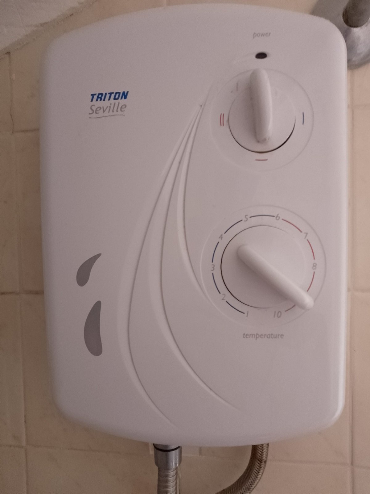

Hello - Yes there are just 2 moulded buttons on the front off the shower casing - one is an on/off switch and the other is for temperature. I've attached a photo of the shower casing. These are the only buttons I use for the shower. They worked fine until Friday and then nothing. Thanks for your update.

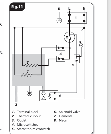

I think you’re misinterpreting what’s being said, have a look at this to help, note the double pole switch

That neon light in the shower should be on regardless of whether the shower is on or off AS LONG as there is power to the shower, you should have a pull cord switch in the bathroom or sometimes, but rarely a switch at the bathroom door (like a light switch), the shower may have been (against regulations) installed without either of these isolators, take a phot of your CU ("fuse board") and post it.
You haven't addressed the questions asked asked above.
The electric shower heats cold water. Somewhere, there should be an isolating point. Often that will be a pull cord in the bathroom (which might have a red neon indicator). Elsewhere, there will be either a fused connection unit, or the supply runs down to the consumer unit.
It might help if you can photograph the consumer unit- often referred to as the "fuse board"- often on the ground floor in a cupboard (but not always)
