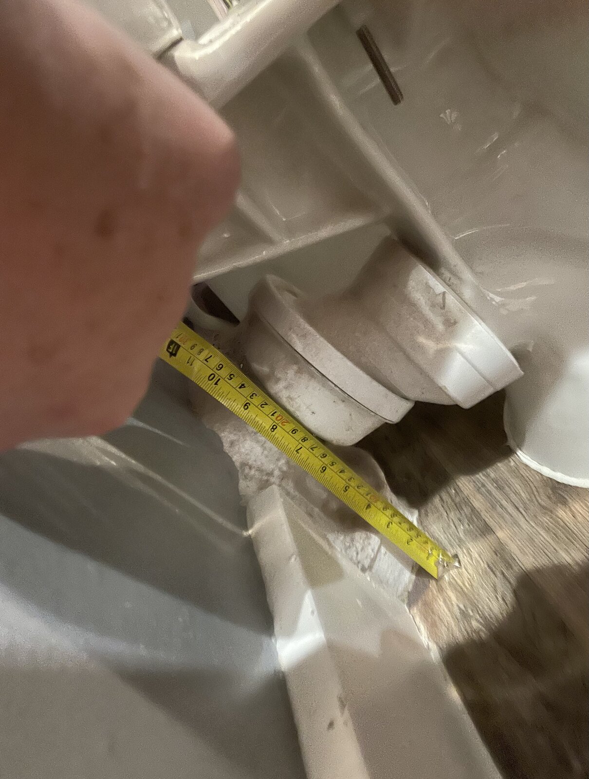

We just bought an older property and the installed toilet has a 180mm spigot height with a lash up waste pipe going to a 200mm high egress to the soil stack. Anyone know of a 200mm high pan? Spent hours on Google to no avail.
Alternatively any advice on a hardwood plinth perhaps to raise the height? Hate the ready made plinths shaped to the toilet I’ve seen. Or some better connector that may help?

Why not post a pic showing the WC spigot - the connector - and the soil pipe inlet?
Where are you taking your measurements from - to?

Yep it’s the old cast iron soil stack so I’d prefer not to have to change it. The toilet does flush but needs three flushes to clear the pan and the water rises quite high. I’ll take a couple of pics of the set up and post here shortly
Pictures attached

OP,
Remove the WC out of the way. Hire a 9" angle grinder with a metal cutting disc. Cut the projecting CI soil pipe at the wall. Doing this will lower the 200mm, & maybe, with luck, you will lose 20mm?
Whatever, you would only have a little to make up.
If you tile your bathroom floor with backer board & tiles under the WC pan then you will easily make up the height - but its still best to remove the CI stub.

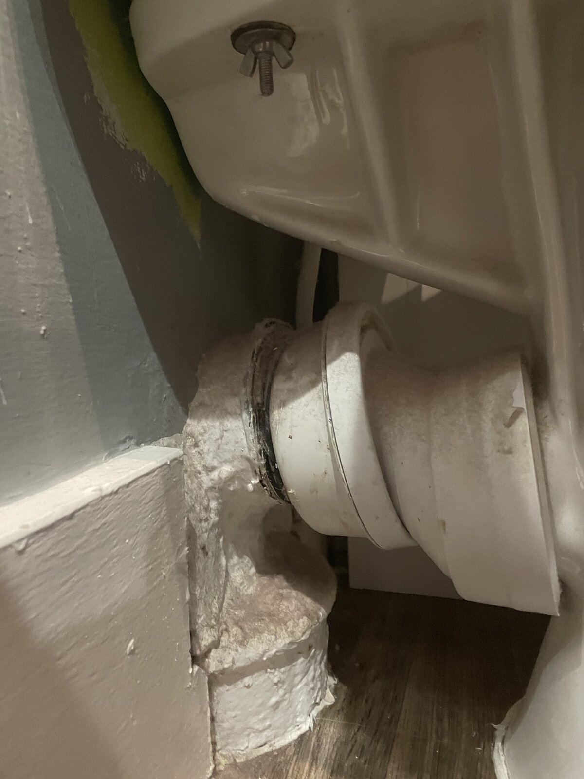

Can the strange rounded bulge below the CI stub also be removed?

Whats' the strange rounded bulge on your shoulders ,poster #6 It's vision is so poor. The OP's bulge is a c.i. socket, the pipe to the WC goes into it on a bend that's already been cut. Unusual setup but there you are. To paraphrase "The Prisoner" You are not a plumber you are a troll.
+1 Yup, be careful, that's looks very like a vertical CI stack or even clay with the toilet connected to a bend running down into the knuckle. Cut that any further back and you may lose the ability to insert anything.
Is this bathroom on the ground level? I think you need to open up around that just to see what you have before you do anything.
Just as an addition, if it is a bend and goes down into a CI or clay socket then clear out around the connection, cut it level to the socket , dig whatever is in there out and they you may be able to get a adapting bend/pan connector into that to get your 180mm centre.
I think the bend might be a lead pipe, carefully removing the old paint will reveal all.

I gave you bad advice ref cutting the soil pipe - my apologies.
This afternoon I looked at your pics on a friend's monitor screen, and immediately saw details that I had obviously not seen before.
