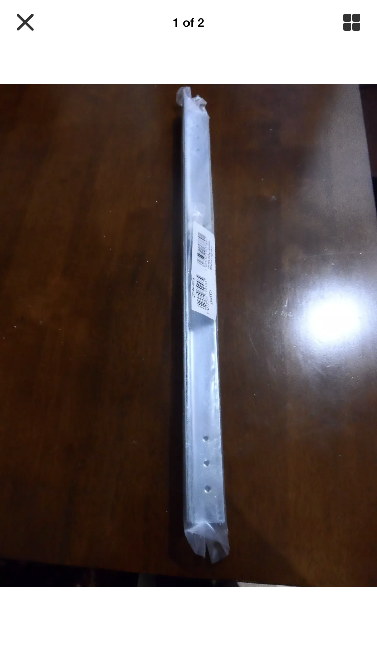

After some measures I think this could be the perfect solution! The shelf board is 20mm thick so if I took it off and replace by some metal angle brackets I should have the space I needed without needing to lower the drawer - means the drawers front panel would still line up with the doors next to it. I'll probably put 6-8 L shape brackets to support the oven just to be on the save side - now I'm off to search for some brackets ... Thanks!
On flebay £7
