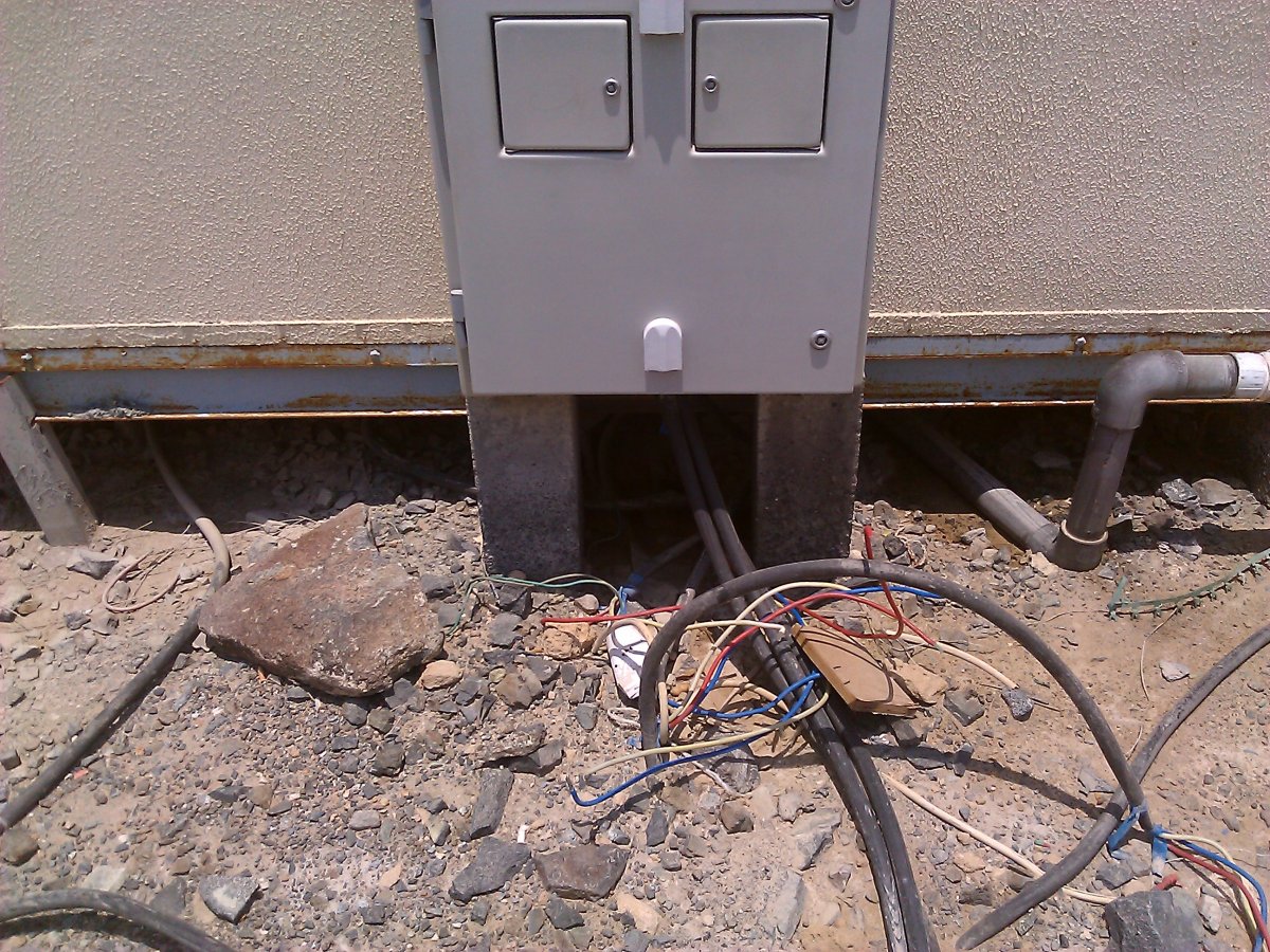

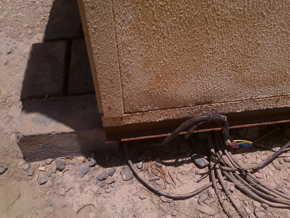

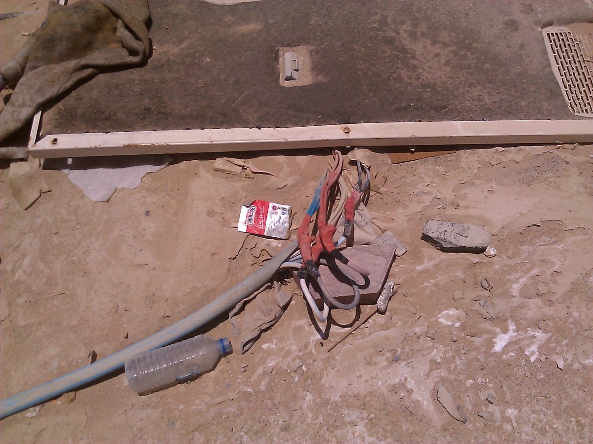

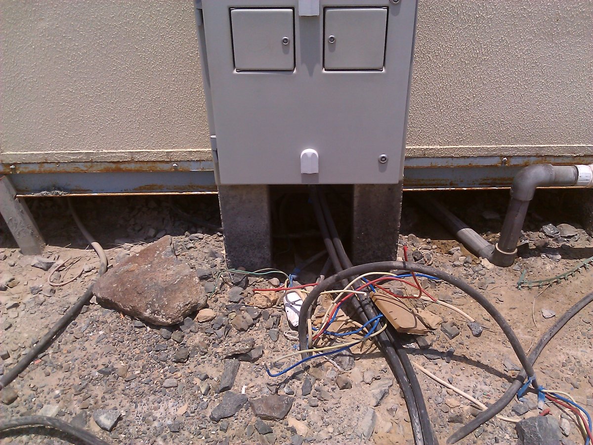

Ok, not strictly in the UK but it’s 415V 50Hz and should have been to UK standards. It’s live and in use on an active site.
This is permanently left open in a small room with an open door, so when it rains it does get a little damp.

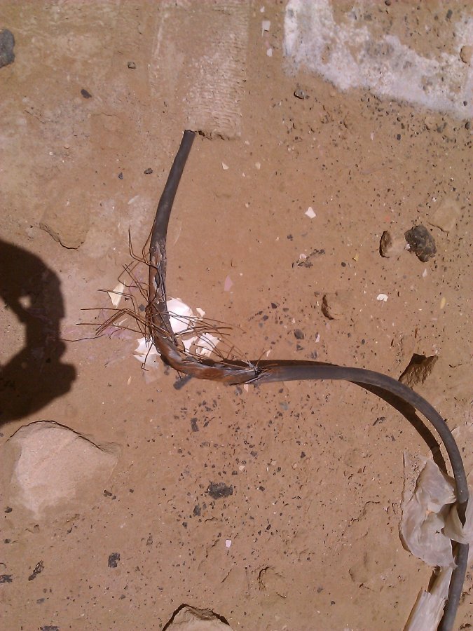

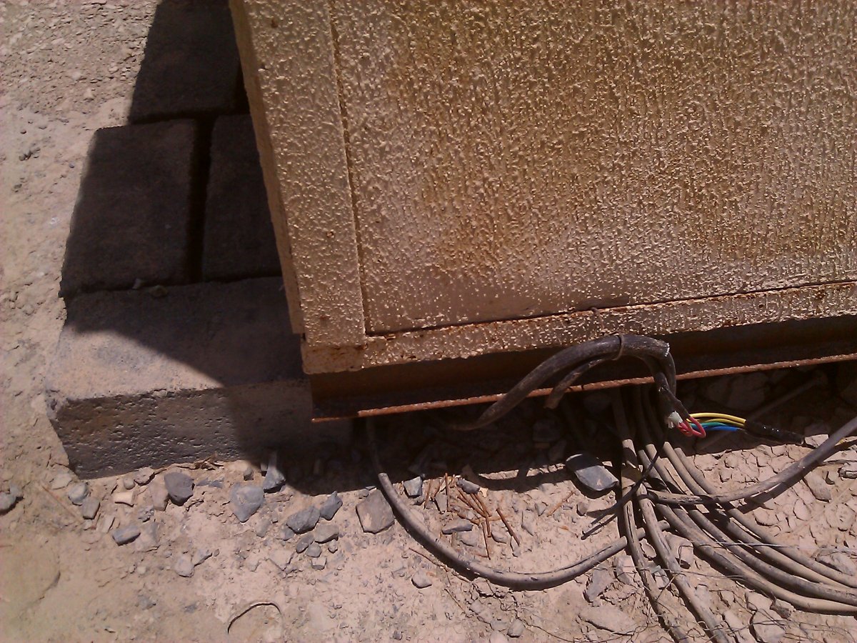

This isn’t a close up, it’s a large SWA cable.

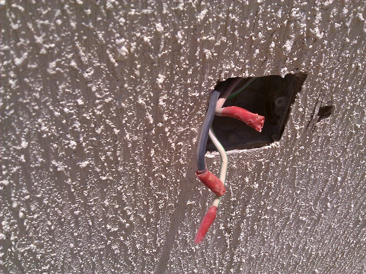

Not sure if this one is live or not, looks burnt, possibly crushed by a large vehicle and has burnt due to a lack of fusing or breakers.
Fusing of small items like fans isn’t necessary either.

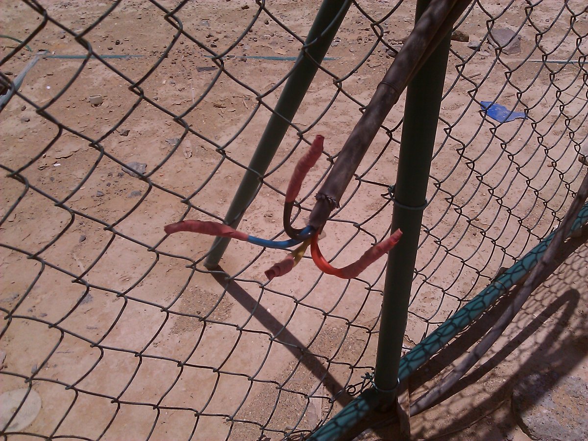

Tread carefully, especially when it’s raining.

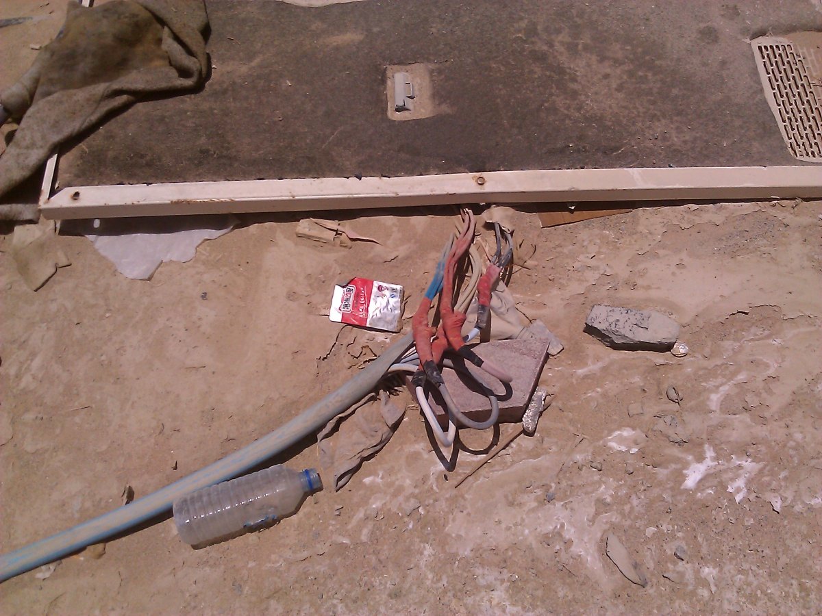

Some other H&S failures.
And your point is?
Possibly.
Possibly.
Or possibly this is uninformed speculation on your part.
And you know that the cause of that damage was lack of fusing, do you?
Or is this is uninformed speculation on your part?

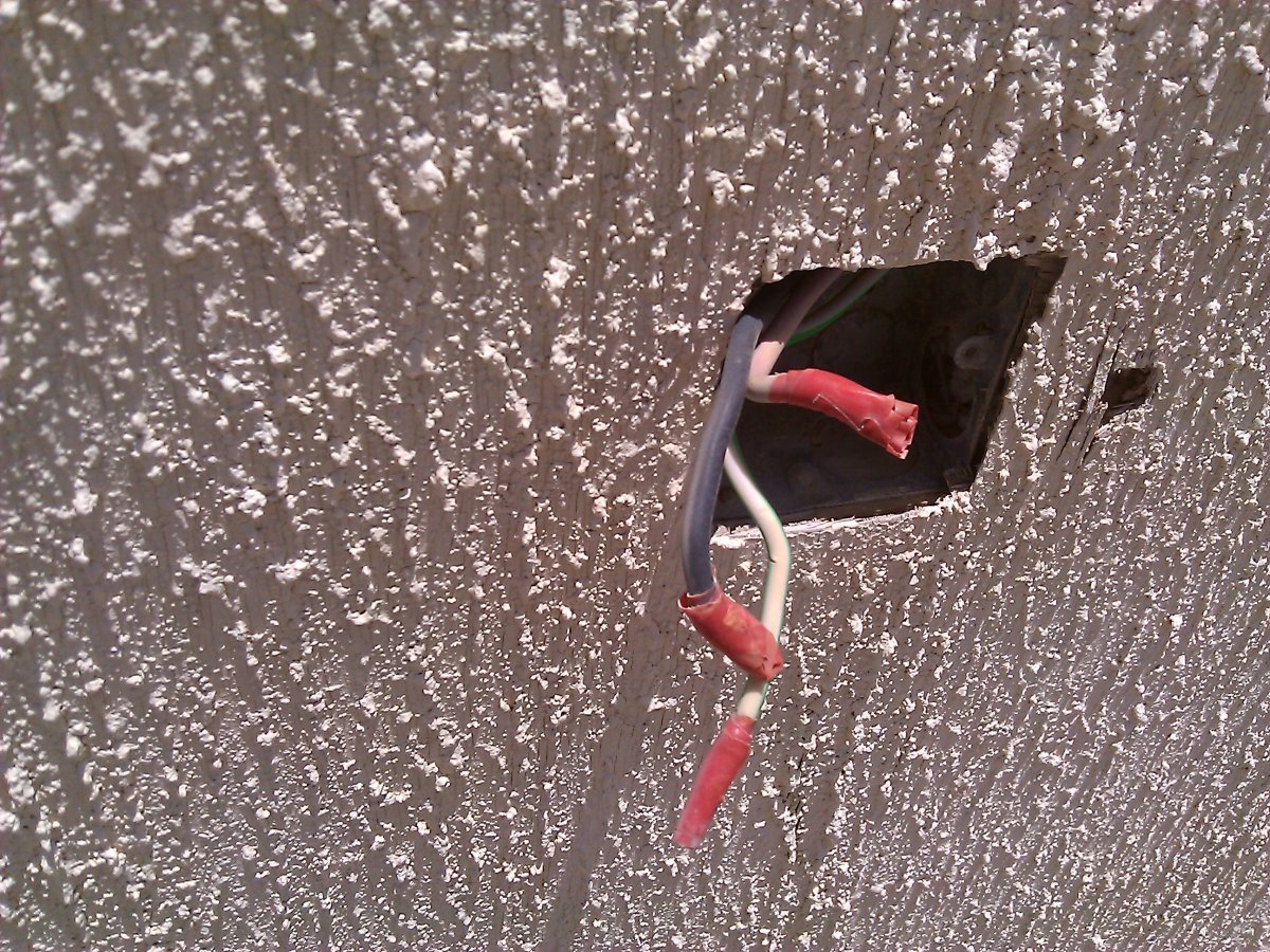

And you know that that's not disconnected, and waiting 2nd fix, do you?
And you know that all of those are not disconnected and derelict, do you?
And you know that those containers haven't been cleaned out, and are awaiting re-use or disposal, do you?
Why should it?
A. That was the specification.
And your point is?
A. There's no point, just information.
Possibly.
Possibly.
A. it is uninformed speculation on my part, hence my use of the word "possibly".
A. The damage is fire damage and the fires were caused by overheated fan motors that were not adequately fused. Would a fuse have guaranteed no fire? I can only say it would have made it much less likely.
A. All installation work is complete and it is live as you can see the connected equipment operating.
A. As stated at the top of the post, it's live and on an operational site. If you use the definition of derelict as "in a very poor condition as a result of lack of maintenance and neglect" then yes, you could apply that definition here, but it's still a busy and operational site.
A. Yes, I know the containers haven't been cleaned out and leaving them there was the disposal.

Exactly, for example you can see the first distribution panel didn't have any Earth connections for any of the supplies. Compared to the UK with rules stating that you need tools to access panels in the workplace, etc - there it's just up to you not to touch the open panel and to be fair, you don't!
Yes, things catch fire more often and equipment (and people) are damaged more often, but if it can be made to work again by bypassing the damaged breaker and taping together some wires, then that’s seen as a good result.
It's ok for me as I can insist that systems are shut down and isolated before working on them, but for the local workers I have seen them forced to make connections to fiddly screw terminals next to live and bare 3-phase 690V AC supplies which I don't think is right.
