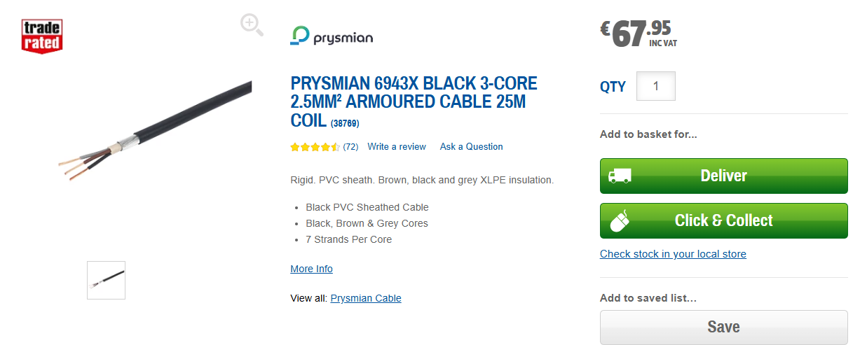

Hi all . Thinking of getting some 13a sockets in the garage/shed and i am going for SWA cable (some cable might have to go underground/under lawn.
so , going for 2.5mm 3 core SWA for the sockets . On the screwfix site though the cores of the cable are coloured Brown, Black, Grey. (I am in rep of Ireland but we have same electrics as UK 230vAC 50hz Brown (Live), Blue (neutral) , Green& Yellow (Earth)
could I use this 3phase 2.5mm swa from screwfix with its wrong colours and wire brown to Live, Black to Neutral and Grey to Earth (put a G&Y sleeve over it or G&Y insulation tape) ? - will it be OK?
for some reason on the irish site they dont even list SWA cable with the Brown,Blue,G&Y cores - but surely 2.5mm is 2.5mm in whatever colours the insulation is shouldnt that be the case?

Yep just overleeve it.
Usually- brown, live
Grey, neutral
Black, earth

Oversleeving is prohibited. It must be of the correct colours (as indeed any SWA sold by electrical wholesalers within the 26-Counties will be).
Also Andy from Sligo (originally from England) is probably illegally carrying out Restricted Electrical Works.

As a matter of interest what combinations of insulation colours are available in that country for 3-core SWA, and also for 3-core + E T+E?

3-core & Earth cable doesn't exist. When a RECI Inspector came across cable sourced from the North before by some stupid contractor he referred to it as "three-phase cable", which is understandable given the core colours. The contractor was, of course, forced to eradicate all traces of that abomination. 3 core SWA will always be single phase colours plus cpc core (unless special order).

OK, so does that mean that 3-core SWA with 3-phase colours is not generally available? If so, does that mean that reliance on rmour (as CPC) is not allowed?
