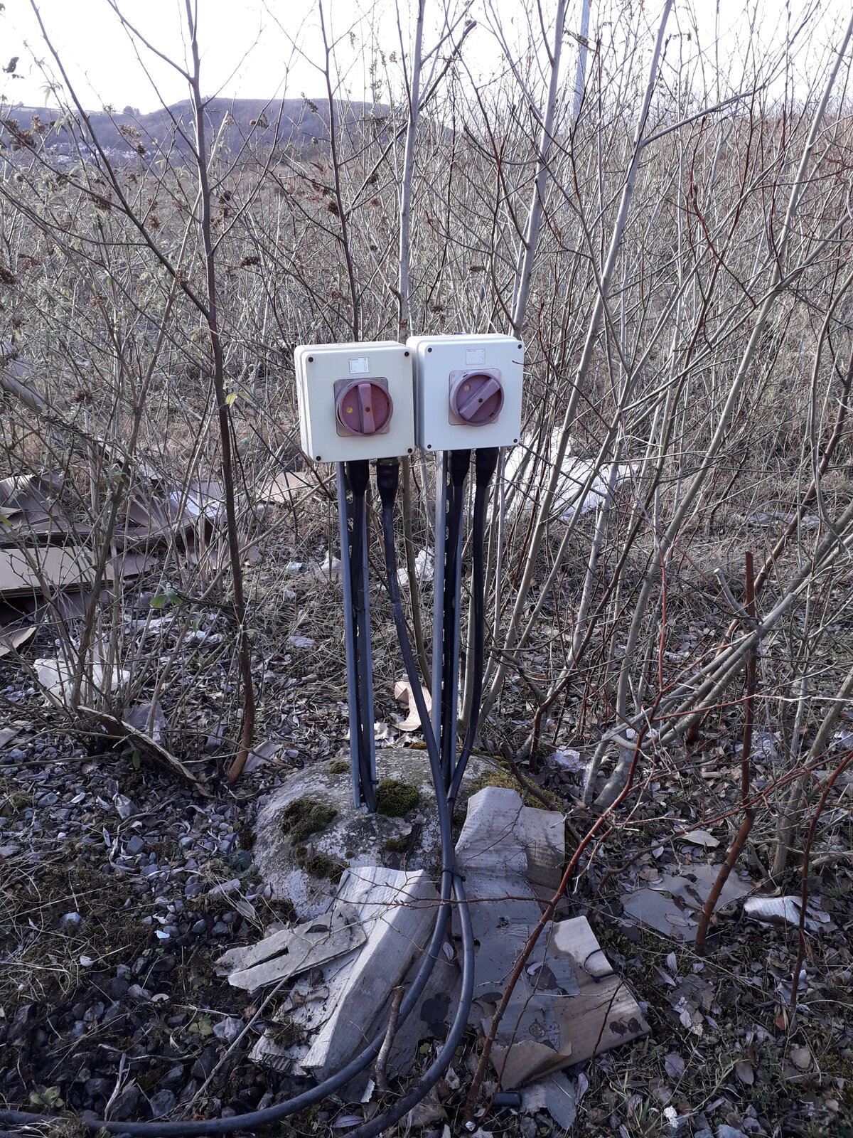

can you use 3 phase SWA cable for 230vAC single phase?

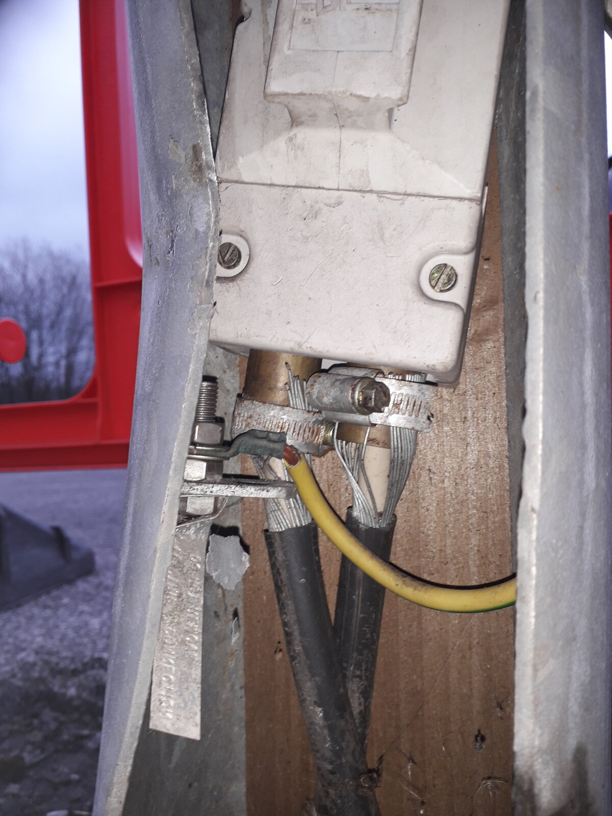

I used to, but in my last 15 or so years ot so I found so many issues I always added an earth wire.
Inside a factory I cant see a problem, outdoors definitely use a separate earth
If i were wiring it up with SWA then and that was me I would use the Brown for live, Grey for Neutral (sleeve blue) and black for earth (and sleeve) then another earth for the gland for the steel armour of the cable - 2 earths then , black core and the steel brading of the swa. - but if oversleeving illegal over here then thats another issue.

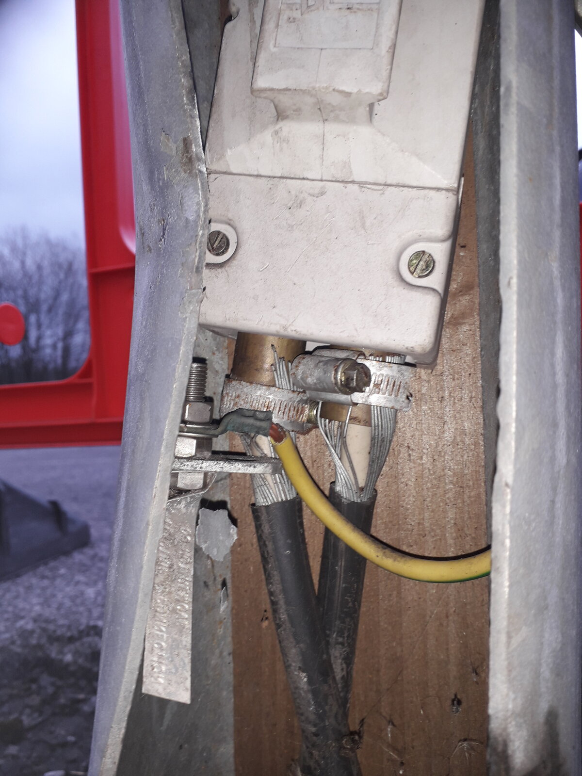

Those photo's were inside a factory. Lights on a paint line. The armour on 2 of the cables was live, that was how I found it :oops:

These 2 isolators also were not bonded across. The SWA was lay in water on the ground surface feeding 2 inductrial compactors.
