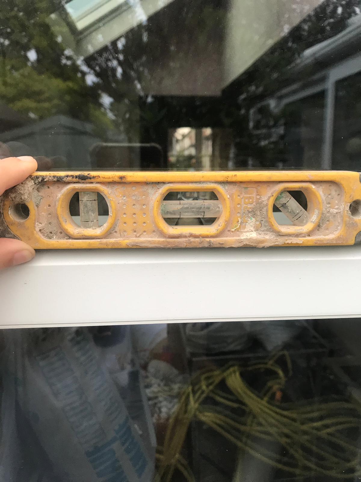

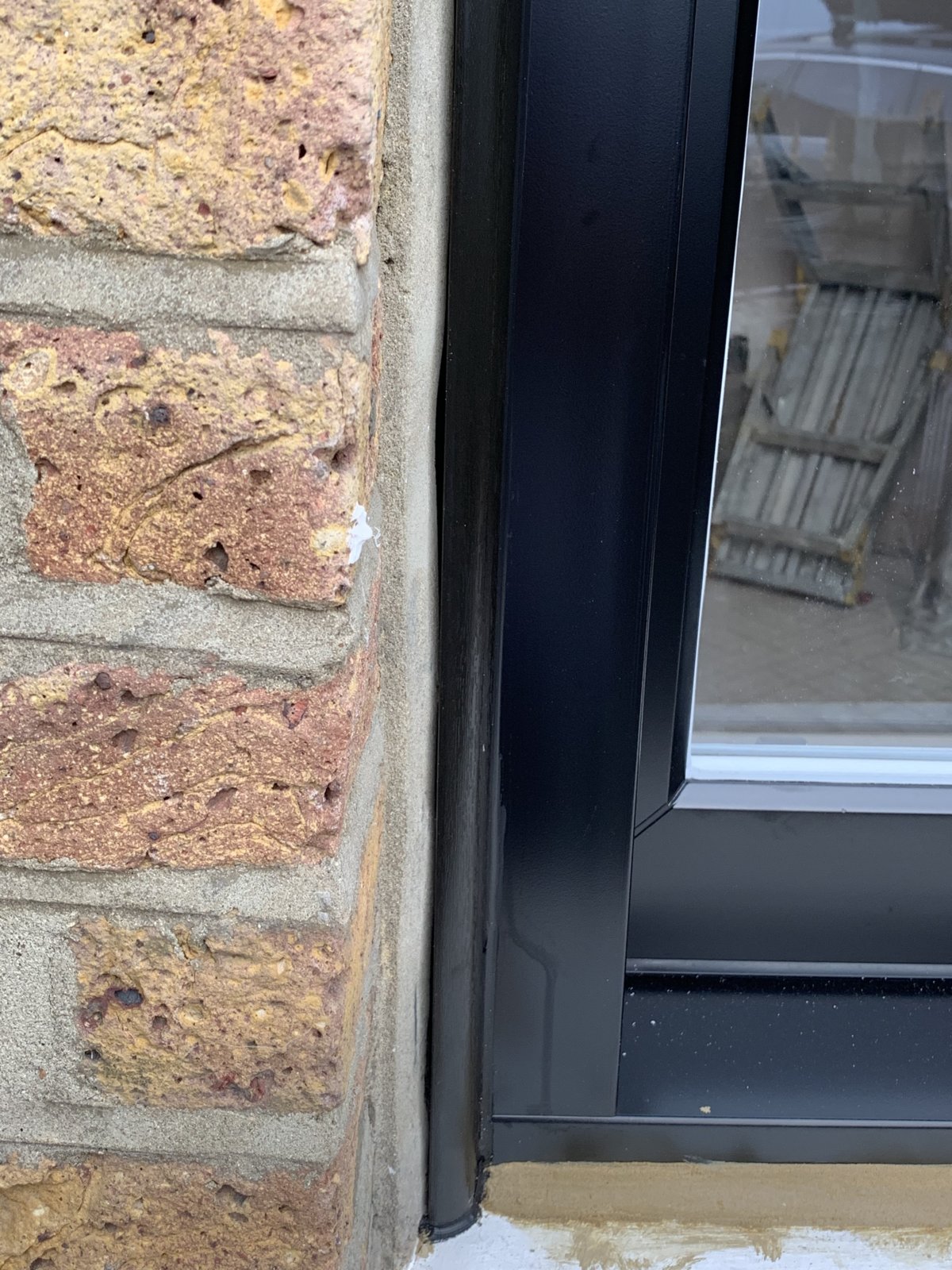

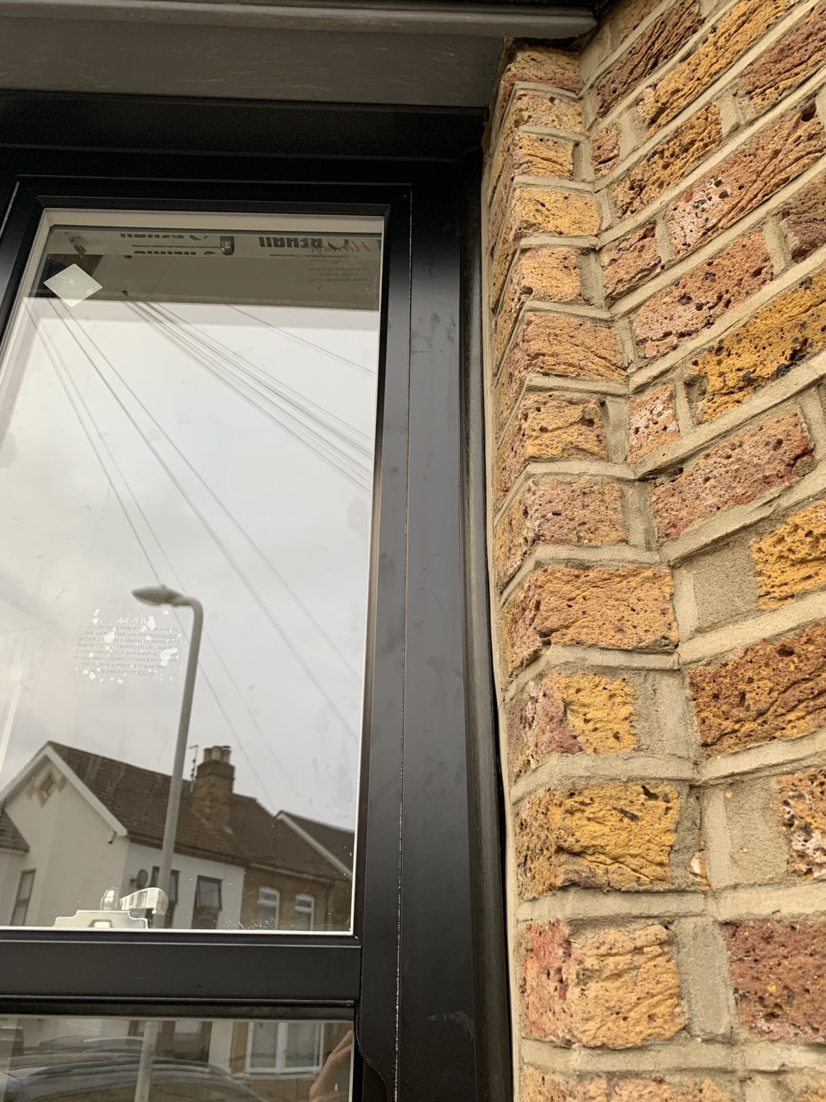

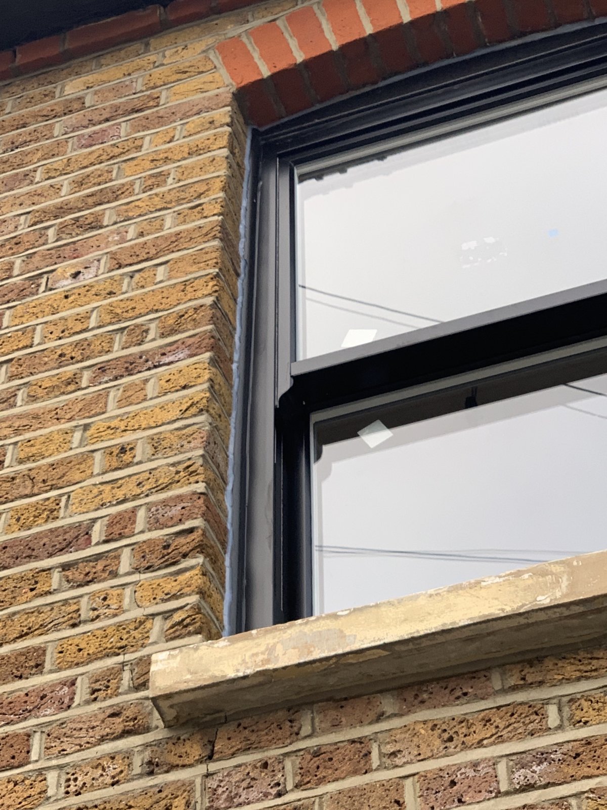

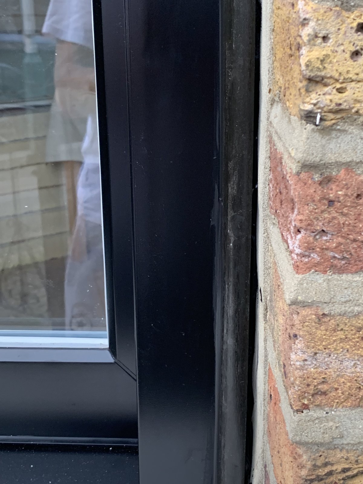

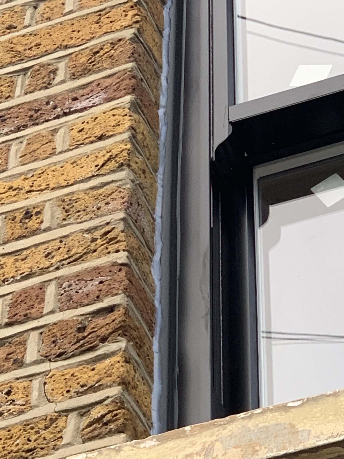

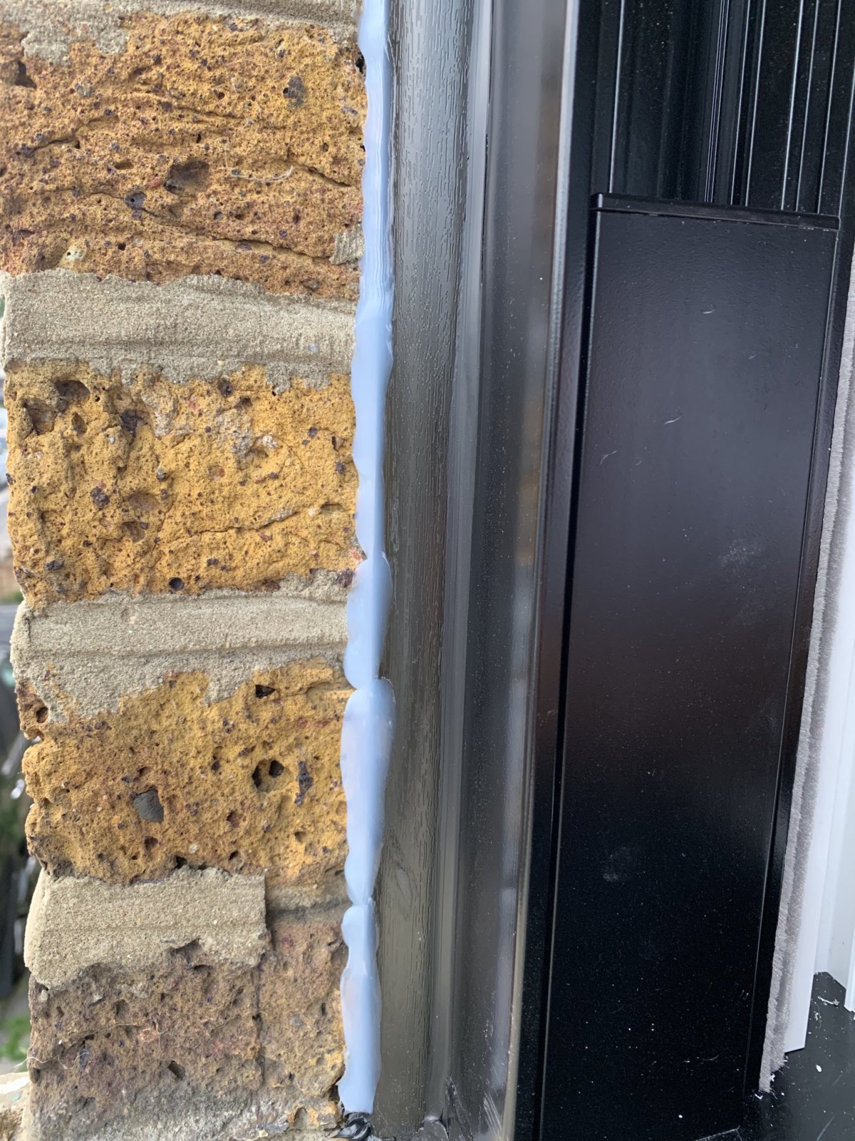

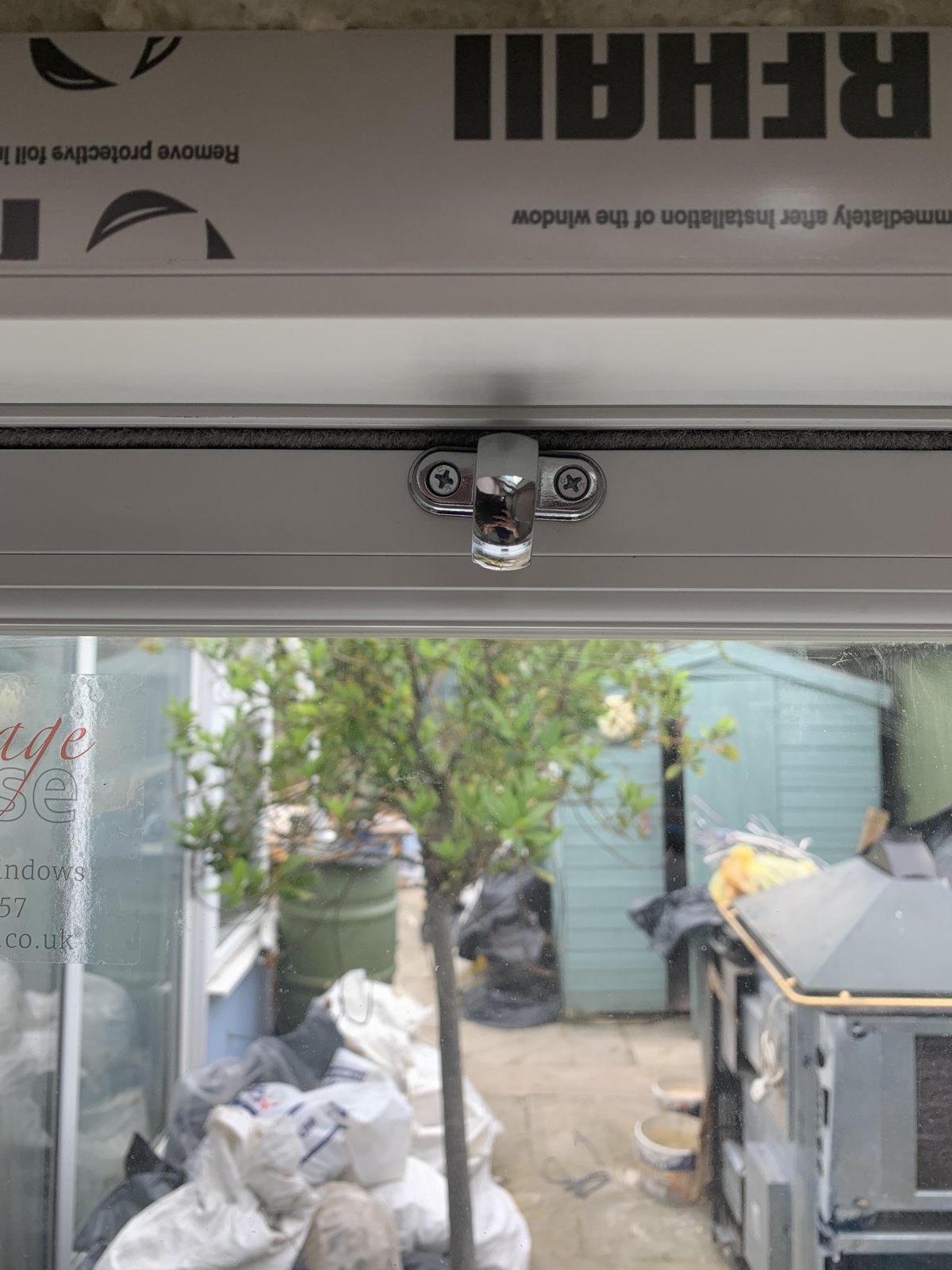

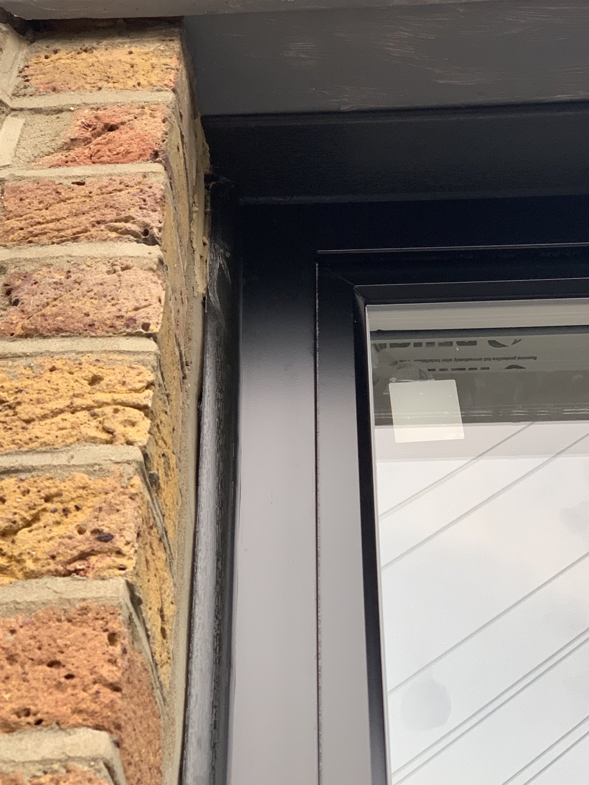

We knew there would be more frame then the casements. Images below of some of the issues - I'm about to send him an email. I'm beyond ****ed off now.
20190625_193226626_iOS.jpg 20190625_193231572_iOS.jpg 20190625_193242959_iOS.jpg 20190625_193250981_iOS.jpg 20190625_193736428_iOS.jpg 20190625_193746799_iOS.jpg 20190625_194559697_iOS.jpg 20190625_194759682_iOS.jpg Kitchen 1.jpg 20190623_111501503_iOS.jpg
Not sure if you can notice the wood grain trim with the smooth frames too...
Did he fit them from the inside or outside?
Im only looking on a buggered screen but my guess is they shouldve been measured to fit behind the brickwork, not in between.
Im wondering if he has measured them for internal box size and has ordered external box size -Im not sure on upvc ordering methods, Im a wood man and in wood box sashes can be ordered in 2 diff ways.......

Ive had a look on the pc now -Im wondering if when the upvc casements were fitted, the original weight boxes were left in place and the new sliders have been measured to the same.
the inside detail might tell a bit more -do you have the original architrave around each window? -traditional box sashes had to be fitted from the inside because they were wider than the external brickwork and the box frames pushed up against the back of the external brickwork -ie in the cavity (internal brickwork is therefore wider).
To fit replacements to achieve similar sightlines, would require the architrave to be removed along with any liners and windowboards, then the window put in place.

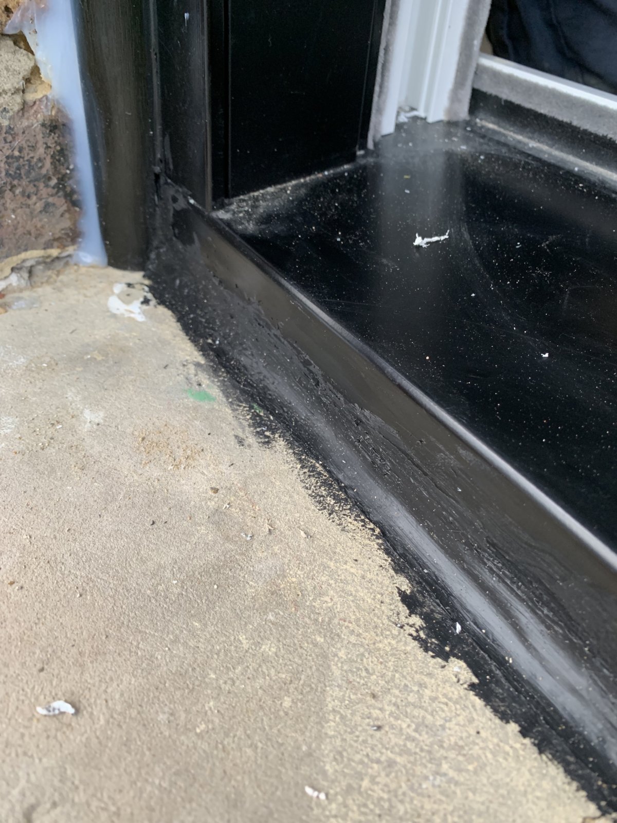

Update:
I've spoken to the guy and he was very apologetic and ensured he will resolve the issues.
The only thing he isn't sure about fixing is the trim between the wall and window as the wall is very wavy.
I suggested he removes it and I point the wall to cover the gap but he said due to uPVC shrinking, it would cause a small gap between the cement and window.
Any suggests to resolve this?? Pic below regarding this:
