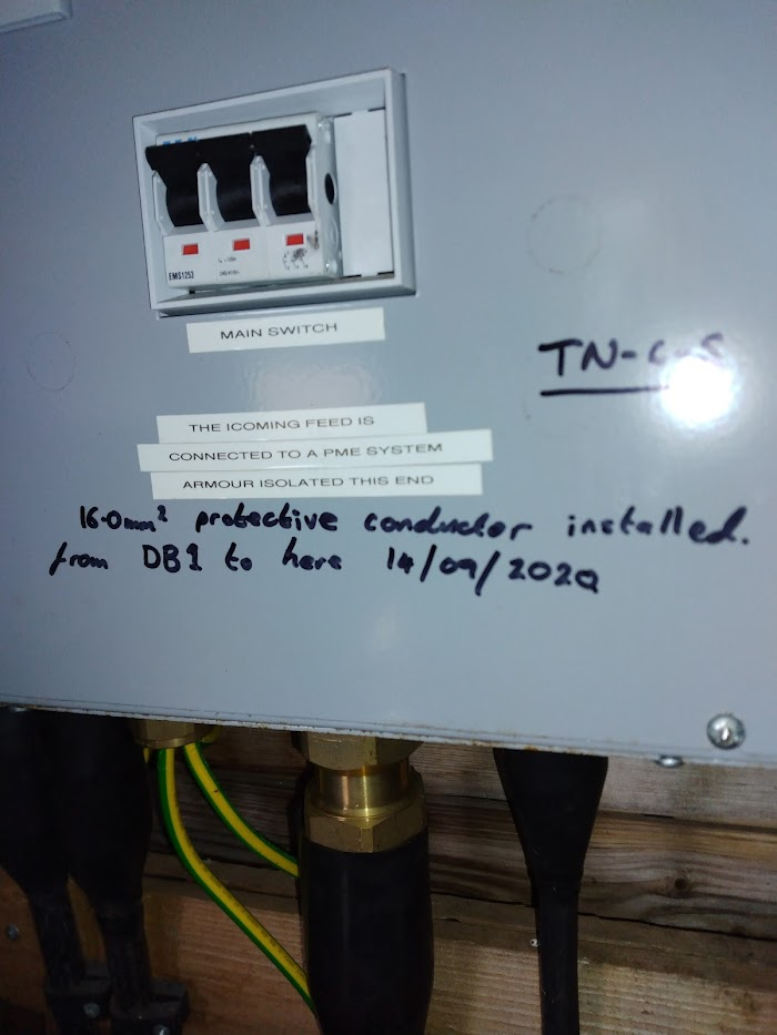

Not sure if this is ok to connect
I'm sure there is more labels on there but don't have pics.

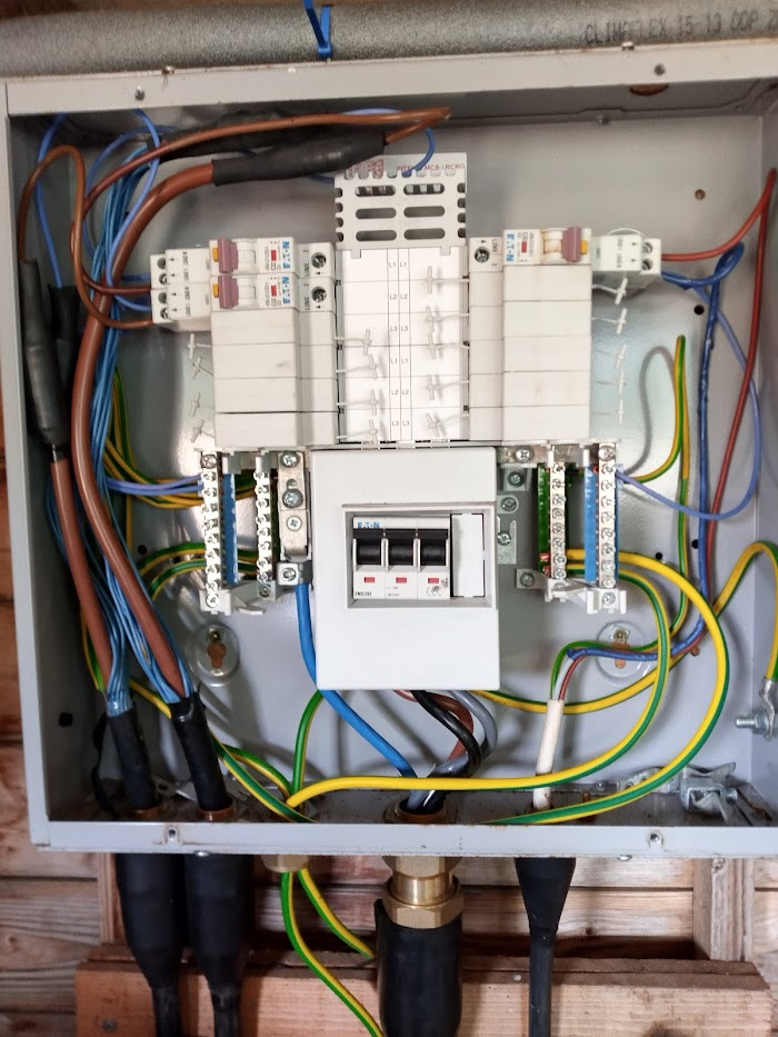

Ah I thought I had pic, this is inside the door;
The Dymo label was our original marking. DB1 is the main board some 100m away.
Seems I lied the additional earth wire is not 25mm² and the O/G SWA is on the right:
Either way the earth bars and enclosure appear to test at dead short but I suspect that may be the way the SWA is terminated in the adjacent Toilet building.
EDIT: It occurs to me the CU and low power class1 tubular heater in the adjacent toilet building are in very easy touching distance between them and the basin taps. Most of the internal water pipes are copper but the feed is plastic.
There are 2 more circuits now for light and socket in this building.
