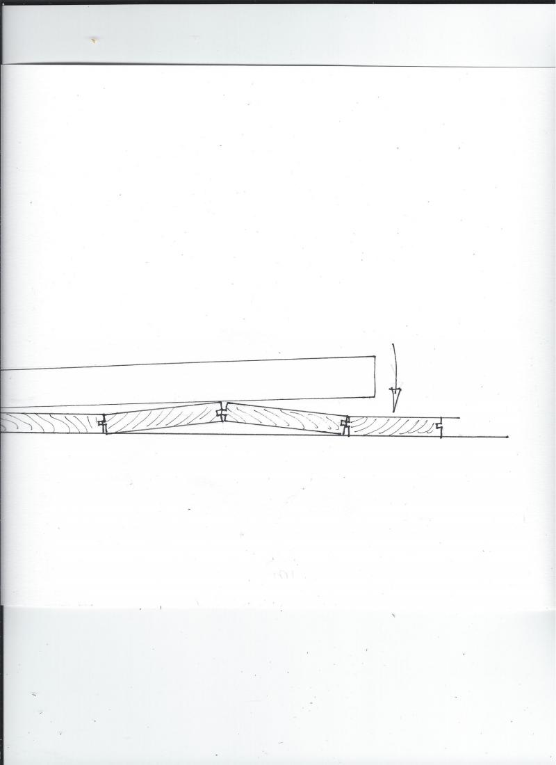

There is a way of doing it and still keeping the last tongue intact (the boards might squeak if the tongue is removed).
Line up the last few boards as on the sketch. The tongues must exactly line up with the grooves, and the latter must be completely clear of dirt/shavings etc.
Put a board or boards across them and jump down smartly on them. If everything was lined up, they will go down OK.
