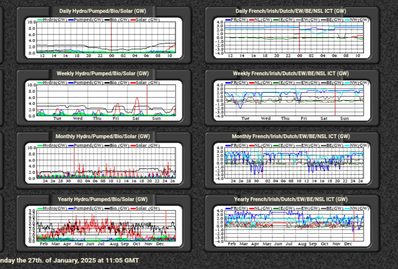

I can only presume that the UK doesn't have the facilities to store electricity generated from renewable energy given during the last storm it was exported to France?
At times when there is a surplus of energy, and the price falls, the pumped water storage hydroelectric schemes refill their reservoirs.
They help to even out peaks and troughs, and make their profit by buying when prices are low and selling when prices are high. Prices vary throughout the day.
The bio furnaces also mostly run during high demand.
Transmission cables enable electricity to move from wherever it is abundant to wherever it is needed.
