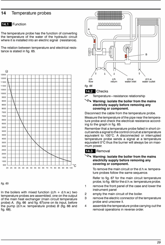

Firstly, can anyone tell what this is and what it's function is?
Secondly, What are symptoms of it's failure?
Thirdly and lastly, how easy are they to change (on an Ideal Classic NF60 Boiler)?

N.egative T.emperature C.oefficient resistors basically. That is as the temperature goes up the resistance decreases. Uses - well combined with a transistor they make a simple fan controller so that as the temp rises the fan goes quicker (e.g auto fan speed controller for a PC).
Do you know where they are? I guess are used as the the flow and return temp sensors, it would be easy enough to knock up a circuit that used the difference between two of them drive an output to the gas valve and regulate the gas supply appropriately (of course the latest boilers are microprocessor controlled - but probably use NTCs as the sensors).

Thanks all for the info!!
I had a theory that my boiler cutting out when there was demand for HW/CH (but HW in particular) was due to overheating and not firing up agin unless the boiler is switched off for a period of time could have been this sensor.
Not so sure now as the cutting out could be the sensor working ok?!
Perhaps the PCB is the item stopping it from firing up again?
This is typical - many boilers ntc's have similar resistance curve.
NB this is from a COMBI boiler, yours isn't.
And yours hasn't got an NTC, it's got a thermostat!
Check circulation.
