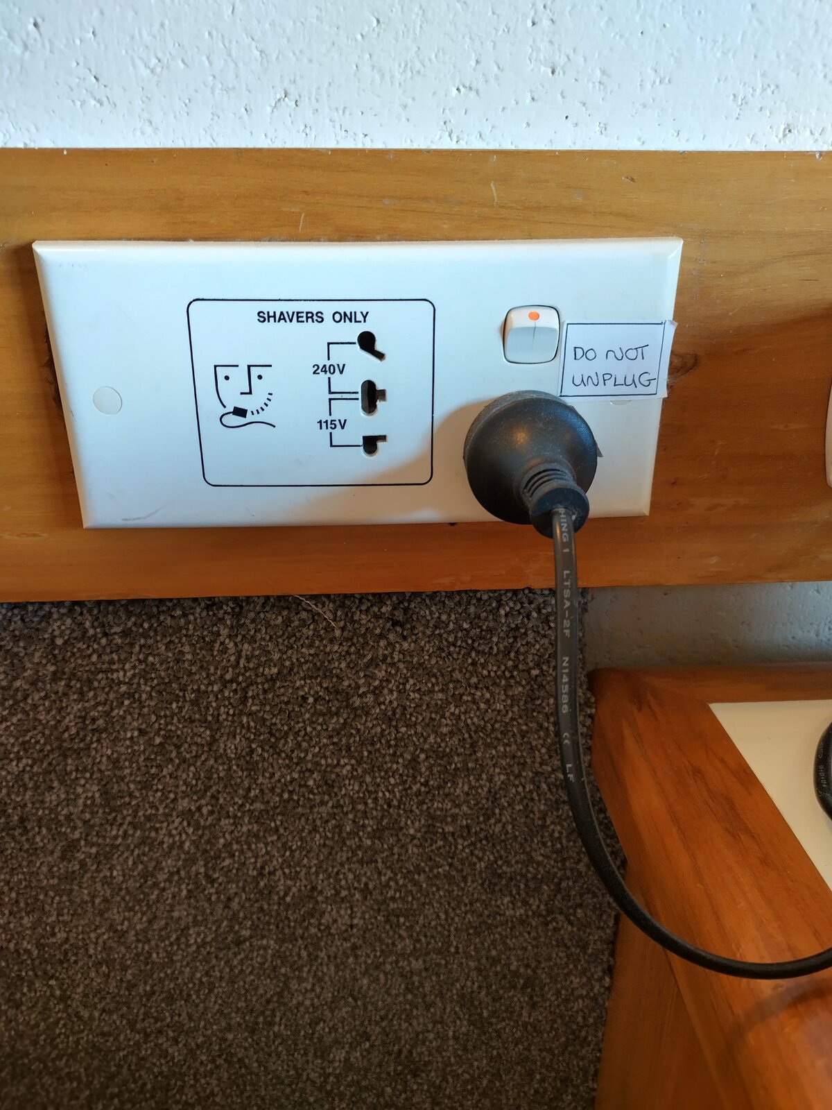

On reflection, I suspect the DP switches have to have "OFF" marked on them, but SP switches don't.
Who knows?! Even most New Zealanders presumably don't understand the difference between SP and DP switches or the significance of the difference?
I also would suggest that (unless one "knows"), those rocker switches are somewhat potentially ambiguous. I imagine that if one pushes the bit labelled 'Off' that probably turns the switch off. However, others may think that it's off when the "off" side of the rocker is 'sticking out'.

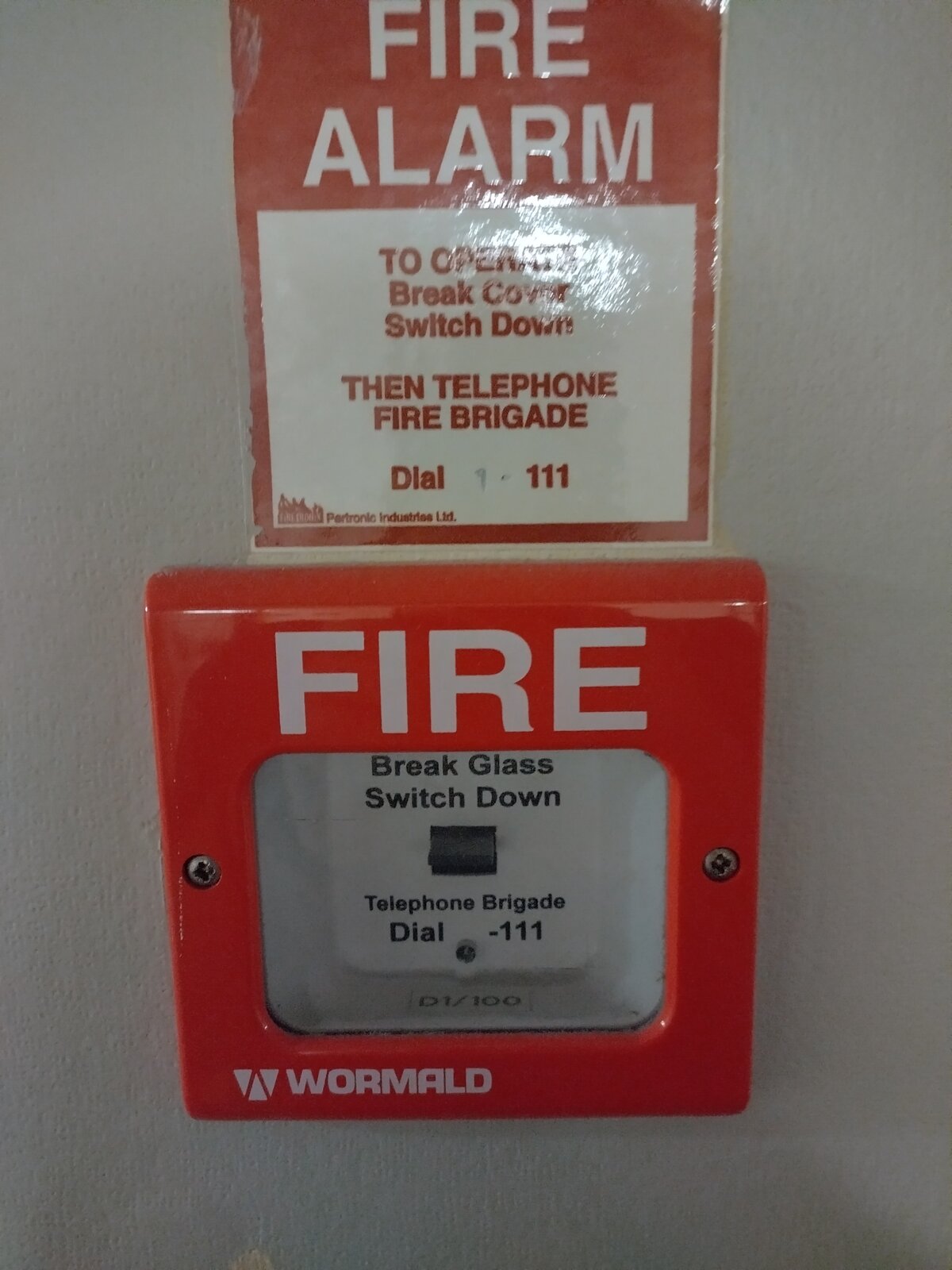

Call point:
Interesting in that breaking the glass does not automatically operate the call point, you have to manually switch it.
I think you fill find that the Switch is "Momentarily ON",
Hence, it acts like a Push-Button.

I think you fill find that the Switch is "Momentarily ON", ... Hence, it acts like a Push-Button. ... The ones that I have seen in Australia incorporate an actual "Push Button".
With the ones we are used to see here, the usual arrangement is that it is a non-latching 'push for off' button which is held in the 'pushed for off'position by the glass. Hence, immediately the glass is broken, the button 'springs out' into the 'on' position, without any 'switching' action required of the user.
That seems fairly sensible, the only downside really being that in the (very rare) event of the glass being broken accidentally, the alarm will be activated.
The only break glass call points I had any dealings with have been a 4 position button (but I suspect an unusual arrangement) where out is the alarm, middle is normal and held by glass, in position (achievable by pushing the glass) is a test facility and a very long push further in like 20 sec or even more is that points alarm cancel, ie after being set off by breaking glass.
It's been a while, but the last ones I investigated, had a second button, held closed by the access cover, itself kept shut by an allen screw. Undoing the screw/opening the call point, disabled alarm button. That allowed the alarm to be cancelled, panel reset, until the broken glass could be replaced.
Fair enough, but that';s still consistent with what I said (with additional functionality to test and cancel) - namely that the button is held in an 'off position' by the glass, and 'springs out' to activate the alarm if the glass is broken.
Fair enough, but, again, that's still consistent with what I said (with additional functionality for cancelling) - namely that the button is held in an 'off position' by the glass, and 'springs out' to activate the alarm if the glass is broken. ... what you call the 'second button' being what I would call the 'main button' (the other button/switch being for resetting/cancelling)
No, you misunderstood. One button pressing against the glass, the other button presses against the frame/cover, which is held in place by the frame/cover.
Upon releasing the frame/cover, the button upon which it presses (call it the 'test' button), opens the circuit, before the break glass button closes to sound the alarm. Hence, the alarm does not sound. Once the cover is released, the alarm point can be tested, by now briefly pressing the test button.
If a glass has been broken, then the alarm could be stopped, by undoing the cover with an allen key.
A later system I came across, included a tamper circuit. From memory, something like - ac injected at the panel, and a diode at the final call point of the circuit, several call points located together, in one area.
