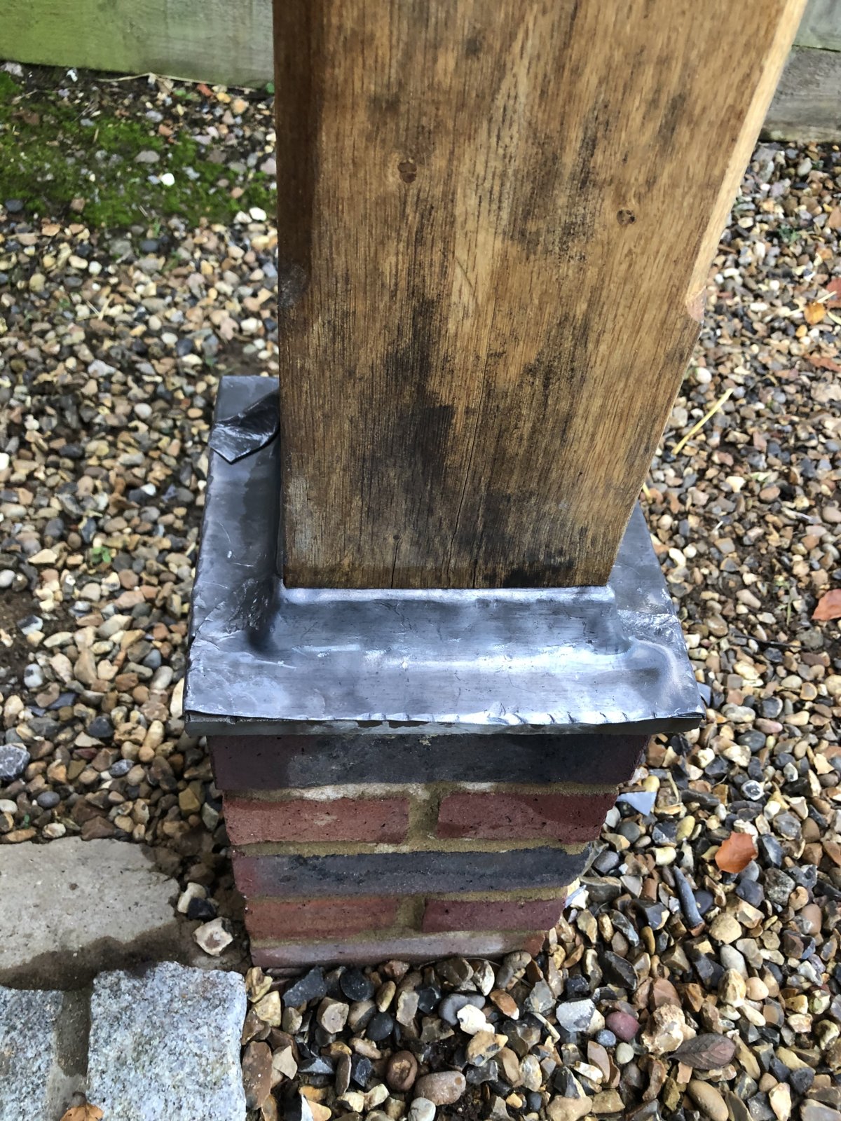

hi all
I have the following issue .. 4 heavy oak posts which sit on a steel rod and embedded into a stone base... water accumulates under the posts. It did have silicone underneath but i had to strip this out as it was holding water.. doing this has made it marginally better as air is getting underneath … but as you can see it hasn't solved the problem. Some posts have a large gap / threshold than others.
I know these have been fitted wrong - but chap who did it is long gone!
I am looking for idea as to how to fix this (note: i am unable to remove the posts as they support large canopies with tiles on top etc). so need to fix in situ.
Darren
suggestion.
Cut/saw/rout a horizontal grove around the post and inset a lead sheet (flashing) that directs the water away (if it's coming down)
and/or
use an angle grinder to cut some groves in the coping/slab about an inch away from the post to direct rain water away before it reaches the post
Issue is getting the treatment under the end of the post... by will do my best. Right now I need it to dry out first.
I like the idea of the lead flashing bedded into a groove .. issue though would that the base of the lead would just sit on the stone and water can get under it .. a cut channel in the stone would help
No need to get oil under it will be absorbed thru the post , have similar sizes posts buried in slabs and no water absorbed , I treat them with oil 5-6 times during hot weather .
Oil has made a big difference! And on one of the 4 posts I added the lead protection.
thanks for your advice
