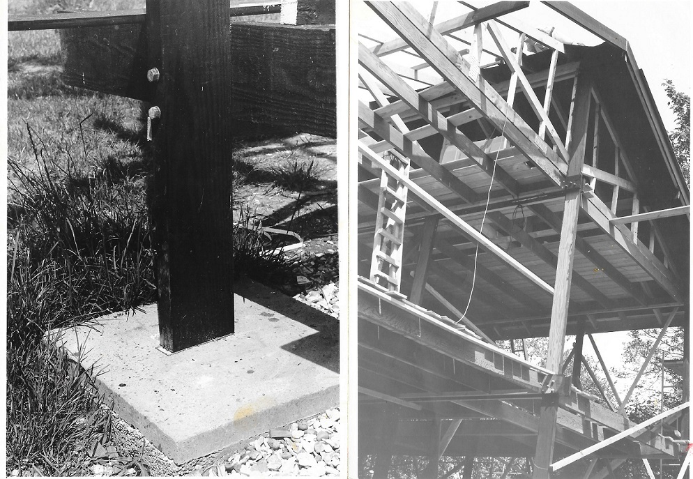

A sheet of lead between the oak and the floor will suffice.
This one we did in 1980 and still no signs of decay in any of the twenty Douglas Fir posts, The lead was slightly over size on this post.
Walter Segal method of building

I can fit lead plates under them. What's the theory behind that ?
I know for example that copper prevents moss growing on roofs.
Timber rots when air and water can get to the fibres. The most vulnerable point is the end grain where the timber has been cut. This is because timber has a natural mechanism for moving water along the grain to feed the growing tree. This mechanism still functions after the tree has been cut down and turned into building material.
The weight of the building causes the the lead to be pressed into the end grain of the timber making a water tight seal. and probably also air tight. Hence no moisture can get into the timber other than on the exposed surfaces. The exposed surfaces were treated with Sadolin to prevent water being absorbed.
