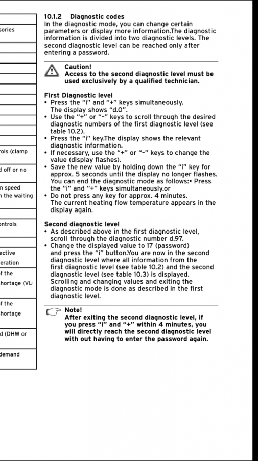

When it's working it's way uptown 50 initially, and then after 10 min or so after its stopped firing, push the "i" button and note down the code, s.05 s.08 etc etc periodically and report back.

I'll put money on an s.53 while its doing the very slowly cooling run, but will need you to confirm first
Ok, so the reason your getting the s.53 is that the boiler is not getting the minimum required amount of water flow rate through the main heat exchanger, so the temperature rise from the water entering the boiler to the water leaving the boiler is too high, S.53 is a low running mode when the boiler notices this, so it stays lit but only on its minimum rate.

You can manualy rate the boilers power down to suit the flow rate to prevent this, but the above information will give us a better picture what it needs rated to and if there are potentially any other issues causing it.

28kw heat only boiler running 12 rads is where your issue lies. Probably massively oversized for your requirements.
On the boiler you can push the two higher buttons at the display to take you to the D.codes (look at boiler instructions) you want to change D.0 to say 15kw to start with. Then try your heating as usual tonight, will find it s little slower to reach the 50*c mark but it should continue to climb till it his set temperature without the 40 min cooling period.
