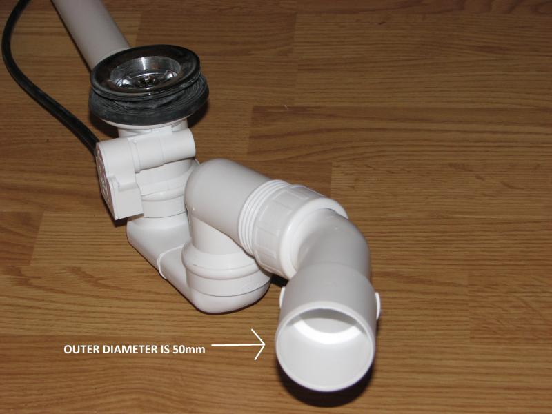

Odd sized bath trap waste outlet ?

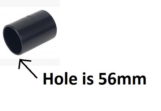

Solvent weld 50mm pipe actually has an outer diameter of 56mm.
This means a solvent weld straight coupling will have an internal diameter of 56mm
This fitting is exactly 50mm
So assuming I got it in centrally, there would be a 3mm gap all around. I would have thought that would to be too big a gap for the solvent to work its magic. Would you agree?
I've came across this thread searching for a solution to exactly this bath trap type. I pondered all the same solutions and all the suggestions here just wouldn't work as the parts are just not compatible.
Then I found the real answer. I phone the company that make the trap (Veiga) and talked to them. They told me that what you need is a Mcalpine Multifit-ISO connector. Bit of searching the McApline site uncovered part number Z28L-ISO and it fits nice and snug on the drain and 50mm solvent pipe. You also have the option to cut the 50mm end of the drain and use a 40mm ISO and pipe.
