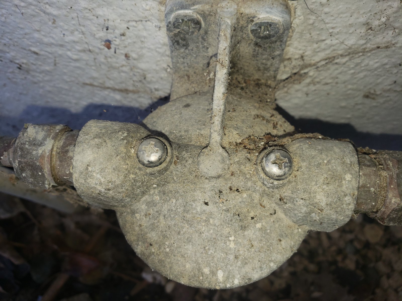

After my oil boiler began spitting out black smoke/soot which was 2 days after a recent kerosene (heating oil) top up I am getting the manufacturer (Worcester Bosch) on callout to clean the boiler. The boiler itself repeatedly gave error 9F 855 (probably airlock) and repeatedly cut out. The boiler and oil tank are 5 years old. The oil tank is oil bunded. I suspect that there is sediment in the oil tank.
Between the oil tank and boiler there is:
Oil Filter & Isolating Valve - 1" BSP TM x 10mm Comp ( 18392). AFV-1000 (standard filter bowl)
Biofuel Filter - 20 l/hr 1/4" BSP

And can someone identify what in line biofilter product is shown in the attached pic please? I think it is a 10-20 range micron in line filter similar to Biofuel Filter - 20 l/hr 1/4" BSP (https://www.bes.co.uk/biofuel-filter-20-l-hr-1-4-bsp-23490/). Thanks

Does your oil line disappear underground at any point. If it have a U shape because of underground section. It will gather water and crud in that oil pipe section.
Best undo pipe at boiler and tank. Get a compressor and air gun and blast the whole line out.
If you can blast the kero out, means one of your inline parts is faulty.
Don't rule out the fire valve, as they can become "lazy" and slide closed.

Worcester Bosch on callout did a dip check in the oil tank and said there was no oil. Fault was one of the oil burners that failed and caused soot to build up. Back up and working. I don't have an oil water separator installed but I did buy a tank sock.
Although I'm not OFTEC certified could I install an oil water separator myself? Far as I know the fittings are compression and don't seem that complicated. I am alright at fitting pipes. I did arrange for another OFTEC engineer on a separate job to fit some LPG piping but he never showed up. I think oil/gas plumbers won't show up unless it's a full day's work and I don't have enough work for them to bother.
