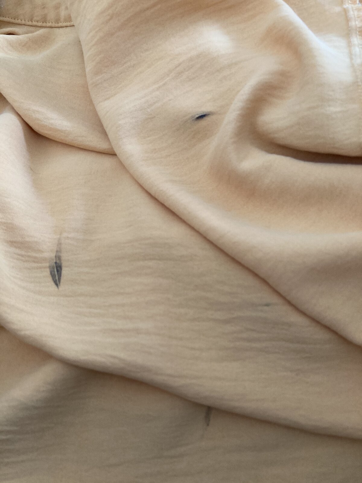

Dryer leaving oil type marks on light weight clothing. Domestic and General have been out twice and haven’t fixed it. Would I be as well buying a new dryer?

Do the stains match the colour of the door seal. Looks like the curtain has rubbed against something & smeared during rotation rather than something dropping on to the drying. If the stains match the door seal have D & G replaced it
Are they actually grease? Or dirt? Will they clean off with white sprit?
That sort of grease is common in washing machines when the drum bearing is worn out. I have not seen it in a drier before.
