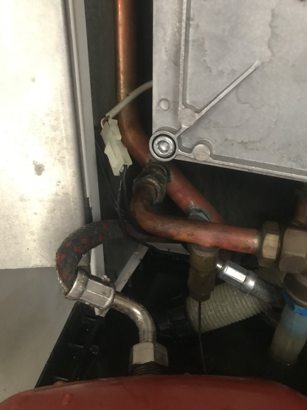

Ahh right , went to one last week , had a leak on the return pipe , wasn’t noticed until the whole void was filled with water and then blew the board lol I agree not a good picture , but do you see what I mean ?
By void I mean the whole tray underneath everything probs about 2/3 inches in depth
By the time they leak the ev has usually gone so I strip that joint down and replace what's left of the fibre washer with either liquid PTFE or Loctite 55.
Bloody stupid place to put an ev, but it's because the Dutch don't routinely put them in the boilers. So it was a compromise for the UK like the Rapid and the new Xtreme.
