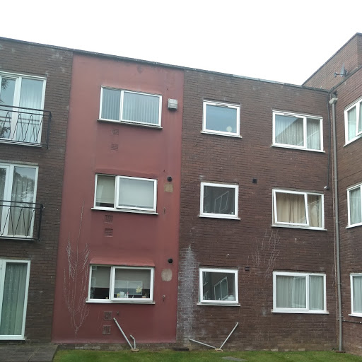

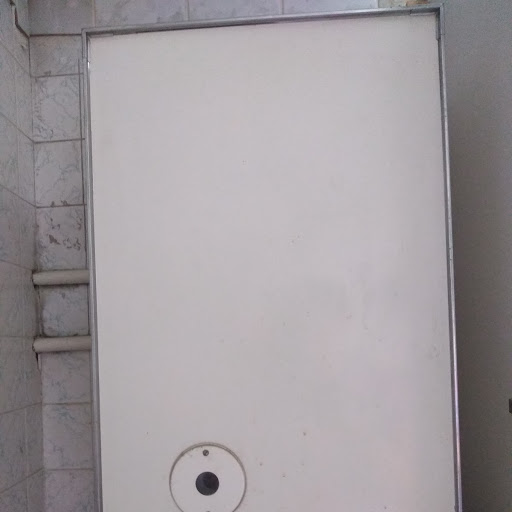

ok, had national co. in to give a quote for boiler replacement, not BG,
Old boiler, Spacesaver 38 mk1(vented) with square balanced flue on outside wall.
looking at Worcester system 12.
I asked the surveyor if they would drill a new hole for the flue and he said , no, just adjust existing flue hole.
bearing in mind the WB flue comes out from the top of the boiler I think that the new boiler would be too low, any thoughts?
thanks
Impossible to say as you've not said where it's going or provided any pictures. This is a common issue with big national installation companies however - they do the least amount of work in the shortest possible time to keep prices low and profits high. Better to use a reputable local installer who actually cares about such things
Thanks, boiler in kitchen 2nd floor up, outside pic top flat, I get your point about keep prices low, profits high, they were also charging for scaffolding but then not bothering to cut a new flue hole

Well I still can't say whether the new one would be too low or not because I can't see what's below the existing one.
Sorry, bad pic, the old boiler is about 15" above kitchen worktop, the new one would be just a few inches from worktop
That's a good idea but the WB 12i can take 15m gas feed, don't think there are that many boilers 12kw, most seem to start at 15, then possibly have to upgrade piping to 22m.
We had a similar situation - new flue above old one, old hole was bricked up to match brickwork. Your problem is being on the third floor.
Have the two flats below yours had their boilers replaced ? Strange square white patches on the wall ?

cut a sheet of ply the same size as the boiler, then fix the new boiler to that sheet, cut a new flue hole above the existing one, then brick it up from outside.
