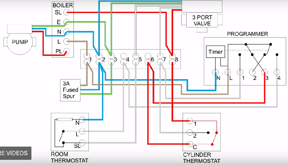

As I said in my last E-mail I have removed the 3-Port motor, then activated the micro switches in both closed and open positions, this did not operate the pump. which suggests, together with my multi meter testing of the switches this is not the problem. I have been doing further research on the net and came across this site https://www.flameport.com/electric/central_heating/heating_wiring_Y_plan.cs4. What an amazing site, fantastic graphics. According to this guy, the pump is switched on and off by the boiler, but it's not clear to me how this is done. I'm going to try and find where the pump gets it supply, but since the pump is up stairs and the boiler is in the kitchen it will not be easy to check for continuity.
Older systems had the boiler and pump switched by the actuators micro-switches, both in parallel, both ran simultaneously.
More recently, they changed this to letting the boiler itself control the pump - that allowed the pump to be run after the boiler had switched off, to remove residual heat from the boiler. The pump runs-on for a couple of minutes, after the boiler has shut down.
He has quite recently modified that diagram to reflect that fact. On older systems, what is marked as PL, would simply be connected to the one marked SL. There is another website which discusses at length the problems of unreliability of three port actuators.
