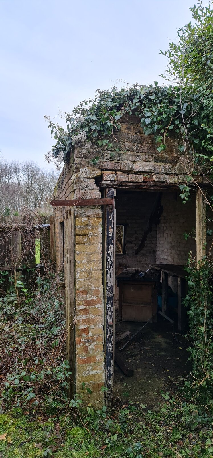

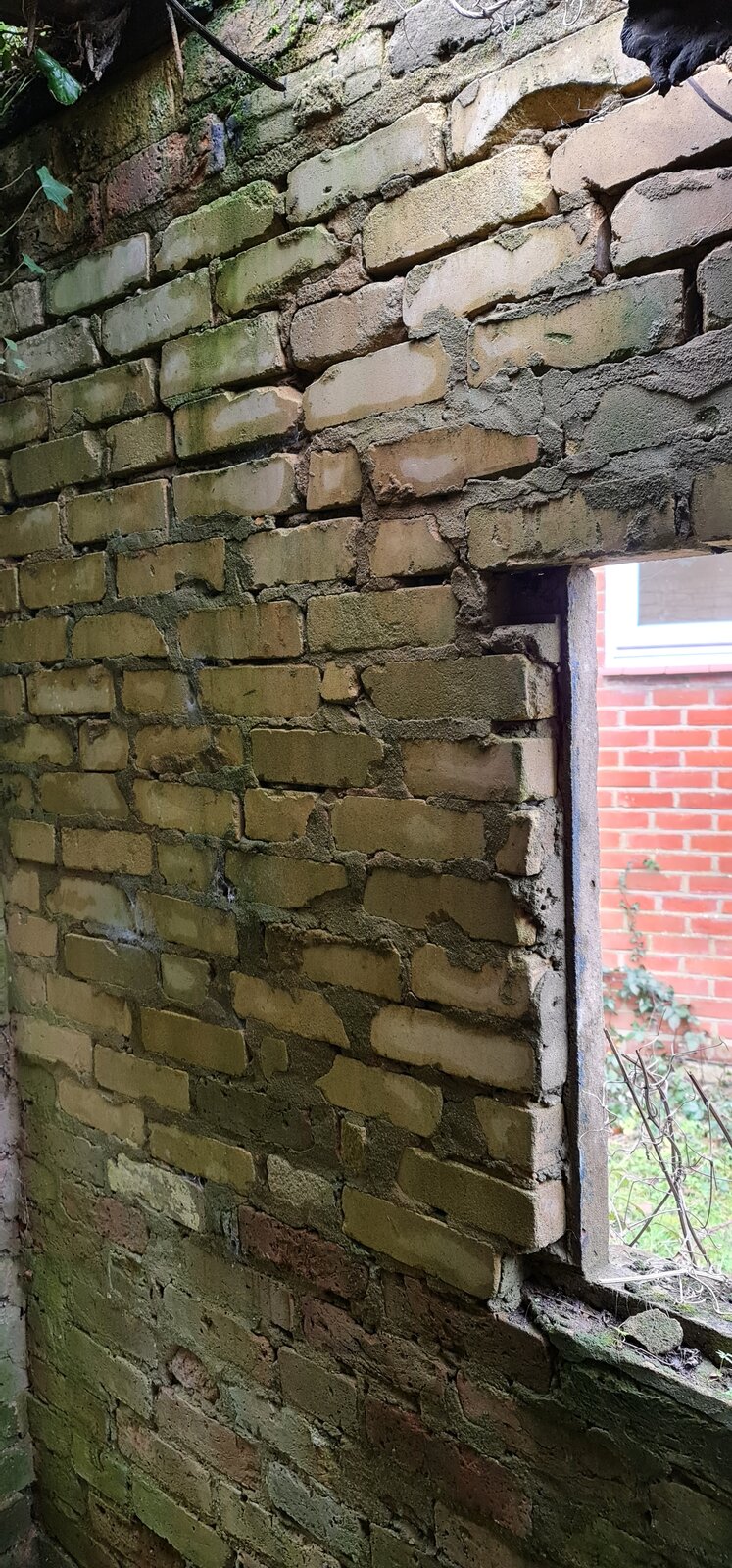

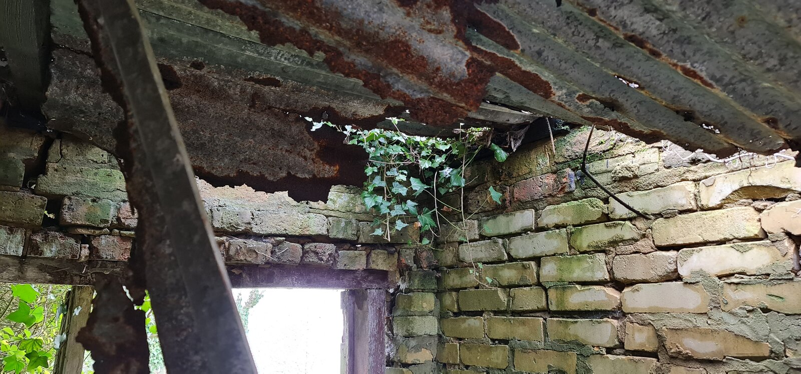

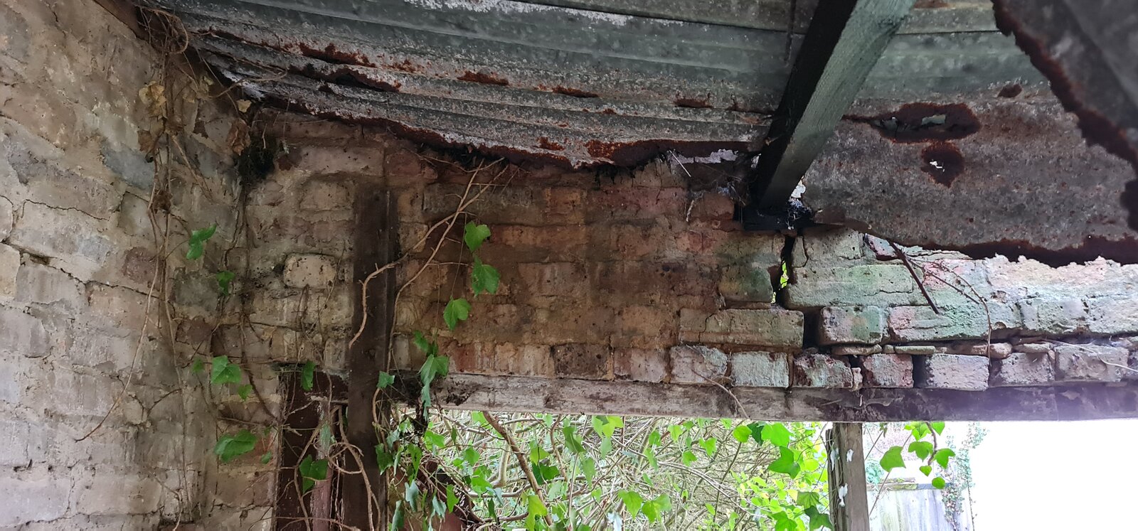

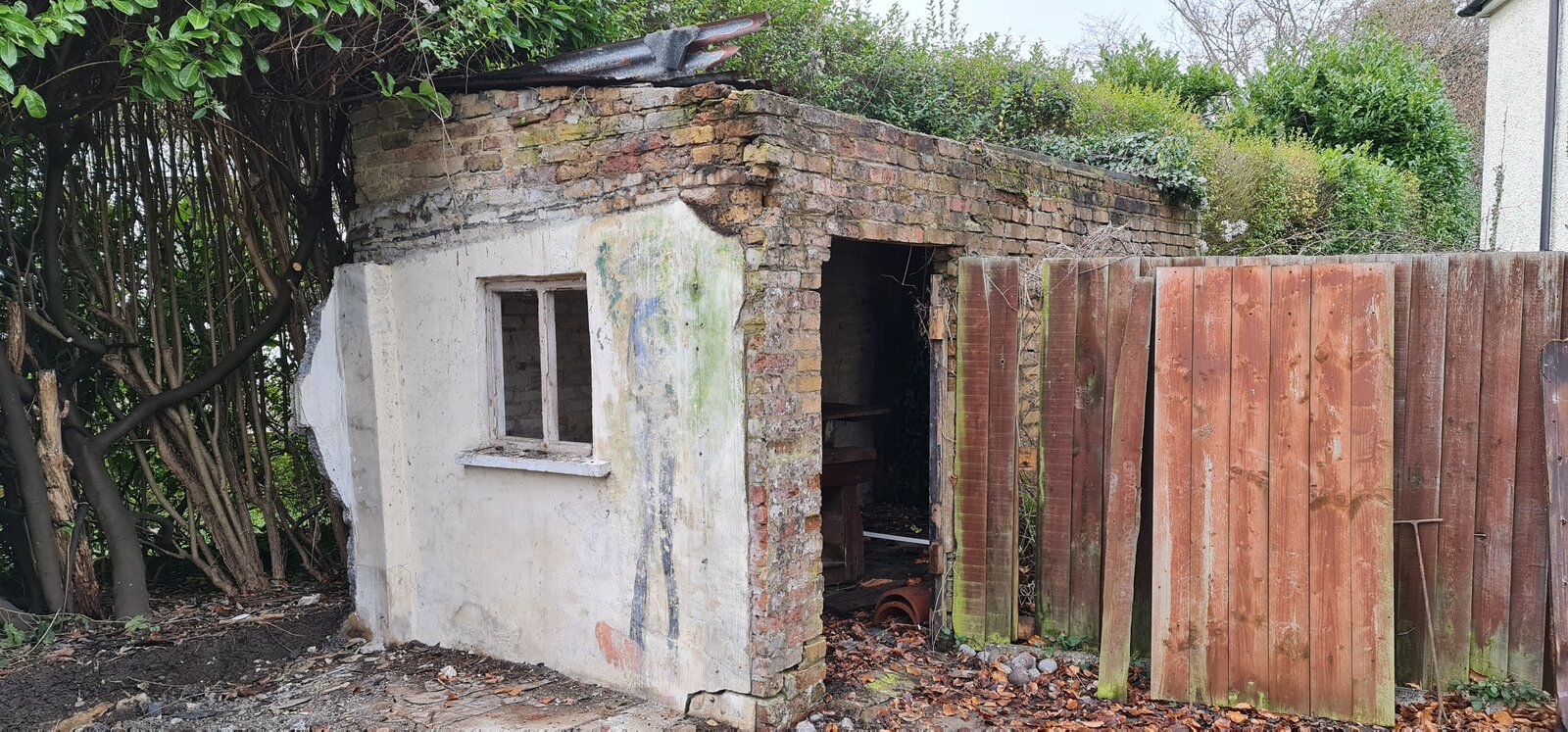

Hi all,
My 1917 house came with two 15' x 8' outbuildings sharing a common end wall. Thus I had a 30' x 8' structure (which was great for 1948 footprint calculations).
One half had an asbestos cement roof and was collapsing after suffering from a laburnam tree that had got too big and was too close. This building is now demolished and the (now quadruple-wrapped) asbestos cement is awaiting a trip to the Council Recycling centre.
The other half has a collapsing corrugated rust overlaid-with-roofing-felt roof, a nice flat-looking floor and some of the walls look quite solid. But some of them very much do NOT
20210118_132651.jpg 20210118_132653.jpg 20210118_132651.jpg 20210118_132653.jpg 20210118_132658.jpg 20210118_132805.jpg
Is this salvageable? I am not sufficiently skilled to do this myself, but is this something that a brickie would do and how much am I likely to pay? Down the road I intend have the outside rendered to match the main house, so I am not concerned about the aesthetics.
Regards
Tet
From what I can see, I would be tempted to demolish and rebuild, incorporating the space into the ground floor if possible.
Probably salvageable, except the bit over the window.
But depending on its intended use, you might as well demolish and rebuild.
If you're intent on rendering, rebuild it in block.
I think the cost could be higher to refurbish rather than rebuild.
It's single skin with probably no DPM or DPC....so damp would be difficult to solve.
A new structure could be blockwork or timber frame, both can be rendered.
Im not sure on planning or building regs without more info.
