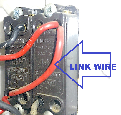

Firstly, please tell us if the two lights are on the same circuit. That is - do they both stop working when one breaker is switched off (or one fuse is removed)?
IF that is the case, then remove the link wire and tell us if both lights still work.

I'm sorry but which one is the link wire in my case !!??

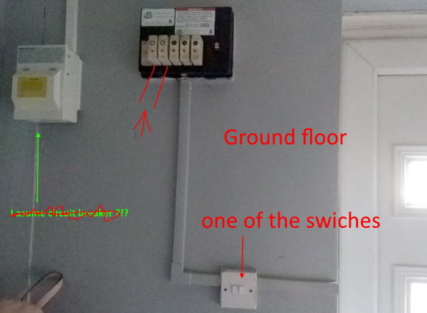

No, I meant a fuse or a circuit breaker in the consumer unit.
However, I'm lost.

What you say the switches do does not match the wiring you have in the pictured switch.
The short red wire that links the two red wires from the cables.

Those switches are not wired for 2way use.

This might sound stupid but do you have to move both switches simultaneously to effect the two location ON or OFF function. In other words are you using two adjacent switches as a single intermediate switch.
Edit : Now that he has admitted to altering the wiring and showing an invalid photograph, this question is no longer relevant. The original wiring submission was as shown in reply #21 which clearly did not provide intermediate switching capability

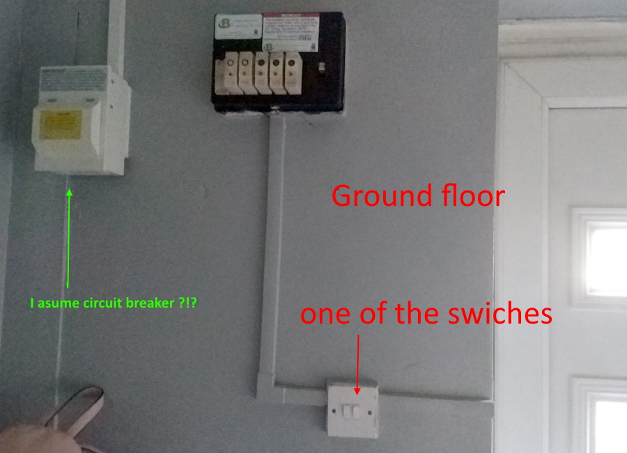

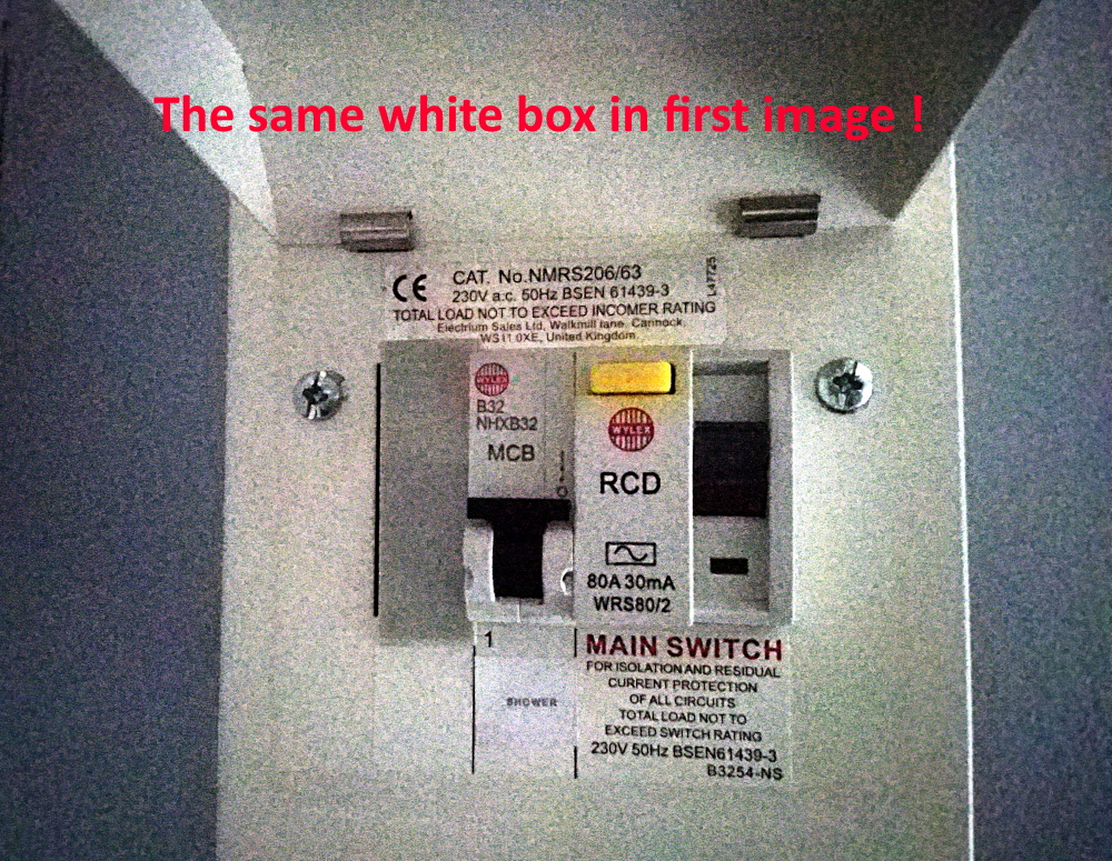

probably you talking about this white box ?!?
No.

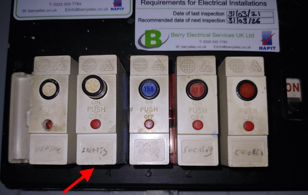

One of these circuit breakers with the white buttons.
Switch off by pressing the little button under the white one.
Press the white one back in to turn on again,
Does one of them off stop both lights working?

No.
Does one of them off stop both lights working?...
20210525_131913.jpg Yes, when I pressed on the small red button all lights went off in the house !! obviously, i still had electricity! so as you said that's for bulbs only !!
