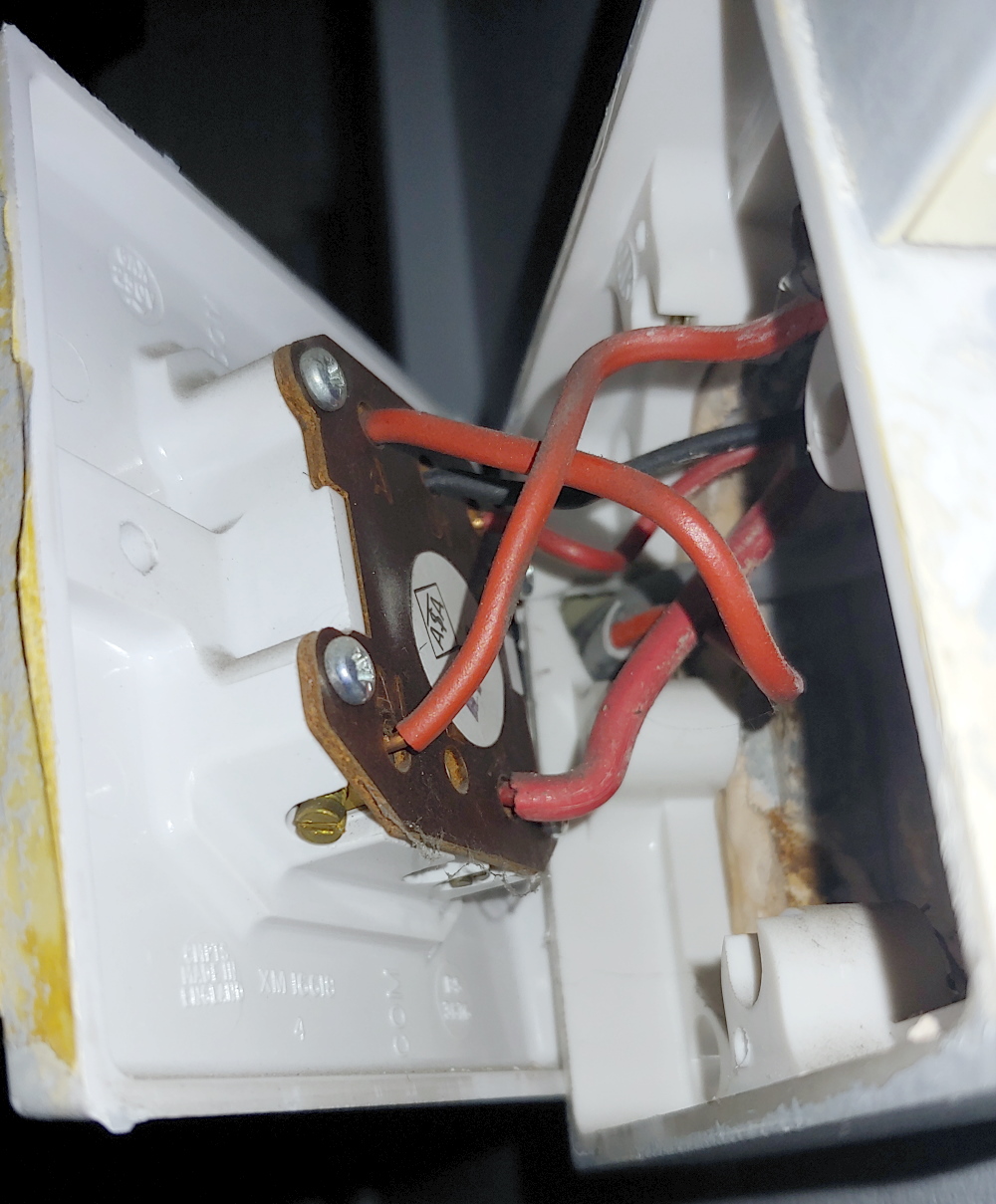

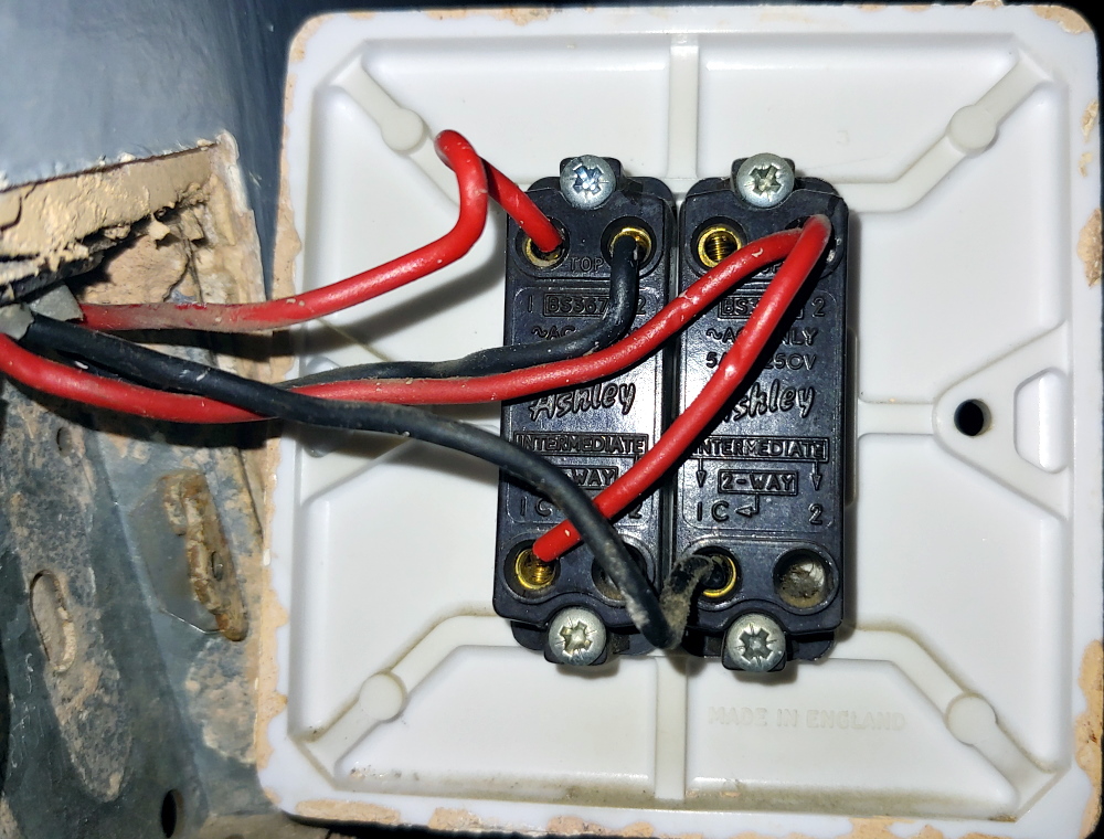

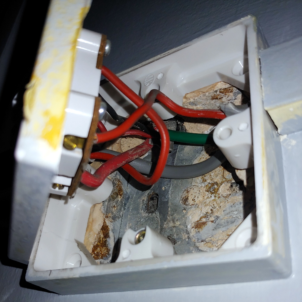

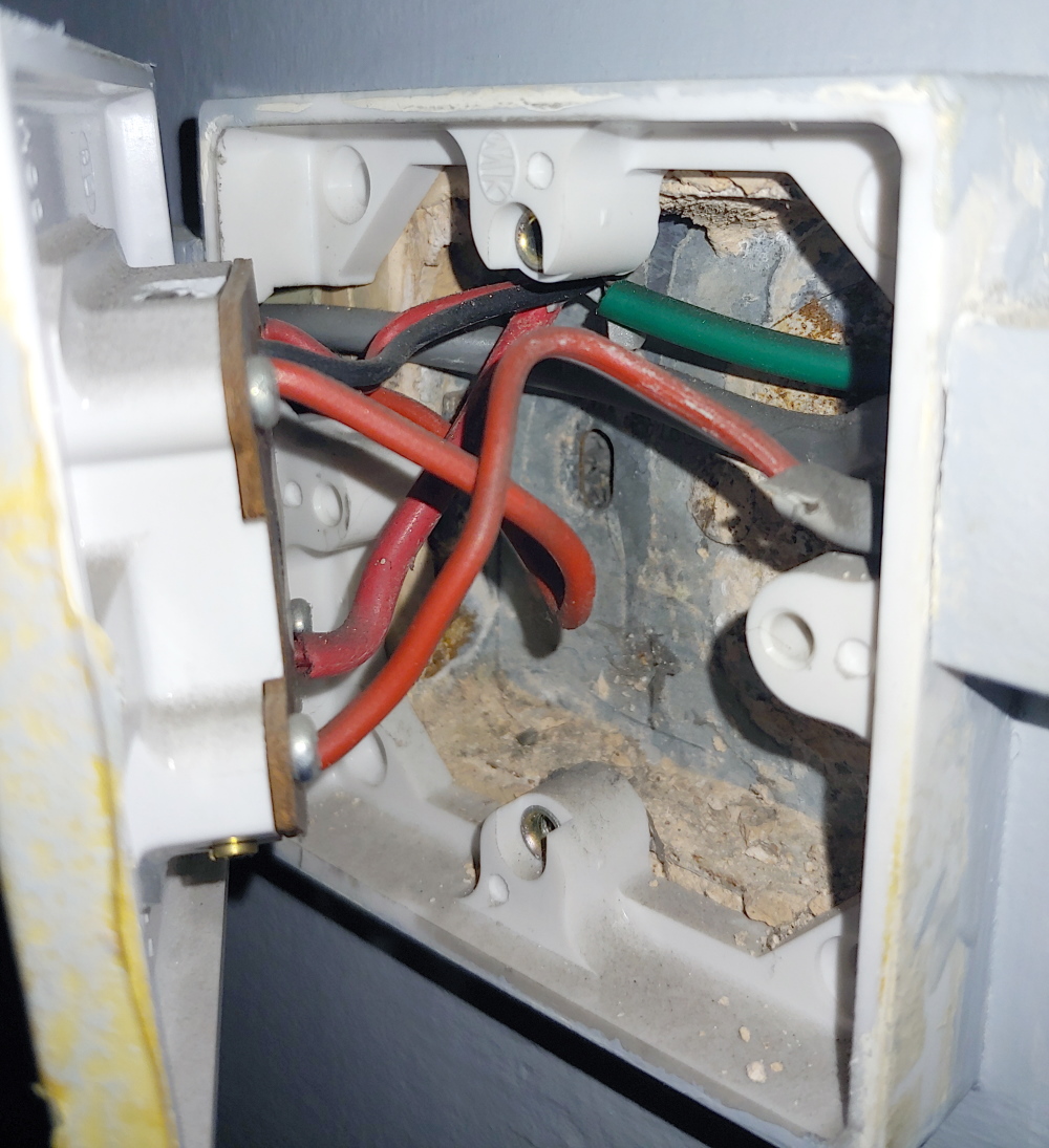

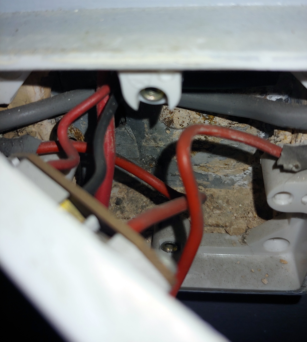

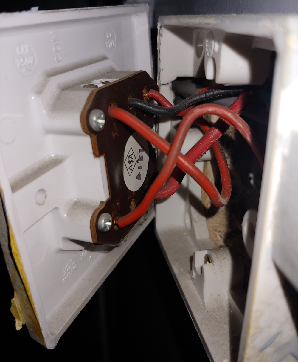

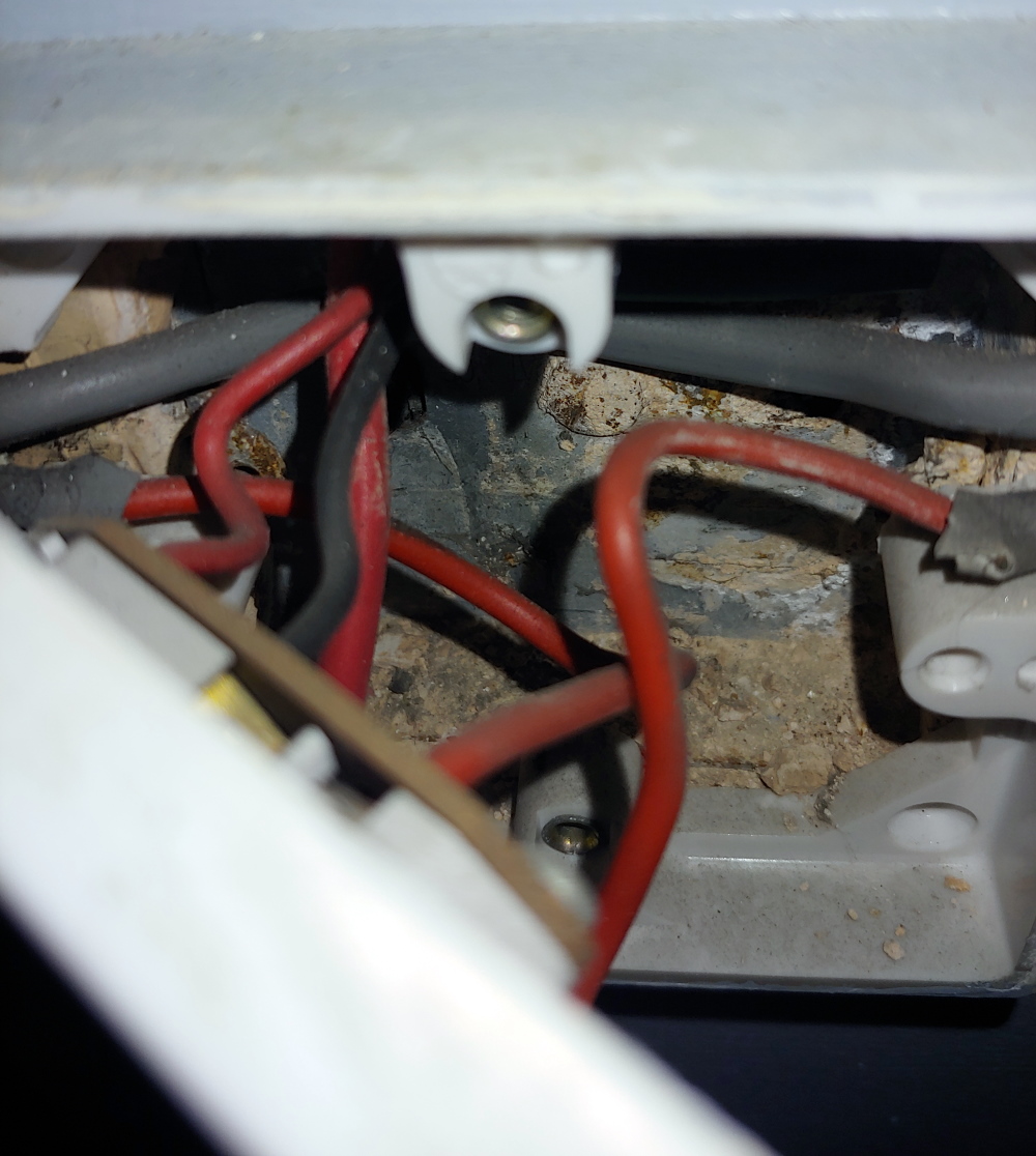

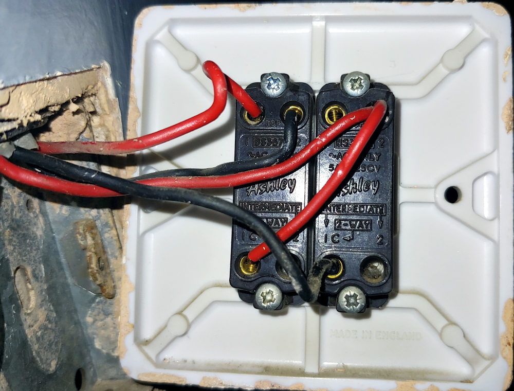

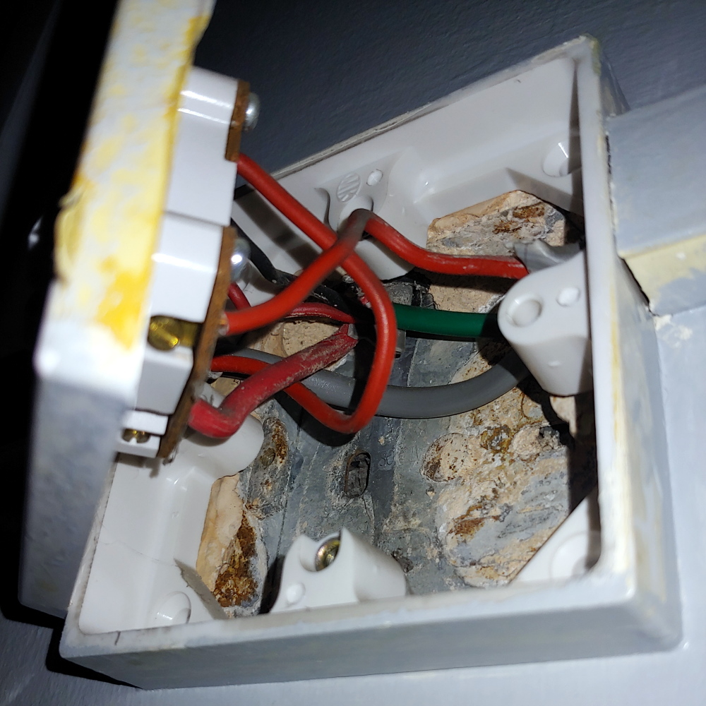

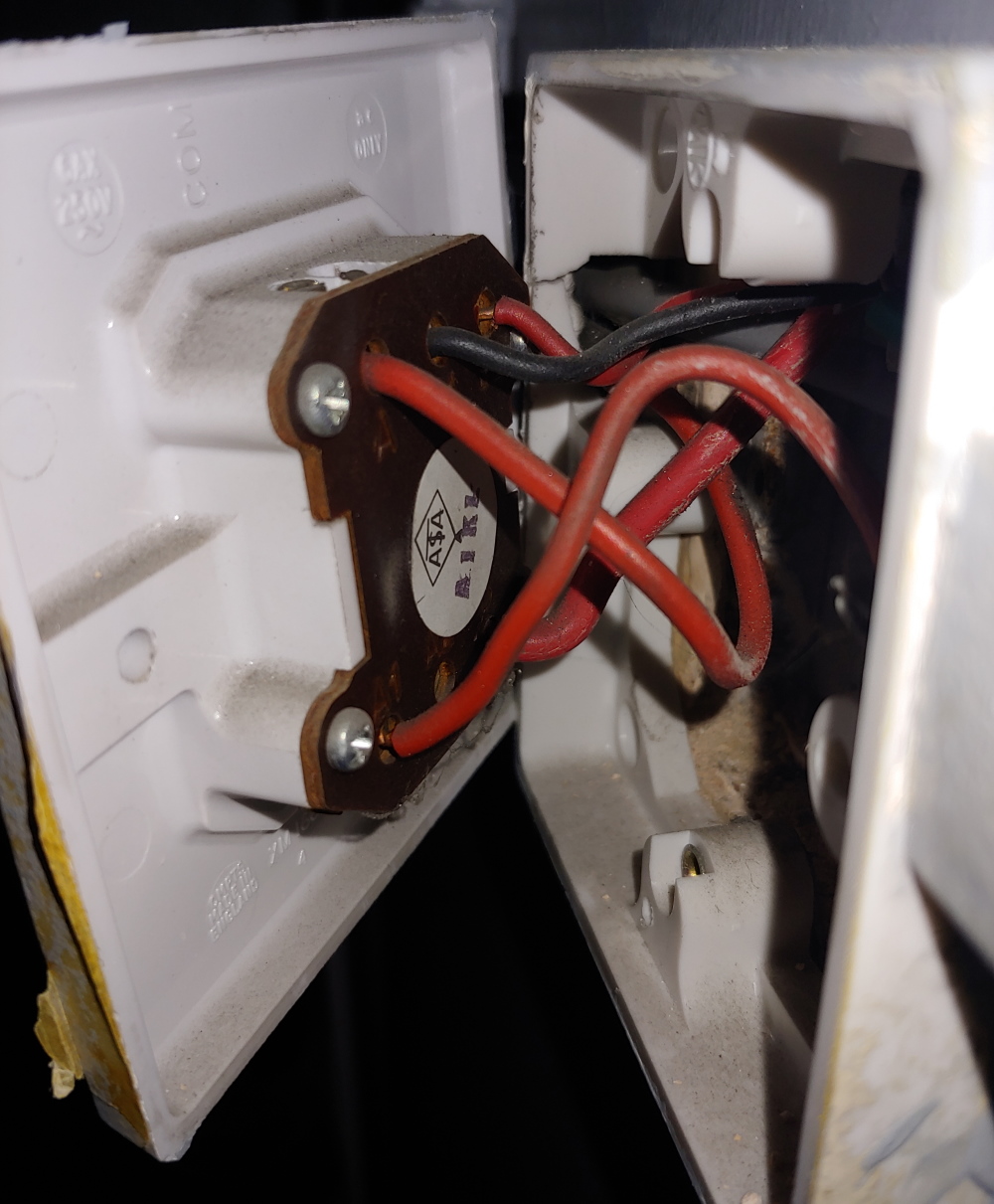

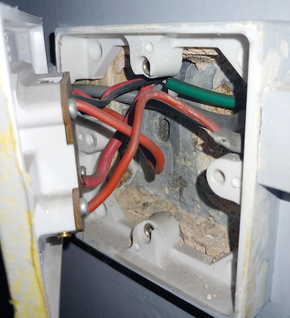

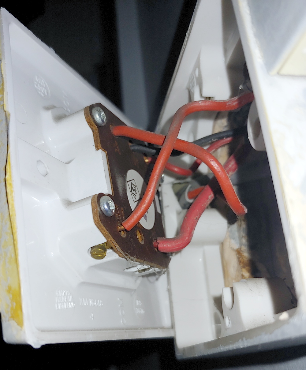

......Also could you supply a picture of the wiring in the latest switch please.
Sorry I couldn't pull it out more!!!
20210525_132951.jpg 20210525_133016.jpg 20210525_133059.jpg 20210525_133123.jpg 20210525_133134.jpg
Sorry guys I made a mistake !!! this is the correct connection !!View attachment 234658
Ah that make a lot of difference.
At that point I have not enough experience with this type of device so I ll hand over to other with experience. But I'm still happy to work out wiring to get a neutral.
EDIT: I hadn't seen your other replies when I posted, that all looks very much as expected. In fact getting a neutral may be very easy but it could mean working in the consumer unit.
That's getting very complicated !!! :eek:
Maybe not, I simply have not got involved with these sort of switches, many others have and they can offer working experience which I don't have.
To clarify this, I've installed a number of this sort of switch but not commissioned them (fitted before power was available) so I don't know the facilities offered ie for 2way switching.
For me, it's not a problem to fix basic things but this one is on a different level !! :D:rolleyes:
The metal box in the wall is only 16mm depth, the new touch switch won't physically fit into that.
