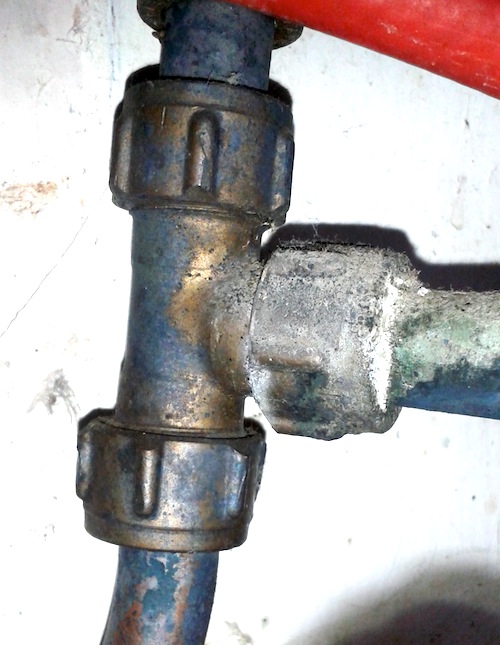

Hiya,
I need to put a stop cap/end on one of this old elbows.
What I would like to know is by looking at the picture, does anyone one knows if I could get a stop cap with this kind of old elbow?
Btw the pipe size is 15mm.
Cheers!

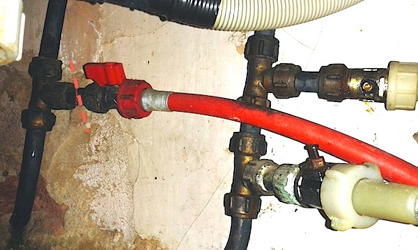

Oops.. sorry. Ya it's a tee.
Btw I need to remove the hot water, it connects to the washing machine.
The easiest solution is to remove the valve, and use the cap section of the cap suggested by 45 years above. Pendants will call this a dead leg, which is true, but I, personally, would not worry about it.
I will await flak:).
Terry, I 'm not sure if you are being sarcy?:cry:

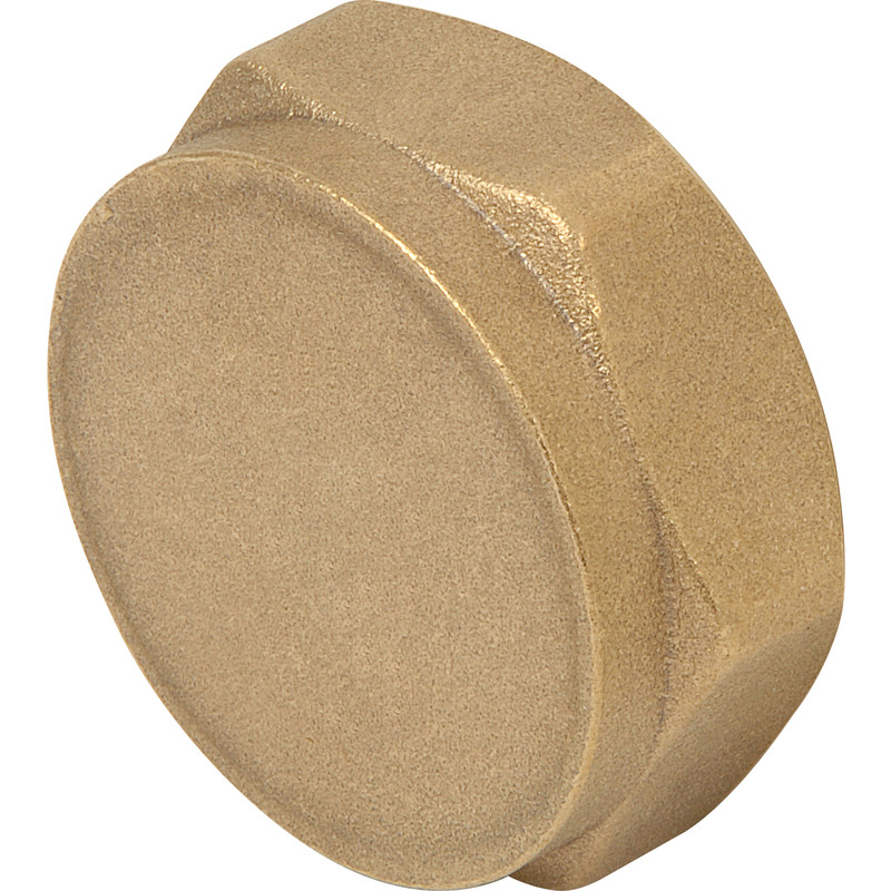

Get a 3/4" one of these
shopping
or a 3/4" one of these with a rubber washer inside
shopping
and bang it on the end of the valve, after turning it off and taking the pipe off of course.
