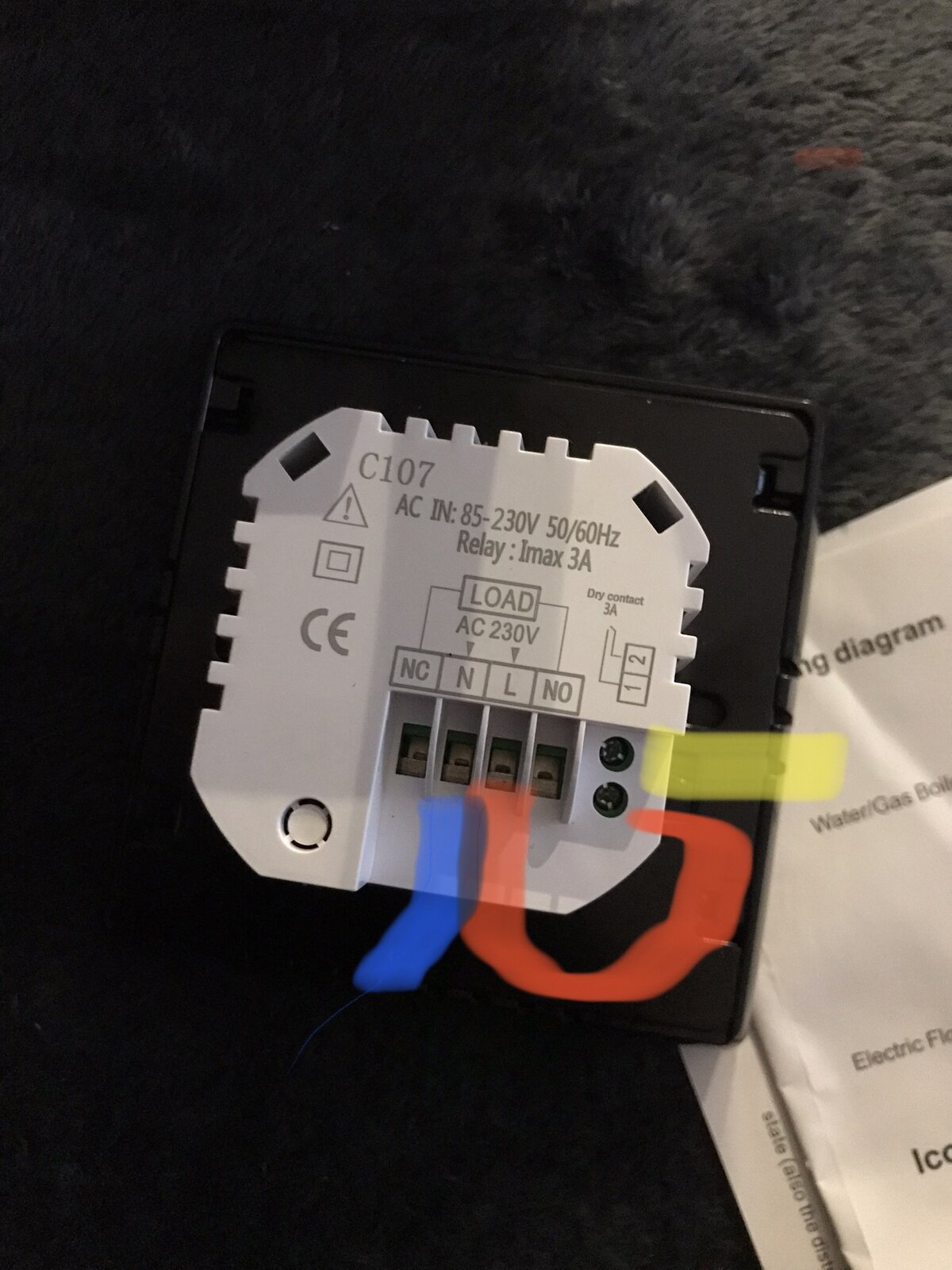

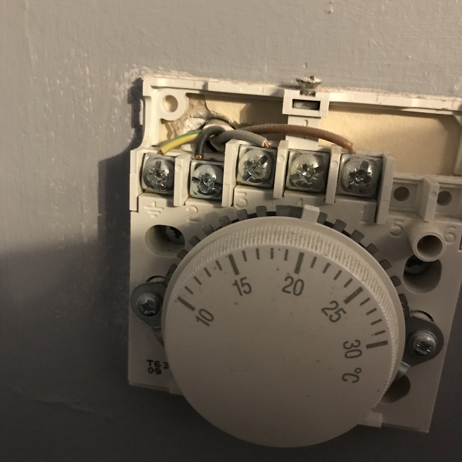

Hi I want to change my old Honeywell thermostat to a new digital wifi one
I am correct that the wiring goes as follows
Live to live
N to N
Link from live to dry contact 1
And switch wire to dry contact 2
Just want to make sure before I go ahead

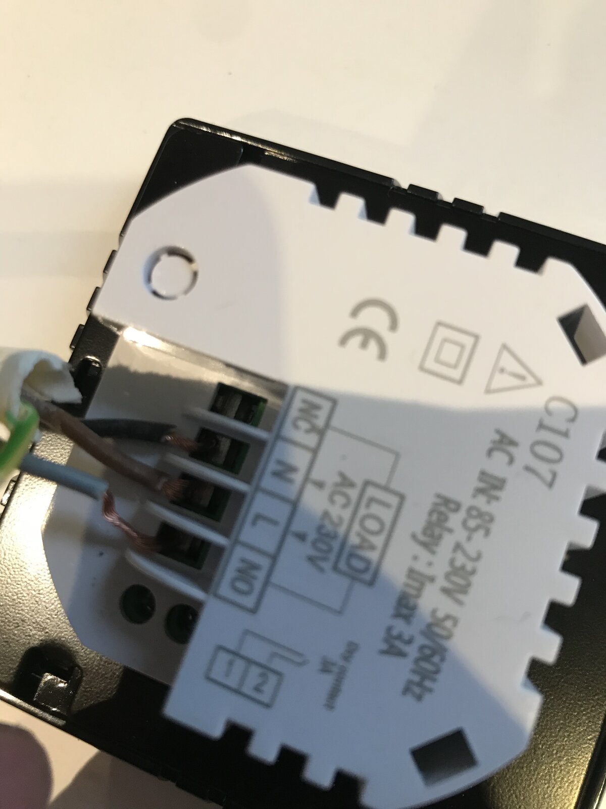

Ok yea connected switch to No working great
