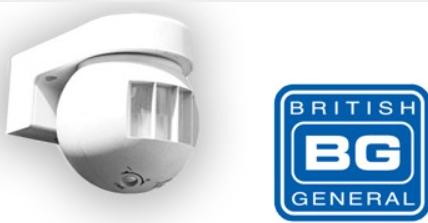

Getting my lad to replace some lamps at his Granny's, which are several old school PIRs feeding Aluminium and glass ES bulkheads.
The bulkheads had 100W ES Thorn GLS lamps in, but they have all popped off one by one.
I have an old school PIR (built to control TH loads when LED wasn't a thing) at home controlling a coach lantern with one LED GLS.
Seems to work great every time.
I guess there shouldn't be any issues? I can't find any spec for them to check the loads.
The PIRs are visually like these, but not sure if they are BG brand.

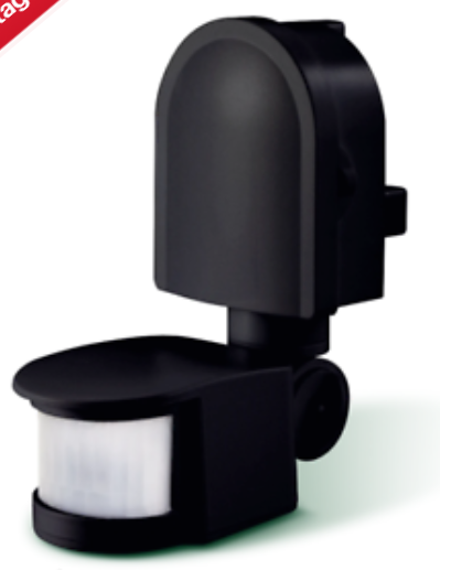

True, but I don't think any "old school" PIRs did that, did they? Apart from anything else, as I said, they did their switching with a relay, and I doubt that they would have been able to get enough current 'by leakage through the load" to power a relay.
In fact, even 'later', whilst "no neutral" dimmers etc. became quite common, I'm not sure that I've seen a PIR that tried that approach. Ones such as secure illustrated certainly don't.

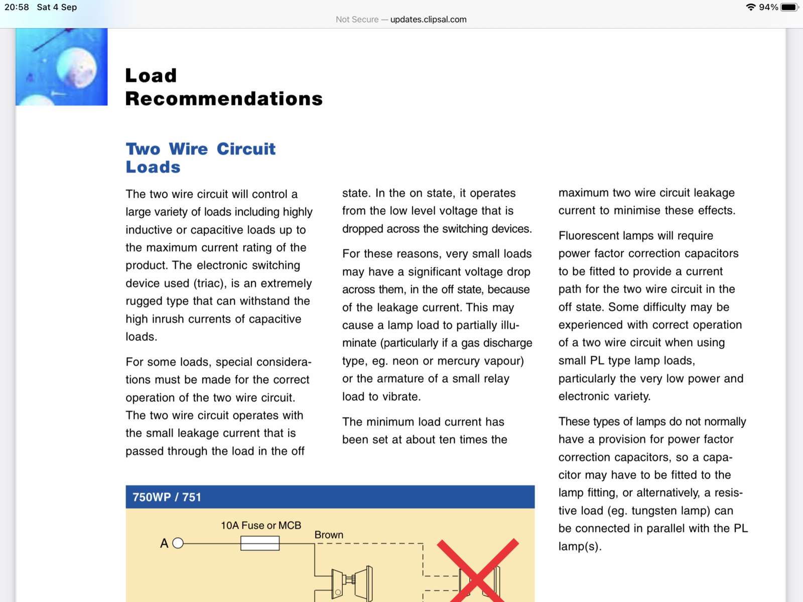

I have heard of, but not actually used, "no neutral" PIR sensors. As suggested, I suspect they would either not work, or make the light glow all the time, or make the light flash, if used with a low power lamp such as an LED.
Agreed, just as with 'no neutral' dimmers etc. However, I suspect that they only exist as the type designed to replace light switches and, as I said, not in the sort of stand-alone PIRs that secure illustrated. I've used a good few of them, and certainly have never come across a 'no neutral' one. In fact, in the way they are usually/commonly used/connected, the controlled light is usually fed from the PIR unit, so that unit obviously has to have a neutral.
Kind Regards, John
<a bit of the Clipsal 750 range PIRs>

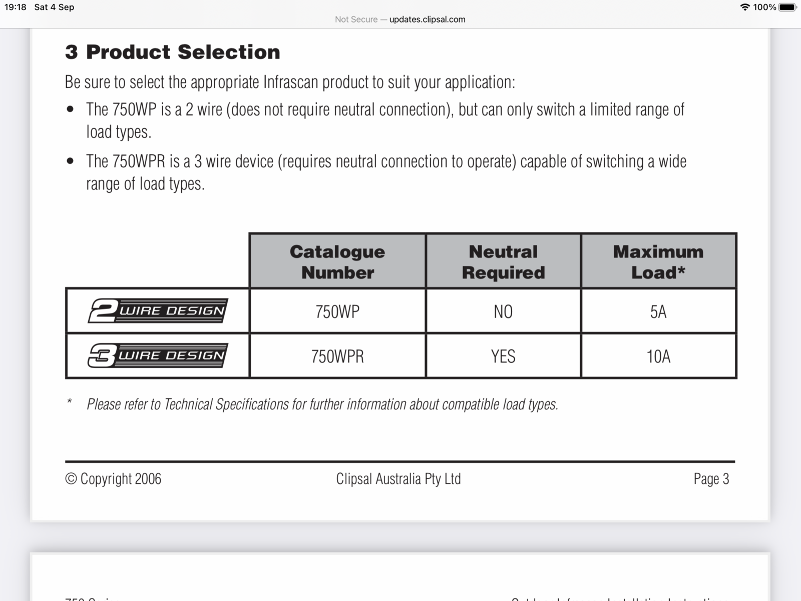

Fair enough - but what the bit of the manual you posted doesn't tell us is (in context) the important bit about the minimum load for the (no-neutral') 750WP, which it appears is 40W (far to high to work with most LEDs).
Kind Regards, John

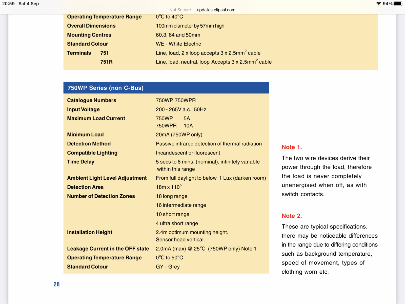

<more bits of the Clipsal 750 range PIRs manual>
I wonder how long ago that was written? - it seems a little surprising that a whole page of text about 'low lighting loads' does not even mention LEDs!
I also wonder how the 'minimum load current' of 20mA in the bit you've just posted sits with the 'minimum load' of 40W (about 174mA at 230V) in the bit I posted!
Kind Regards, John
