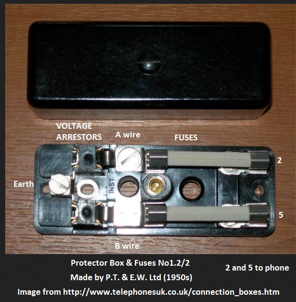

Possible an "earTh for an overhead telephone line Protector Terminal Box
In the good old days overhead telepone lines has fuses and transient voltage suppressors fitted where the cable entered the house. These required a thin cable to ground. Party Line telephones ( two subscribers, different numbers but sharing the same copper pair ) needed an earth for signallong to the exchange which subscriber wanted to make a call.

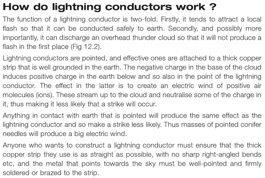

If an aerial was struck, would the wiring have done any good?
The wire would vapourise very quickly as the discharge current built up and the metal vapour might then create a path for a plasma discharge along the route of the wire and thus outside the building.
Absolutely - it would have done the strike good, insofar as it would have helped it happen by taking an earthed pointy thing closer to the clouds.

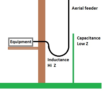

Any bend in a lightning conductor oresents a high impedance to the rapidly rising and falling currents in the strike. This high impedance creates a voltage spike which can cause the current to jump to a near by conductor.
A loop in the aerial feeder and a gounded plate next to the loop is believed to be an effective way to protect equipment inside the equipment room.
I assume the insulation needs to be removed from the black, near the green earth for the current to jump across
Yes this is something that used to appear in publications but I don't recall seeing it in recent times, it's not applied on any of the aerial masts I've worked on, however the feeders are bonded to the mast or some other point of the earth arrangements at the aerial, at the point it leaves mast towards the cabin and at the point it enters the cabin, commonly into a gland plate. Additional bonds are used if the mast is particularly tall.
The lightning conductors on buildings would have typically been formed into curves when rods were used to go from, say, a horizontal run to vertical but now with the flat bar they just cut and clamp together at right angles.
These are my observations and not 'the rules', which may be two very different things.
