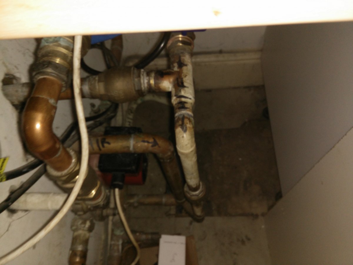

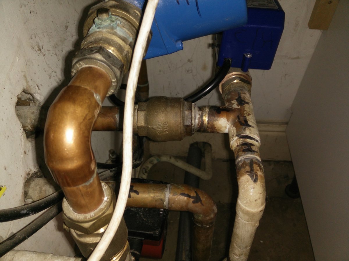

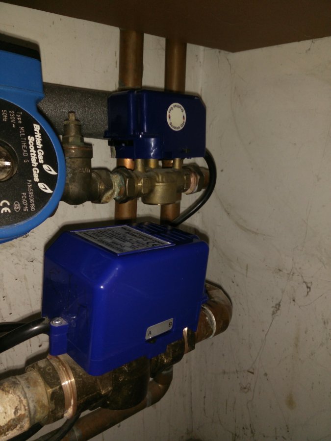

Here are some photos. It's a constrained space but I hope you can see what's going on.
220231 is quite good. The red pump is for the central heating, the blue for HW. You can see the flow for the central heating splitting into the two radiator circuits.
In 215639 you can see at the top of the picture the cold going to the boiler on the right and the hot coming back on the left.
I'm pretty sure that the diagram I also posted is correct.
