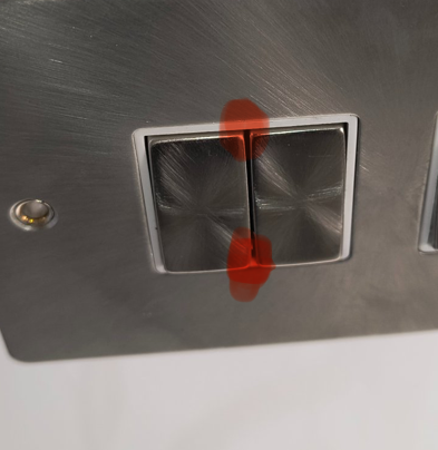

I've got a 4 gang switch but only 3 circuits (I couldn't find a double 3 gang that came close to matching all the others.
Is it possible to link 2 switches so that at least all 4 switches do something? I suspect not?
Al circuits are 2 way switched if it matters.

Some confusion in terms, but -
Wouldn't a double 3 gang be 6 gang?
Technically probably all the one circuit.
Yes, but what do you want the extra one to do?
Not really.
Otherwise - leave one doing nothing?
Fit another light somewhere.
Thanks. Hopefully the picture of the switch in question will supplement my poor terminology.
No additional lights needed.
I want the second left switch to operate the same light as the first left so it doesn't matter which you press - just because it'll annoy me if it does nothing.
I suppose I could just super glue the rockers together.
Trying to use what I've got. With hindsight I should have got two switches and one of these-
You would need to change a module to an intermediate for what you want to work. Frankly it would be a daft thing to do.

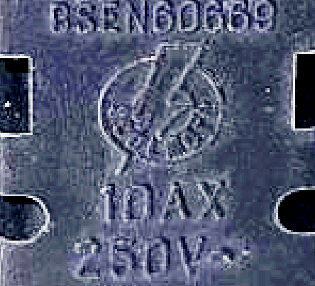

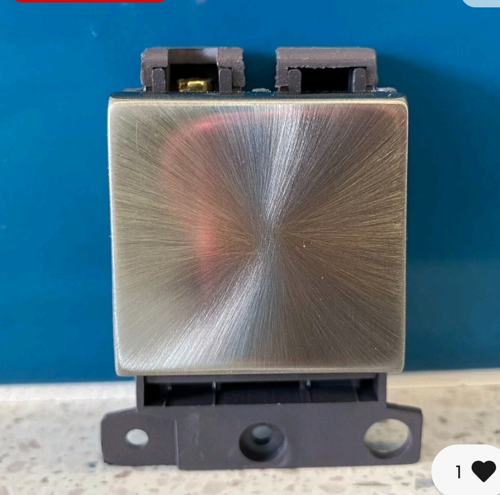

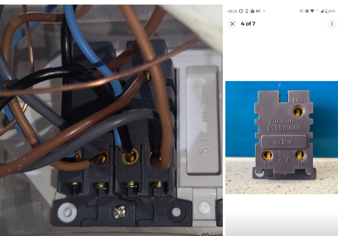

That looks like Scholmore Click stuff, if so it's possible to replace one of the switches with a blank, or possiblly to transfer all the switches to a 3-module plate (though personally I think the 3 module plates for double boxes look a bit weird).
IF you can tell us the part number of the switch, I can figure out which the correct parts are to match.
Thanks. It does look extremely similar to scolmore but there's no branding on it - I wonder if it's a copy/made under license type thing.
Only part number is sw31022.3
Looks like they sell a double width switch that certainly looks like a swap.
Looking back at your first picture, I see a logo in the middle of the switch modules, I think it says scholmore in curved text, but I can't be 100% sure.
It does look very likely but, as you say, one can't be certain. However, I would imagine that it would be easy to read for someone actually looking at the switch ...
