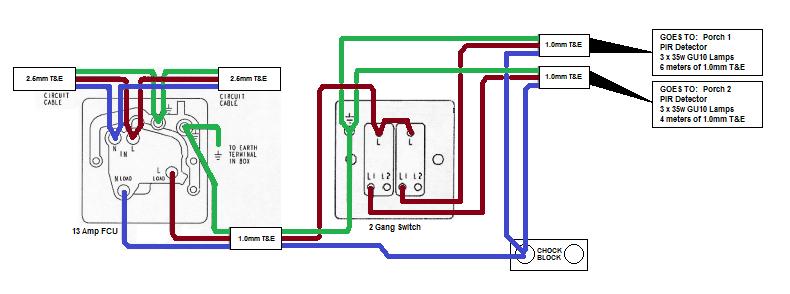

At present, the front porch lights use the FCU as their functional switch. However, she now wants the front and side porch to have their own independent switch. I don't like the idea of sticking another FCU in, so is it possible for me to use a 2-gang switch (coming off the single FCU) to control the two sets of porch lights?
I'm assuming this is OK?
Both porches have similar cable lengths, similar PIR switching capacity and a similar total demand (105w or 0.43 amps).
If this is acceptable, could somebody take a look at the switching diagram I've drawn below and tell me if it's correct? I've deduced the layout from other threads but would prefer someone more experienced to give me the nod... or cruelly mock me.

That will work.
Is the FCU really part of a ring or should it be shown as a spur ?
Do you really want to have a double switch ? It's more common to have the switch adjacent to the area it covers, as a double it means the side porch switch will be remote from the area it covers- although I accept the PIR will do the main on / off via routine time and light setting.
TE isn't external cable, how will you route it ?

In answer to your question: the main feed is currently a spur, but given the ease of access to the void, I'm thinking about re-wiring a stretch and build it into the ring. No great shakes.
I take your point about switch location (I anticipated someone might say that), but the layout of the house means that the switch is fairly central between the two doors. Hard to explain without a diagram. And as you say, the PIR switches as soon as the door is opened.
Routing of 1.0 T&E will be mostly via under the floorboards of the first floor. Getting there is not a problem as the hall will be skimmed with plaster at a later date.
