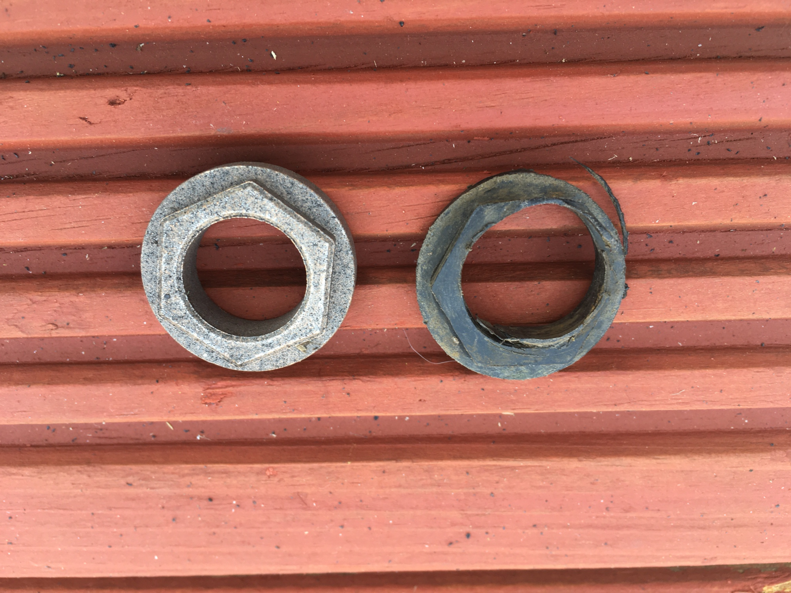

I replaced that with a slightly more compact twin bladed MTD Lawnflite. That is suffering from wear on the bottom steering bush, for the bottom end of the steering shaft where the pinion meshes with the steering quadrant. Try to turn left - the steering wheel just forces the pinion to just click out of mesh so the tractor goes straight on. I am having to plan my cutting to only make only right turns :-)
The bush is only like a large, thin hexagon, where it locates in the chassis, bored out to 5/8". I did think to make one on the lathe, but found they were only £4 so ordered one a couple of weeks ago and waited for delivery from a UK stockist - I'm still waiting for promised 7 day delivery. I ordered some electronics from China, the day after and tracking shows that is already in UK Customs.

The bush arrived at last, this morning. So I took the cutting deck off, got it jack up enough to get under and investigate it properly. The shaft was very sloppy, but not much wear on the pinion and none on the quadrant it drives, to turn the wheels. Taking the pinion off to get at the bush, I noticed I wasn't the first to go in there - someone had fitted a thick large washer in the past, in there attempts to maybe sort the steering slip out before. The bush fits / just drops in the chassis member from above with panels an inch above it. Pushed up and out, thinking it was steel like the new bush, I tried to fish the old one out with a magnet on a stick - it didn't work, it was a plastic bush. I eventually fished it out with a bit of wire.
Rather than risk loosing the new bush in the chassis, I fished a bit of string through between chassis and panel, then out through the hole, put the bush on the string, then made it into a loop. A bit of fiddling about and I managed to get the bush near enough to the hole, to catch it with some small hooks and pull it down into place in the hole. A bit of grease, then I dropped the steering shaft back in place through bush, refitted the pinion, the nut and tightened it up - which locked up the steering solidly :-(
After a bit of checking and measuring, I realised the new steel bush was thicker than the plastic one which I had taken out. Instead of the pinion nut tightening against a shoulder on the shaft, it was tightening against the new bush instead and locking it all up. So I took the pinion back off, popped it in the lathe and ground a couple of mm off one face of it. All seems fine now, I just need to drop it down on the ground, and refit the cutting deck.
New on the left, worn out old on the right....
