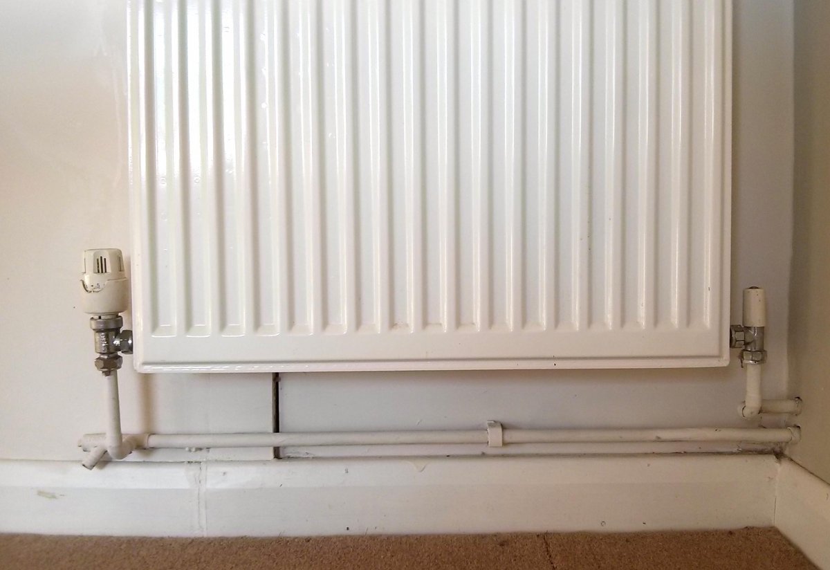

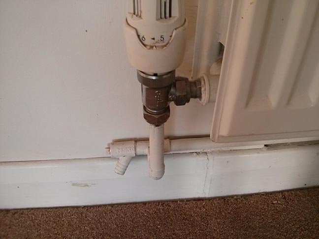

A few images showing ones that have been added after original installation I would think, together with pic of a TCV and drain 'tap' (can i drain whole system from here?)
I need to go under house again and will see how they have taken the 2 rads pictured from circuit
That doesn't look like a one pipe system. With a one pipe system, the rads all sit on erm...one pipe that runs around in a loop, like this
For comparison, a twin pipe has two pipes that supply the radiators. The clue is in the name.
Thanks. Yes, I get all that but I believe the two pictured are bad examples/confusing. They are taken off main run. I need to go underground and take a pic.

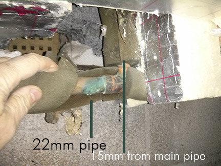

I have crawled about under floor and its One pipe(see photo)

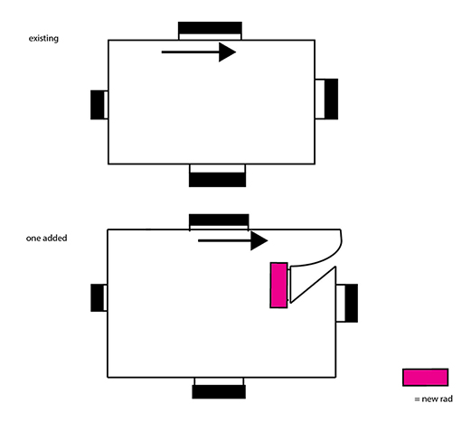

Here is a drawing...is this how i run pipe to one more rad?
There's no way that would work on a 1 pipe system unless it was literally in series with the main loop. You must have a 2 pipe.
