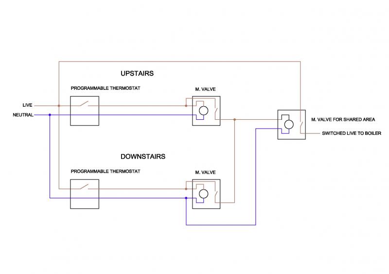

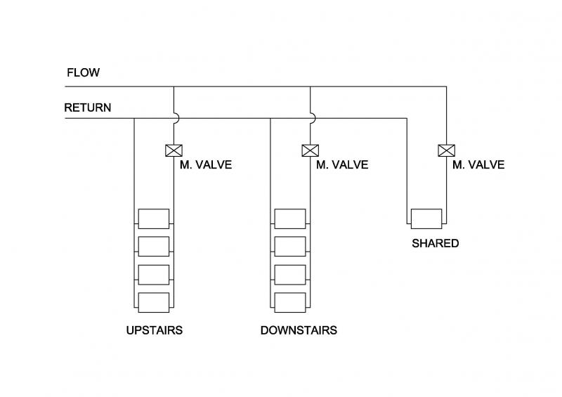

I did something similar here in the UK. The premises had a shop downstairs and a firm of architects upstairs, but they shared a common hallway & kitchen. Because the architects were closed at the weekend, and the shop was open at the weekend but closed one day in the week the landlord wanted individual control of the heating, but both companies needed to have the hallway and kitchen heated when they were in.
So I wired a relay across the motorised valves for the shop and architects office and used their contacts to switch a third motorised valve solely for the hallway and kitchen. That way if either the upstairs or downstairs heating was on the shared rooms came on also. It did mean that the shared radiators had to be plumbed as a separate zone as below.
The relays provided the isolation so that the downstairs heating didn't turn on the upstairs heating and vice versa. A separate wired thermostat also controlled the hallway.
If you are happy to dispense with a wired thermostat for the hallway and just have a thermostatic radiator valve, then the micro switches inside the the upstairs and downstairs motorised valves could be used to operate the hallway motorised valve, and the micro switch in that could control the boiler.
I've just noticed an error in my drawing above. The live supply to the upstairs and downstairs motorised valve micro-switch should be from the permanent live, not the switched live from the thermostats as shown. If wired as above, the live would be fed back from the one valve and keep the other valve motor energised even when the thermostat had opened.
Thanks for your reply. How do i get on with only rad on the circuit, can i then have a trv on it or not?
Yes you can, a TRV won't be a problem because in reality it will never really be 'on' on its own, because at least either the upstairs or downstairs radiators will be 'on' as well.

Then the radiator could be sized for the worst case and adopt the relay solution and then you can have a separate programmable thermostat for the stairwell motorised valve which will let you set different temperatures at different times.
If you really badly want to have this rad on with either or both of the other zones then you will need a valve for it and two relays.
Depending on exactly what you want to do then it might be possible to use other tactics but the simple one is as described.
