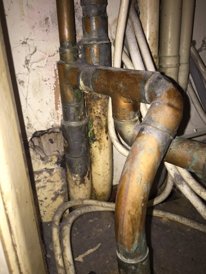

Recently moved into a new house. CH and DHW have been a bit noisy( air noises, sloshing sounds) so this evening I have set about bleeding some rads.
Bleeding one of them, initially a fast flow of air but this tailed off to nothing ( like when pressure drops to zero in a sealed system).
Now the boiler has gone into lockout after some knocks and bangs which I expect is not enough water.
I've been up into the loft and the header tank is full of murky water.
Is there any explanation other than a blocked feed pipe from the header tank? Any tips for clearing the blockage?

F/e is the 15 on the left, which is the return.
get yourself a strong magnet. The blockage is likely to be black iron oxide, which is attracted to magnets, possibly hardened with limescale.
Hold the magnet to the copper pipe. Most likely any blockage will be where the F&E pipe tees onto the main pipework. Sometimes it is possible to open a joint and poke it with a wire shirthanger, if you don't mind hard lumps circulating round your pipes. Normal practice is to identify and cut out the section of pipe and replace with new.
Having cleared the blockage, fit a system filter and do at least a chemical clean which will reduce the risk of it happening again, and will remove some sludge and sediment.

I managed to back fill the system via a hose pipe on a drain cock, until water was coming out of the vent pipe. There is still a lot of air in the system, but there is more water than the other day, and it's got me back running.
A magnet sticks to the reducing tee shown in the photo above.
I am suspecting that the blockage is also impeding the flow around the main loop as well. It took quite a lot of fiddling to get the pump wet and start pumping.
No lockout since though, so there is obviously enough water in the boiler.
