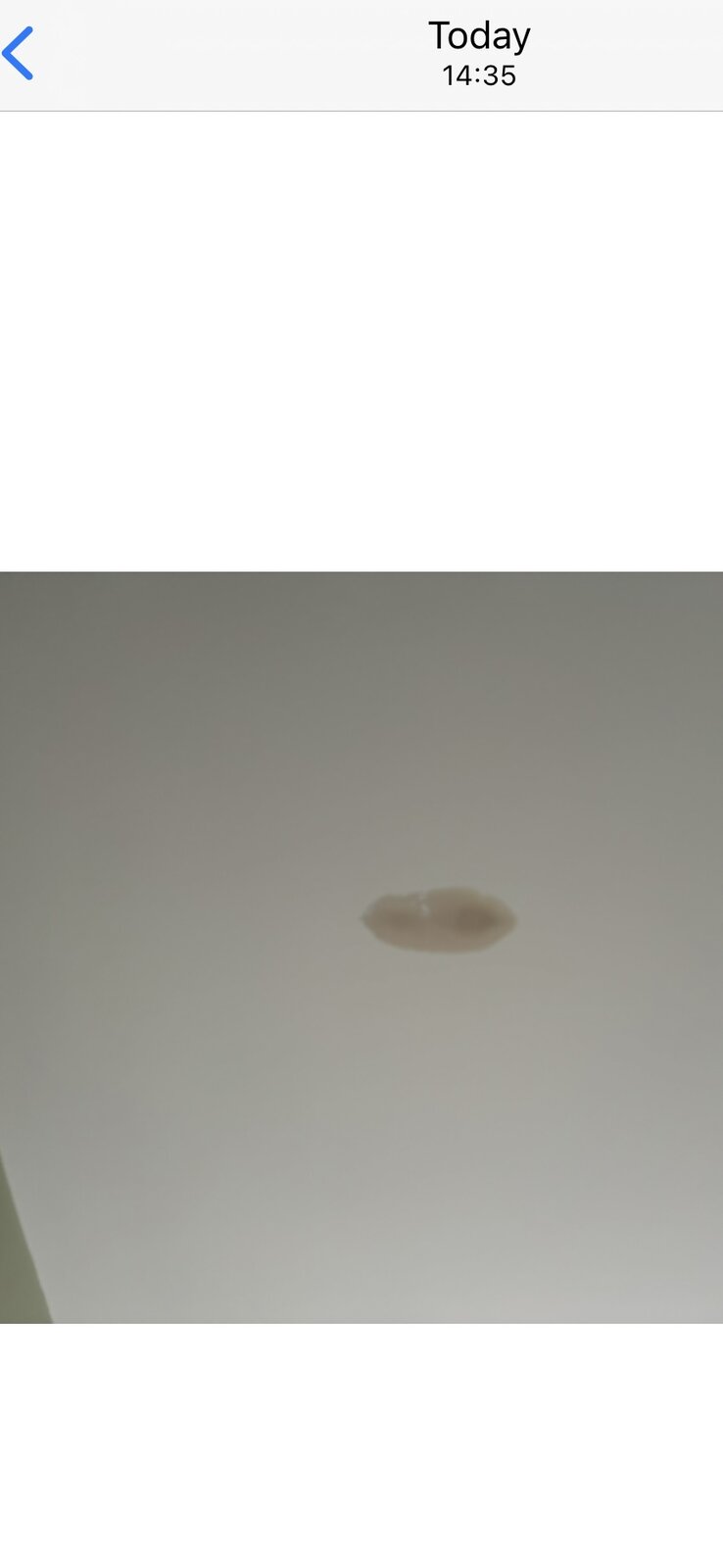

I am looking for some advice please on my ceiling leak which appeared today.
I have a standard open vent system in my home and today noticed a nasty brown stain on the ceiling directly below the F&E tank and some pipework. Its quite small 5cmx2cm but appeared when neither CH or HW on. I've outlined it in pencil.

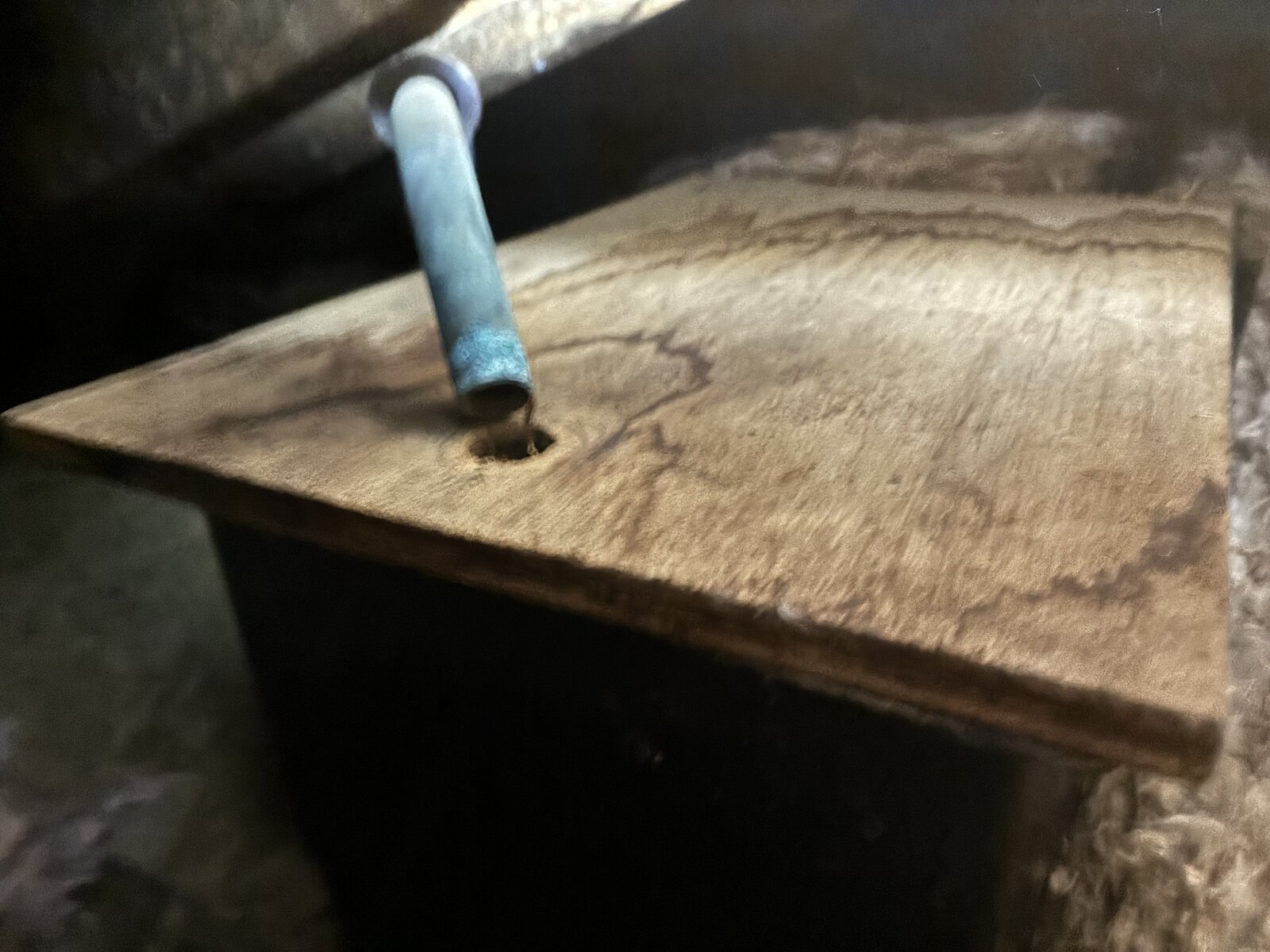

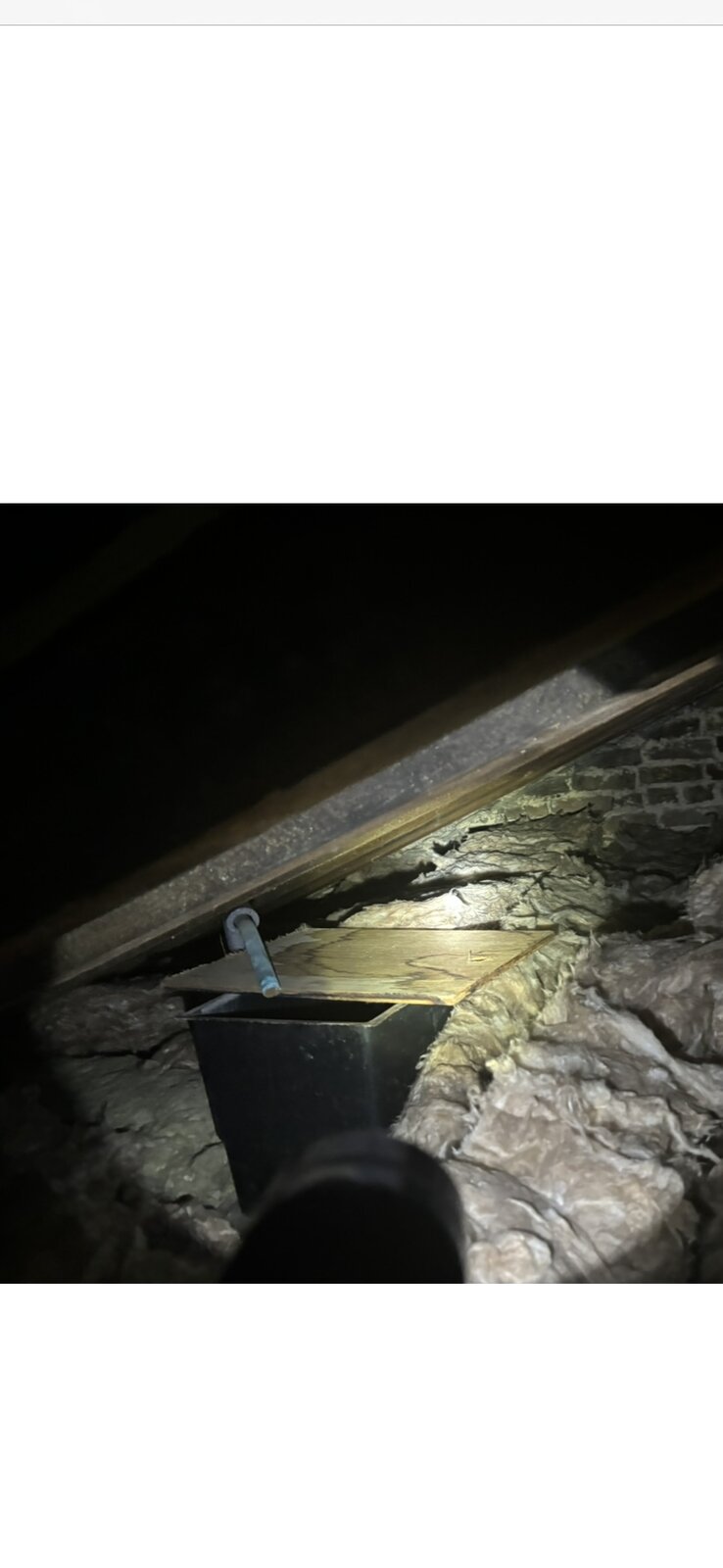

I got up into the loft space to see what corresponds to today's new stain and its give-or-take pretty much by the header tank which had a plywood lid put on in spring 2023. That plywood has evidence of water staining and the hole for the vent pipe is a bit small (IMHO) to line up well so I have moved that sideways to ensure any pumping over gets into the tank!
So my question is - do you think that my demand for CH while all rads were off was enough for system to pump into F&E and the overspill is just coming through now via thick insulation, tile offcuts etc and now showing on the ceiling.... ? Can I wait for a few days before rushing to call a plumber to see what the stain does from here or should I just get on with paying for someone to come out? Is it just wishful hoping that its last week's misadventure showing through and that just isn't possible?

I can't work out how this maps above ceiling exactly with joists etc but its right in middle of ceiling and approx distance from loft hatch as measured.
I am hoping it was an return via vent pipe overspill due to lid that took some time to work through ceiling?. I've moved the lid cover sideways for now

Certainly judging by the water staining on that board covering the cistern, it seems to have been pumping over at some point.
The vent pipe needs to be properly installed so it sits into the cistern through the lid. I agree with Madrabs observation ,the system appears to have been pumping over ,and likely the source of the leakage onto ceiling
Thank you both, I have moved the board round and can keep an eye on it without rushing into things. If ceiling stain gets bigger, there might be more to it - but it doesn't sound too urgent for now. I'll have the pipe/cover sorted during upcoming boiler service (august).

Your vent pipe needs to be unobstructed, and pointing inside the f&e tank, next time you put heating on, go have a look in your loft and watch what happens.
Is the pumping over an issue in itself
Yes - pumping over can increase corrosion in the system - it can also be indicative of a restricted cold feed or an incorrect pump setting. If it is then it should be investigated.

When I got into loft space I did see some water come through that vent pipe. Not much - a couple of tablespoons (twice when I was watching) and not under pressure. I mean like a flow not an exhaust splutter. So I guess the ceiling won't fall in but I should get a plumber to sort out why its pumping water through vent pipe....
