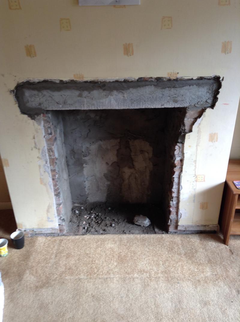

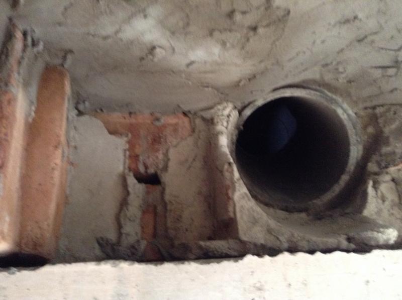

Well i cracked on today helping a friend open up the fireplace.

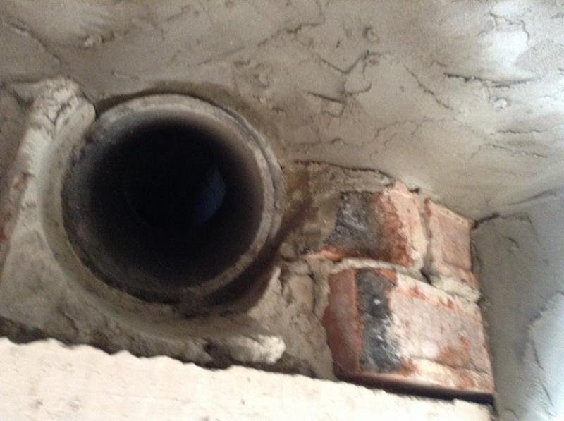

Turns out that it was brick and mortar infill behind the concrete flue. It is a lightweight concrete (not exactly pumice) that may not need lined. It seems pretty solidly held in so not sure if the infill needs additional support?
Next step is the hearth and figuring out exactly what to do with the liner/not liner situation. The guy who swept it certified it as a class 1 chimney and said dont bother. Every hetas guy i have spoken to would line so??
Any thoughts appreciated
Graeme
The infill round the concrete flue.
It's bricks and mortar shown in pics but not like a proper wall.
Think it's worth putting some support under it or just leaving as is?
If you are going through BC they may want a lintel to support the liners. Although the mortar round the liners will probably hold them in place, if there is any movement you could get damage to the joints.

How would you support the concrete cylinders without obstructing or piercing them? Best I can think of is a steel sheet with a hole cut in it and mounted on angle brackets or similar
Bit like a register plate I guess
Graeme
You might need to check with the BCO about the steel, as a register plate isn't really structural, but he may accept it. Other option is a concrete raft lintel.
Looks like it will need to be a raft to make sure they have no quibbles when BC inspect it.

You need to get the flue to sit on top of the raft lintel, rather than the flue pipe sticking through it. The hole needs to allow for the fitting of a stove pipe adapter.
