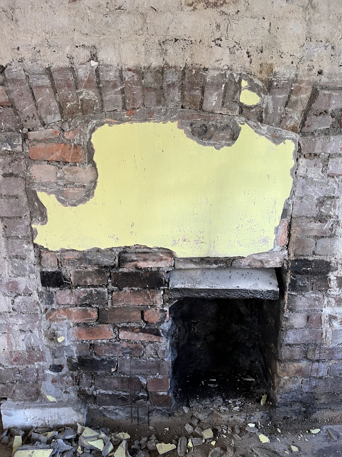

As in the title. On both sides of the fireplace, the inside seems to be constructed of different bricks compared to the outside - the outside seems older / original. Is it a fair assessment to say that the interior bricks were added to reduce the size of the opening or am i on the wrong track?
View media item 82667
This pic shows one side of an iron lintel (?) overlapping the 'new' brickwork by a few cm.
View media item 82668
I will be removing the plaster from the rest of the fireplace - just guesswork but if I reveal an arch higher up that reaches to each side of the 'original' brickwork, can everything from the lintel up to the arch be removed safely?
I would like to use the inside as storage therefore more space in there would be really useful.
You are probably correct in that you will meet a brick arch a little higher up the face of the c/b. Carefully, knock off plaster for about another 300mm and it might be revealed.
You can remove the later infill brickwork to reveal the original width opening.
The flue must be swept and an air vent inserted below, with an air vent terminal on the stack.
Save the front returns of skirting, they can later be cut to length - they are already mitred.

Thanks Ree, some good tips there.
The whole room needs reskimming, so the plan is to open the fireplace up up, put some under-floor ventilation through the hearth, then box it in (including the chimney vent) and skim.
Or if we're brave enough we will get the room done in lime plaster as I understand this will help for the damp issues.

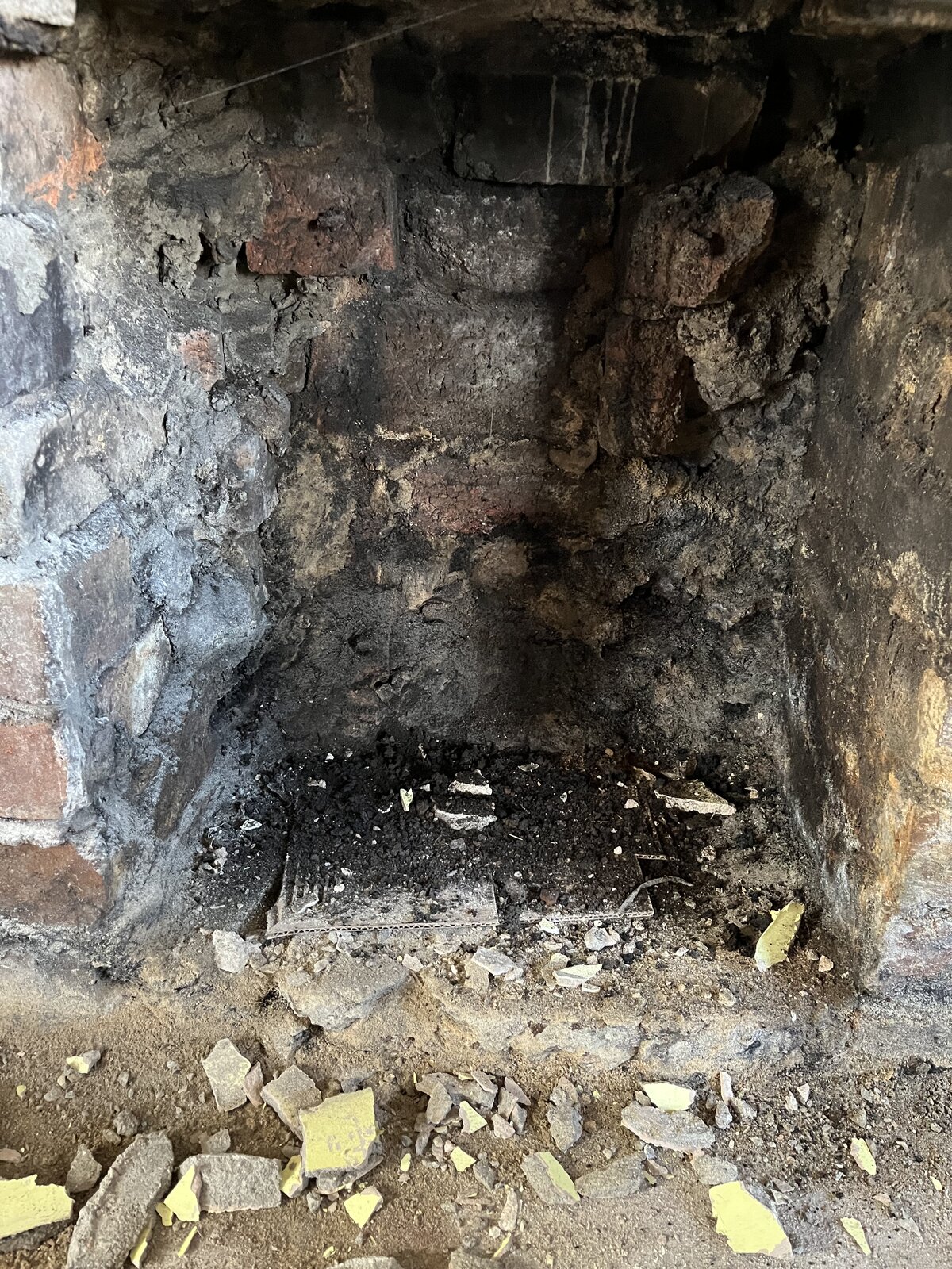

Have now got around to having another look at the fireplace, hacking away some of the plaster.
Interestingly it looks like the original bricks forming the cheeks have been nipped away to add the newer(?) internal brickwork. e.g. You can see on the LHS of the picture that the new brickwork is tucked in at the bottom (floor level) and top (metal lintel level). The new cheeks are built on footings of what looks like crumbly concrete, whereas the 'originals' brickwork continues into the ground level.
When I started poking away in the ground, one of the bricks just fell away from the bottom of the right hand 'new' cheek:
View media item 84419
I'm wondering if anyone has any ideas whether:
These are actually 'new' and 'old' bits, or are they all original?
Are the 'new' cheeks required structurally? (given the nipping away of the originals) - can they be removed up to the arch?

When re-rendering, use sand and lime render, dont use any gypsum plaster.
Before re-rendering, remove the remaining skirting, and knock off plaster on both cheeks to an 800mm height. What condition is the main wall skirting and plaster in?
Pic 2. shows heavy soot in the flue - a c/sweep can remove this with a wire flail. It must be removed.
Pic 3. you can safely remove all the later in-fill brickwork up to the arch.

Yes, simply knock out the bricks, carefully slide/prise the steel lintel out, and drop the upper bricks below the arch. If the arch bricks seem loose then rake out and point up before moving the bricks below.
