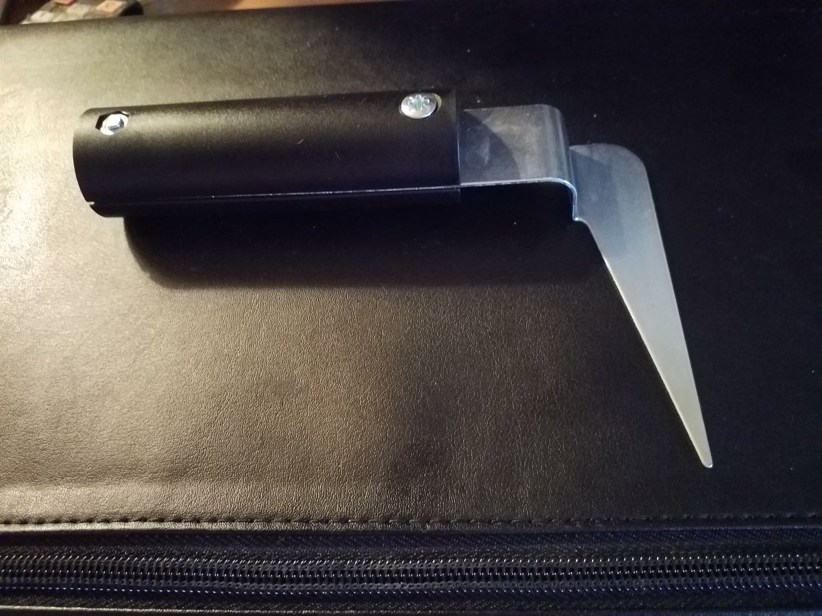

You'll need to remove the glass which allows the opener to twist more otherwise the glass WILL break, open the handle and push outwards on the corner of the end that isn't jammed, you'll need to push out till you can see daylight through the gap, at the same time you need a thin rigid scraper/putty knife or wallpaper type scraper pushed in the other end to lever the sash along with the shootbolt out of its frame keep, I use one of these though to manipulate the mechanism over but you won't have one as its a locksmiths tool and about £30
Ohhh thats a shiny funky tool, Whats it called?
I love new tools to play with :)
Get from NWH, not in their catalogue though for obvious reasons, made by souber tools if you want to contact them also, I use it in conjunction with a pump up bag, jobs a good un!
